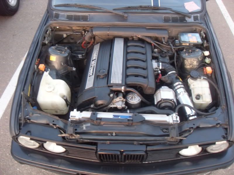

            May 22nd, 2011
            It has been a while since I have updated this thread!!
            Well here are some shots before Bimmerfest, and at Bimmerfest.
            Not a lot has changed, and as of right now a major and much needed exhaust overhaul is in order. But other than that not much has changed. I am itching for some worthwhile updates though, so stay posted!

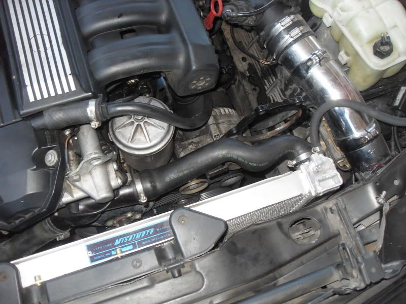

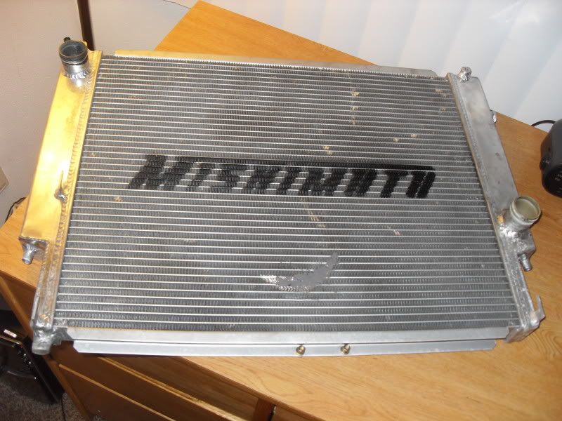

                    So after a year of driving the E30 after the S52 swap, probably around 12000 miles, I am returning home to San Diego from Phoenix. I hear a slight whining noise and I pull over. Pop the hood on the side of the freeway and notice my engine crank pulley is kissing my beautiful Mishimoto radiator, and the bitch has sprung a leak!

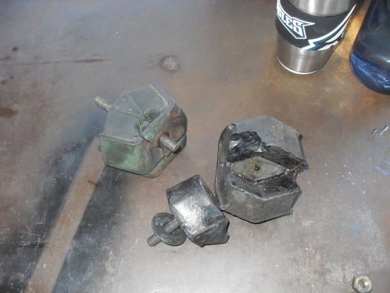

                    I was trying to figure out how this was possible until I looked at teh drivers side more closely and noticed the motor mount had SHEARED IN HALF!!!
                    Now I know its been a long time since I updated this thread, but this is not how I wanted to do it.
                    Thankfully the radiator just has a small hole in it, and it will be very easy to repair.
                    Just ordered the below motor mounts, that are designed for S5x swaps into E30's, so hopefully I wont ever have to deal with this again.

                        Finally an update with some pics. Too bad it isnt anything cool, just regular maintenance that I have to do from parts failing on me.

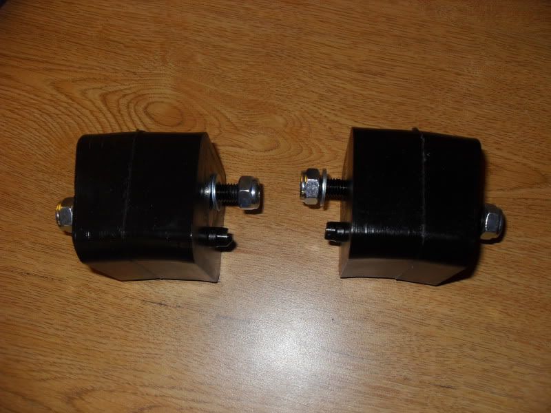

                        So I bought these 200 dollar AKG E30 with M/Sx swap mounts. They dont look to bad and they feel really solid. Which I like. Though after installing them there is a lot more NVH from the engine, especially when the car is starting from 0, but I guess it will be something I have to get used to.
                        Quick patch of the Mishimoto with some JB weld until the new one comes in. Looking for someone who can weld it professionally so I can throw it in my M3.

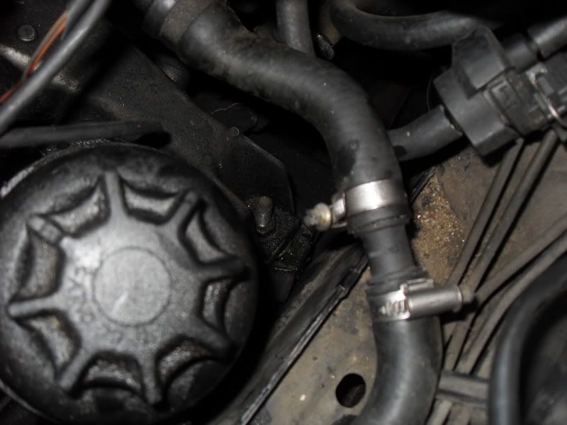

                        This view is what got me curious as to what was wrong. Hint - look at the upper radiator hose!
                        And a motor mount shot.
                        And the failed M5 crap. They did last about 2.5 years though, but its the first time I have ever seen anything like this happen. Oh well. One must pay if he wishes to play with the bigger boys.
                        All in all it only took an hour to swap these suckers out. Too bad AKG didnt give you a hint to their orientation, and even properly installed they are still off by a smidge, but they look and feel a lot better than the M5 mounts most people use.
                        If you are going to do a 24v swap and you have the extra cash, grab these mounts instead of the M5 mounts.

                          Holy jeebus... Those mounts got wasted.

                            Would like to know how much of the stud is sticking out after you bolt the engine mount arms down. I don't feel comfortable with the amount I have on mine. Nothing bad has happened yet but I don't think they are correct. I asked them about this and he asked me to email him a photo. Just haven't got around to it yet.
                            People need to stop recommending those green mounts for 24v swaps. Seen too many of them do that.
