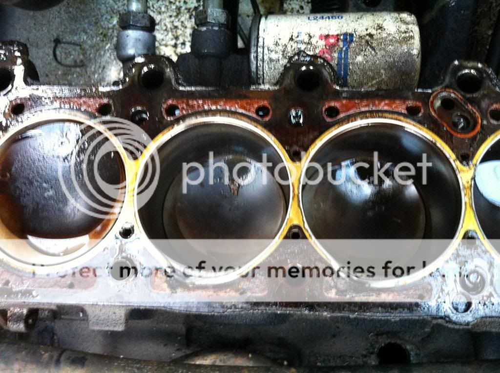

                      A few updates. I pressed in my new ball joints, replaced the 15mm spacers with 20mm ones in the front, and had forced firebird (john@wottech) redo the tune. Also had the blow off valve welded on a few weeks ago :)
                      Here's some pics over the last few months :p
                      It started with the popped radiator hose
                      Then after changing that and starting the car up, I found that it didn't want to stay running and was pouring white smoke out of the exhaust. So it was time for a compression test. After doing the test I found that my hg was blown. :/
                      DIY exhaust gaskets didnt last long lol
                      So I ordered a top end gasket set along with a few other misc things like oil thermostat rebuild kit from WOT-Tech
                      Had the head machined/hot tanked
                      New injector O-rings
                      Oil thermostat resealed
                      New turbo mani gaskets
                      New everything gaskets:roll:
                      Coming together
                      Bought this volvo->t3 transition flange to help everything seal properly.
                      New Gotez headgasket on the block after cleaning the block
                      Head in the car
                      Just about finished!
                      Had the BOV flange welded onto the charge pipe
                      Got the new Condor shift knob. Love this thing:pimp:
                      MLS wastegate delete gasket along with a 1/2" plate. Much better than my 1/4" homemade plate with a DIY exhaust gasket. It's a 38mm delete, so I had to hog the holes out a lil bit
                      Took a bath
                      Took a trip

                        Replaced the front 15mm spacers with 20's
                        Also, I think I said it before, but I had John & Gerson @WOT-Tech retune the car. 8psi on 93, so lower but better

                          How much did you pay for a resurface and hot tanked?

                              #404
                              $150, they charged a little more because they had to spend a decent amount of time trying to remove the rocker tubes.

                                #405
                                That's a pretty good deal people around here were trying to charge me 400-700 to do that
