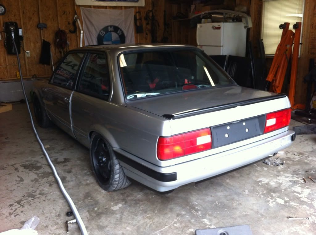

My M60 318is.
  • dirty30
    • 3090
    #136
    Originally posted by Hans Gruber

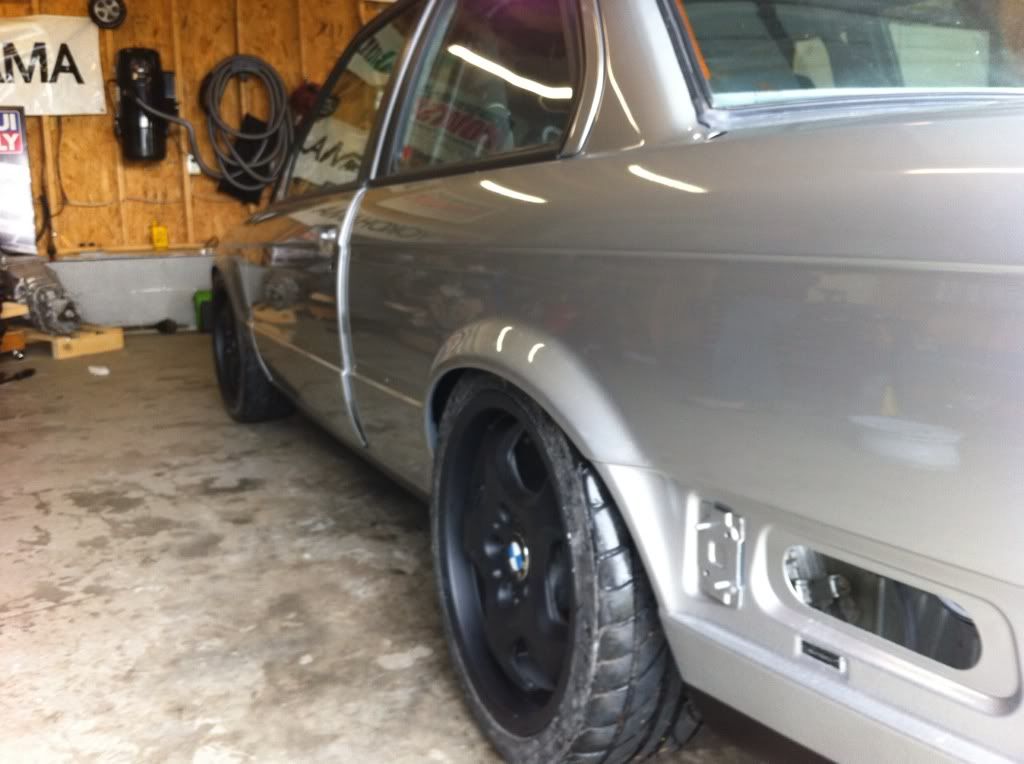

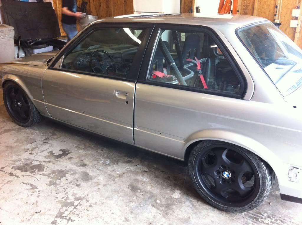

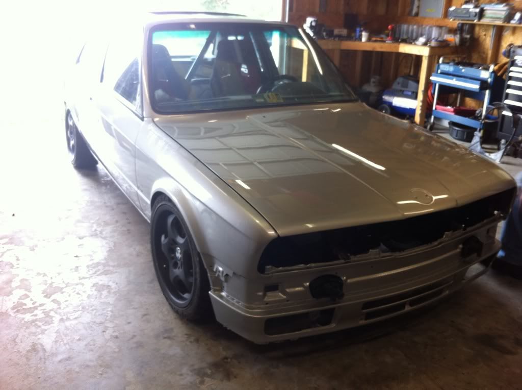

    Great look with these wheels. Did you use a spacer to get them flush? I belive they're 16x7 et20?
    No spacer and I think they are 16x7 et 20. The Hankook R compounds on those wheels are really wide for a 205/50/16.... more like a 225/45/16 street tire.

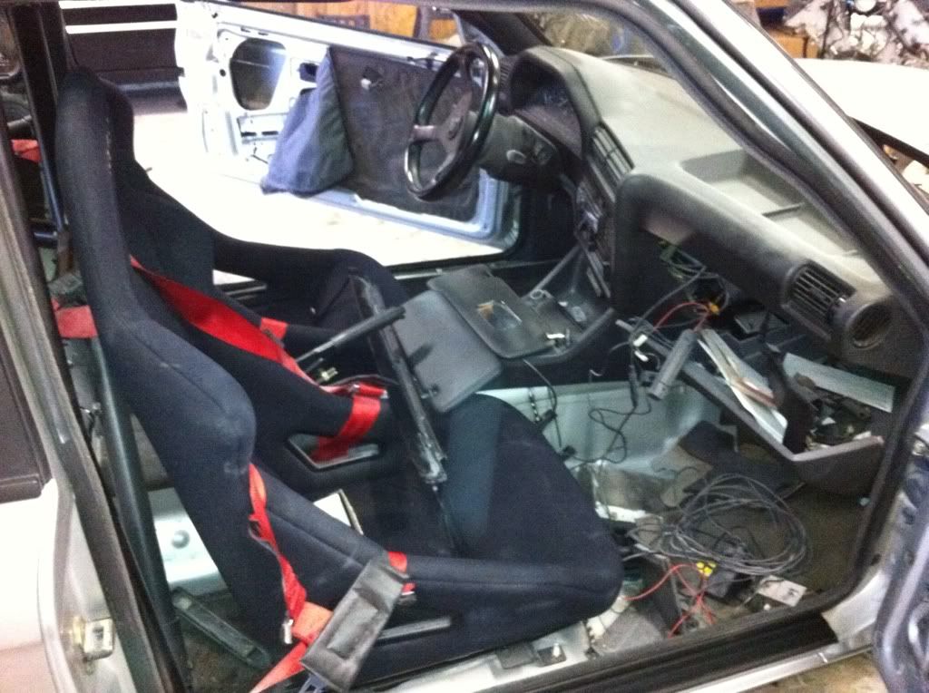

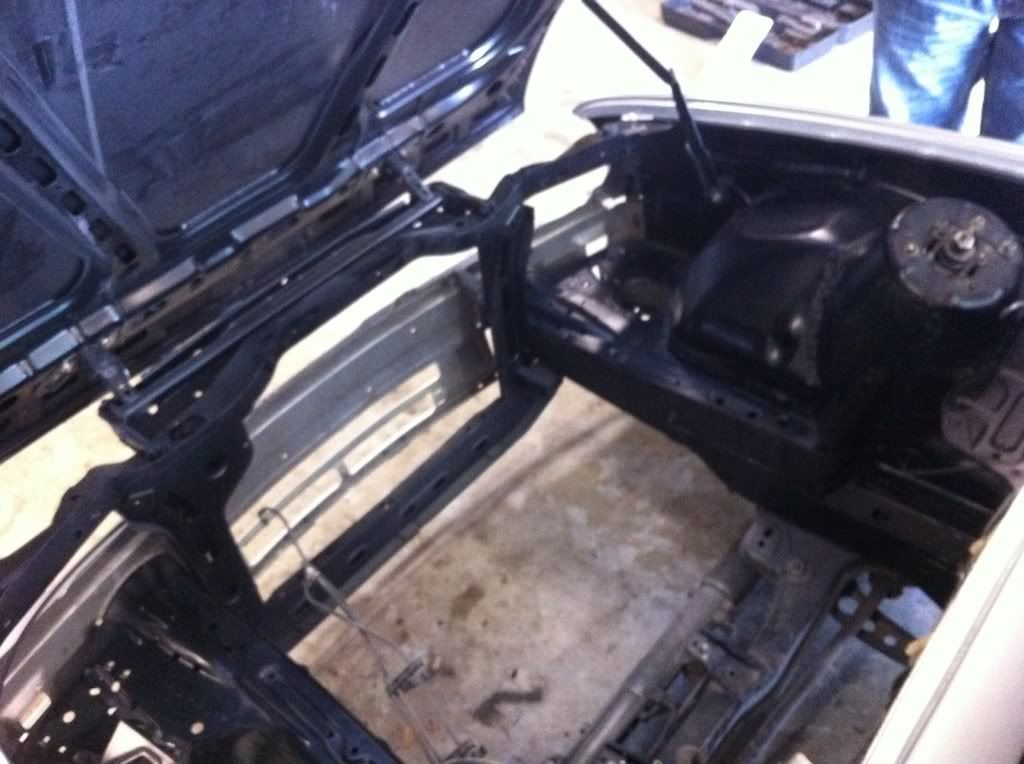

      Finally got the car back home and got right down to business. Everything in the pictures is bolted on for good. Going to start in the rear and work my way forward.
      A whole lot of work has to be done here!!

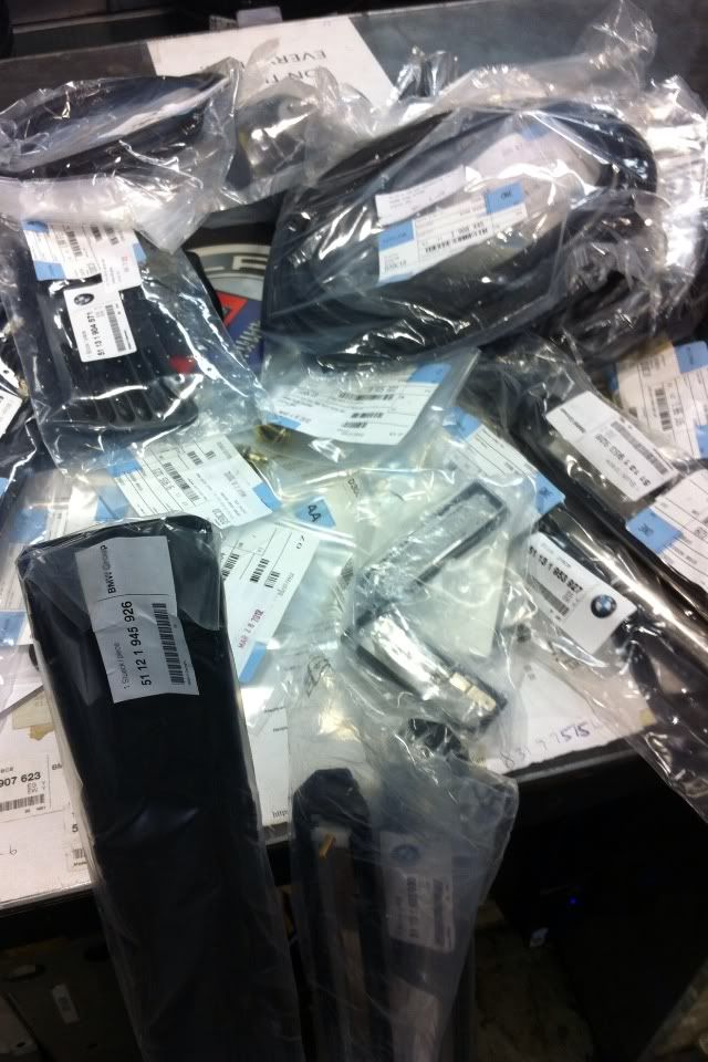

          Made a large order at the dealer today. New body side mouldings, cowl vents, rear center moulding, misc. hardware, E34 motor mounts, 540 clutch and some other stuff. Should have a test fit of the engine this weekend.

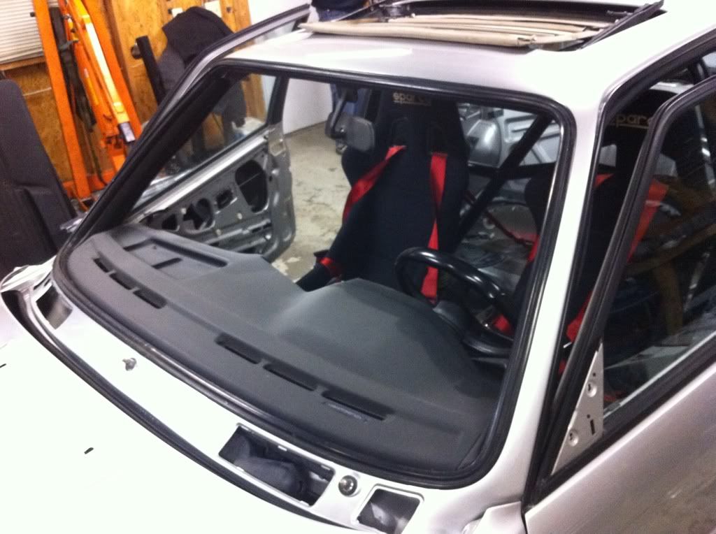

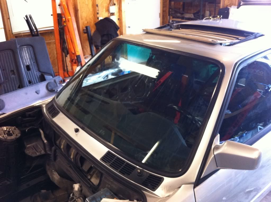

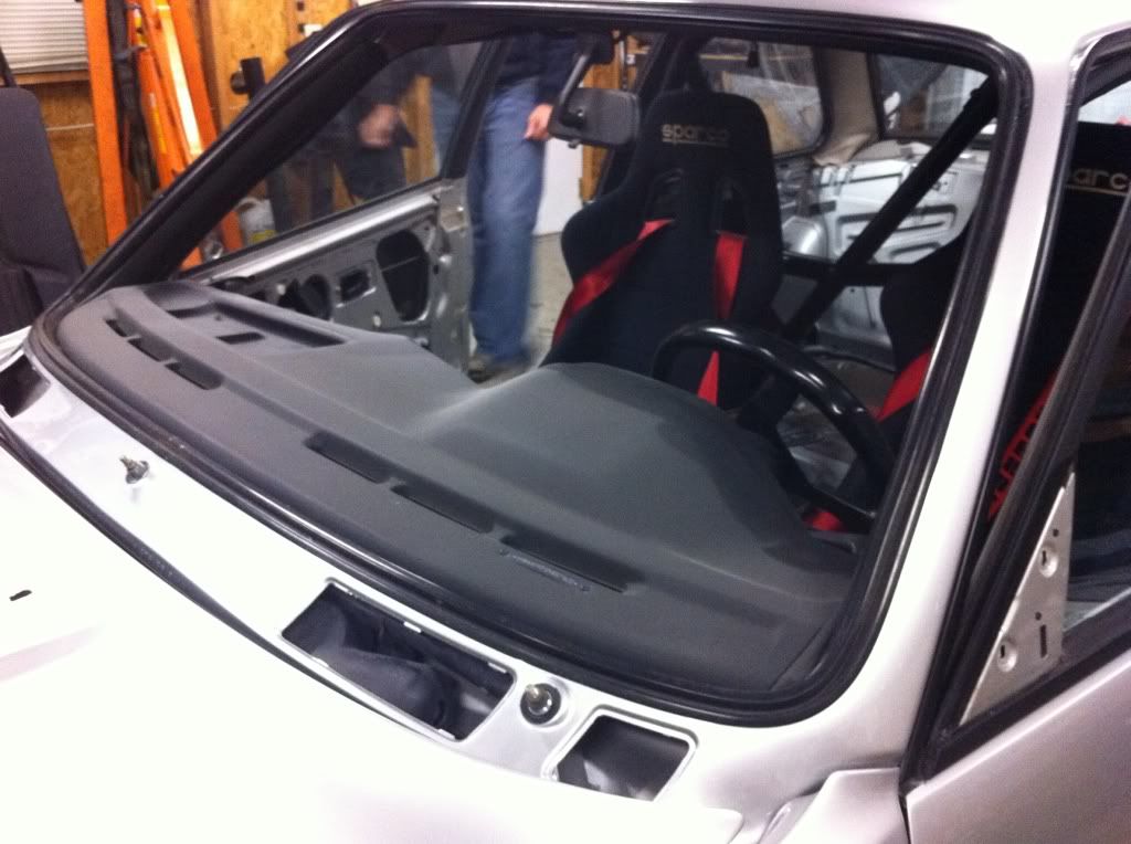

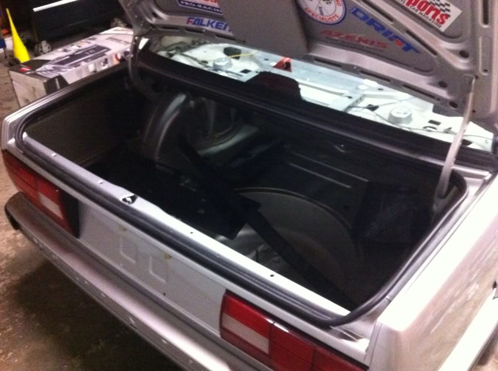

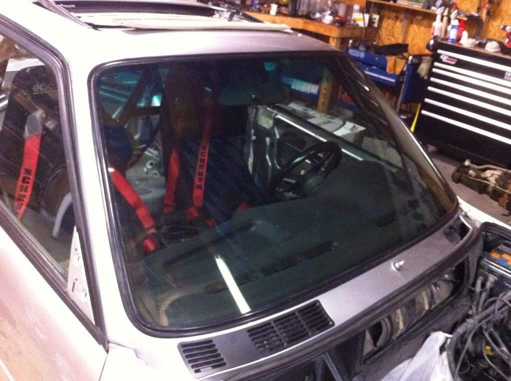

                Pulled the cracked windshield out
                Dropped the new glass in
                Put the new trunk seal and lower lock strip on

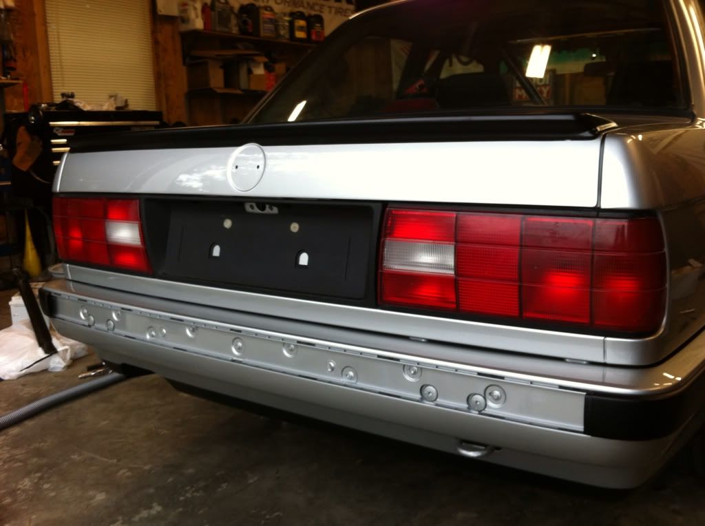

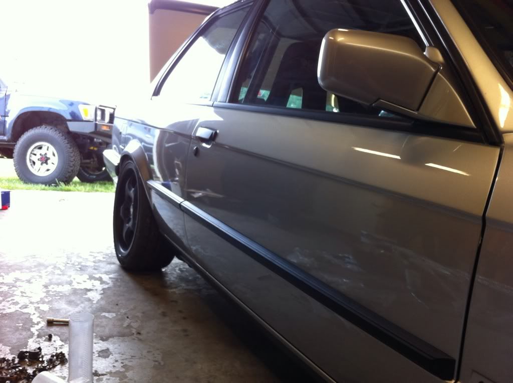

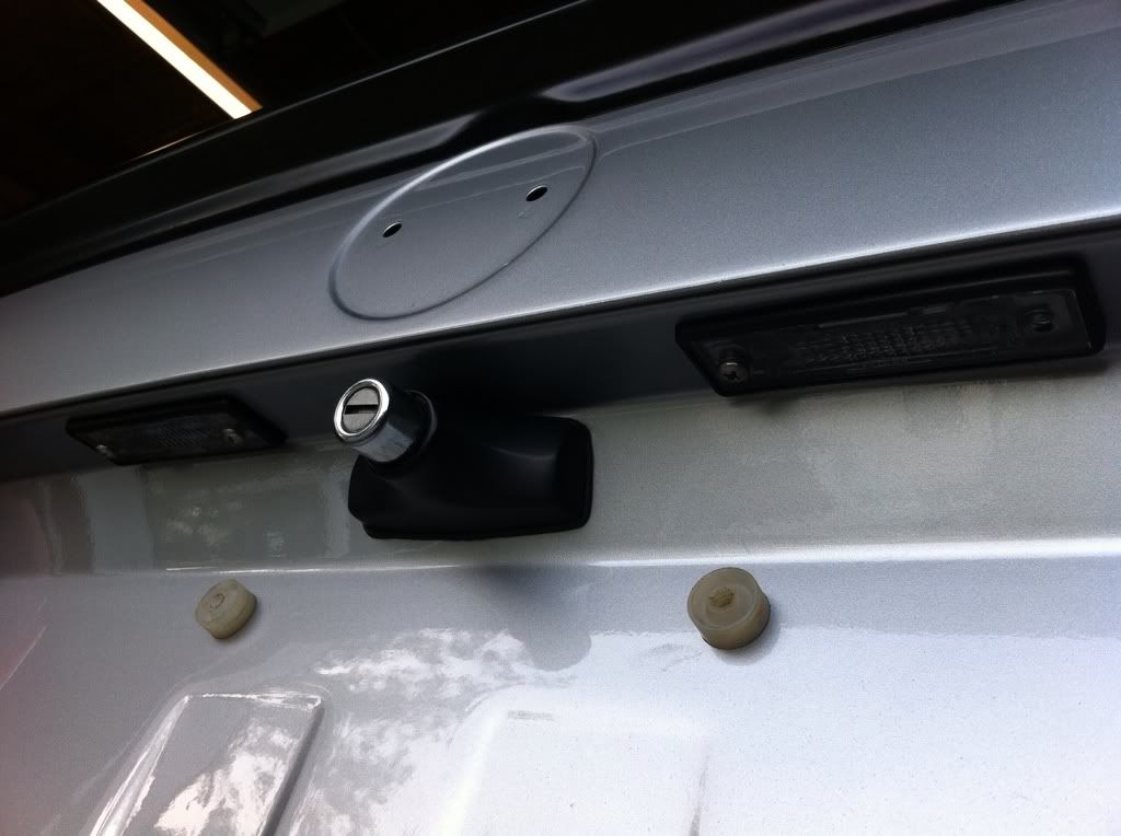

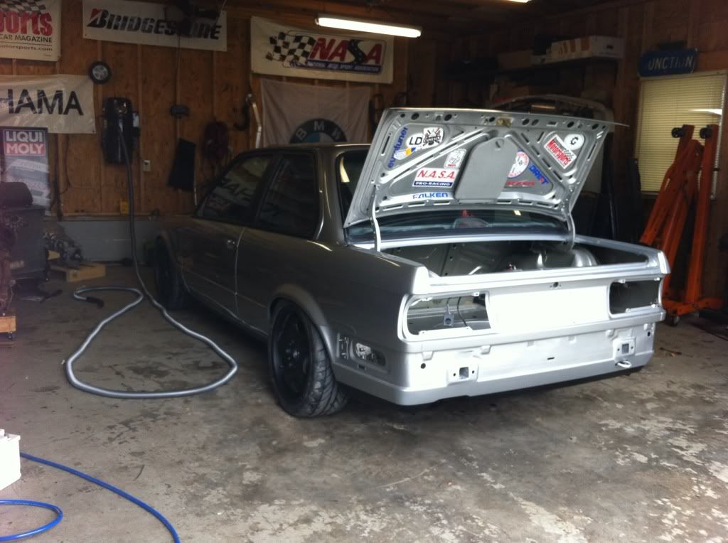

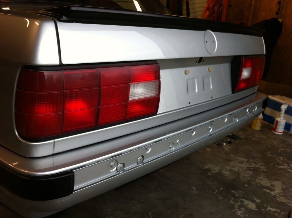

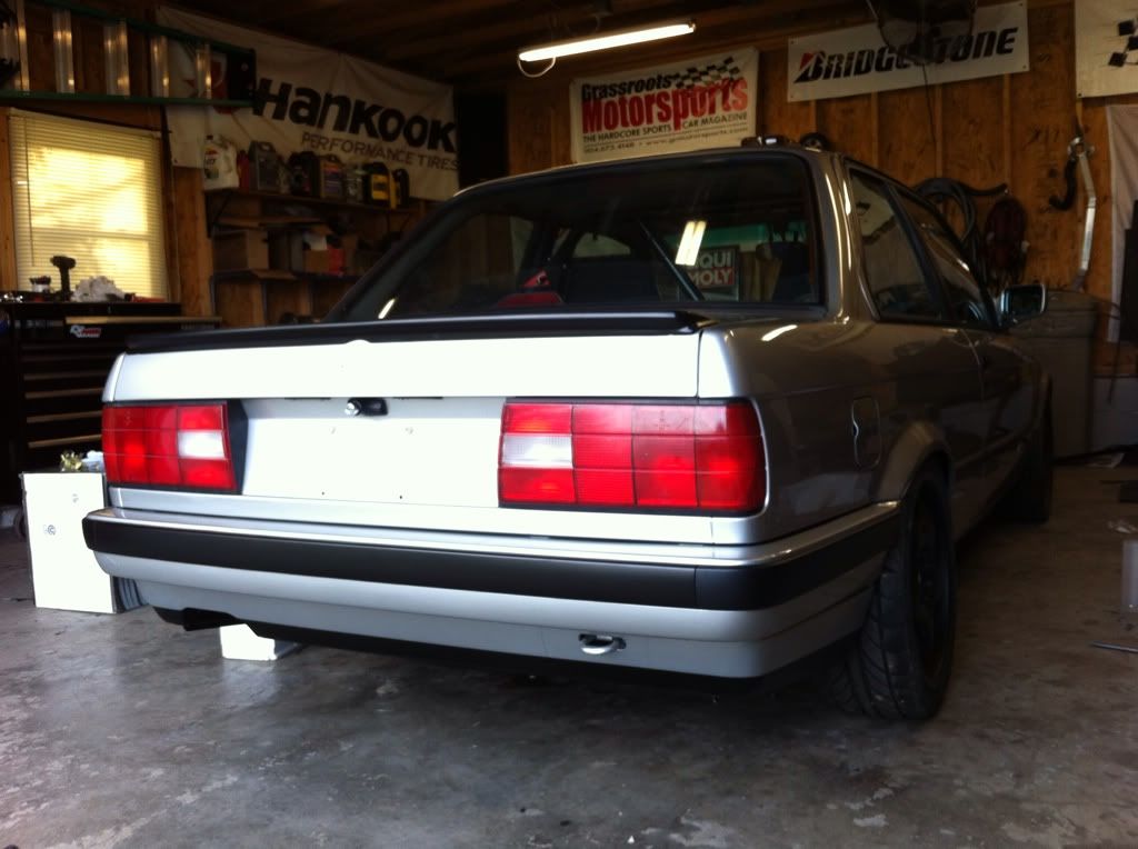

                    Woke up this morning and put a timing belt and water pump on my 4runner then got back to work on the 318.
                    Finished the lock strips and got the side view mirrors back on
                    New side moldings on
                    Truck lock and new tag lights
                    The rear is done.

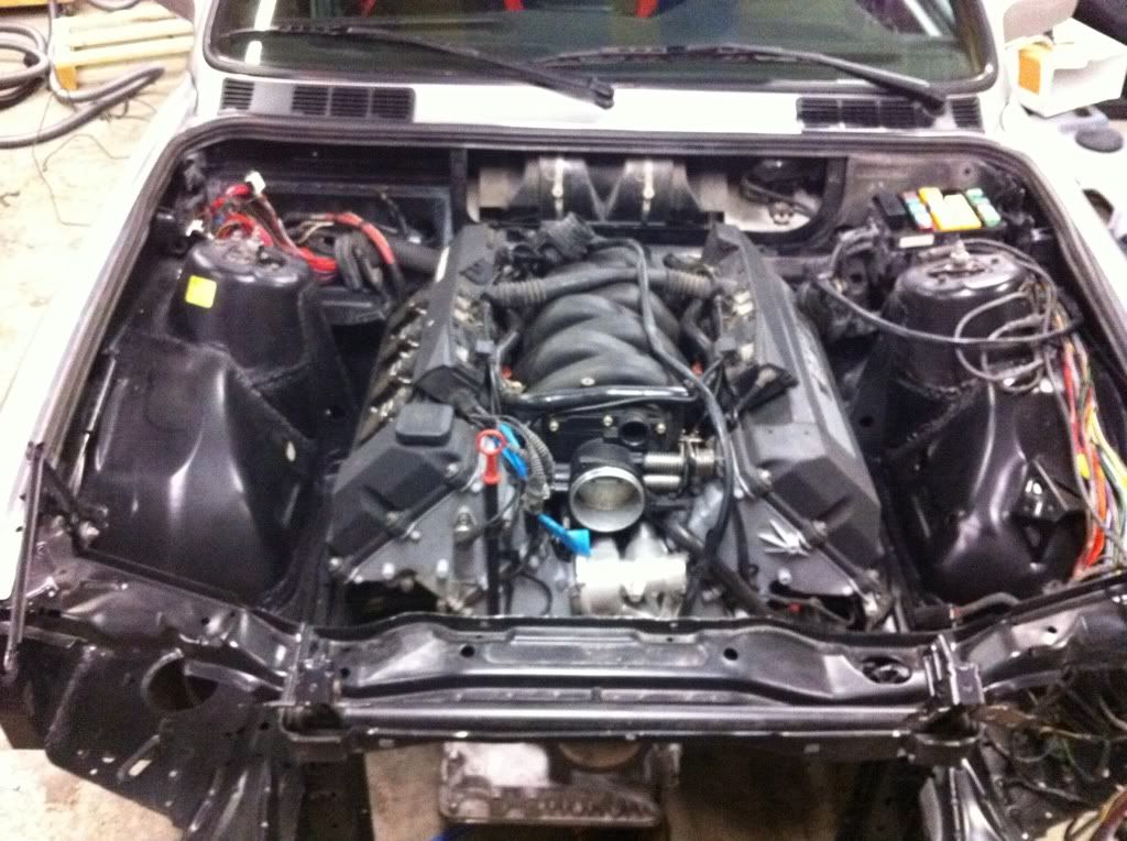

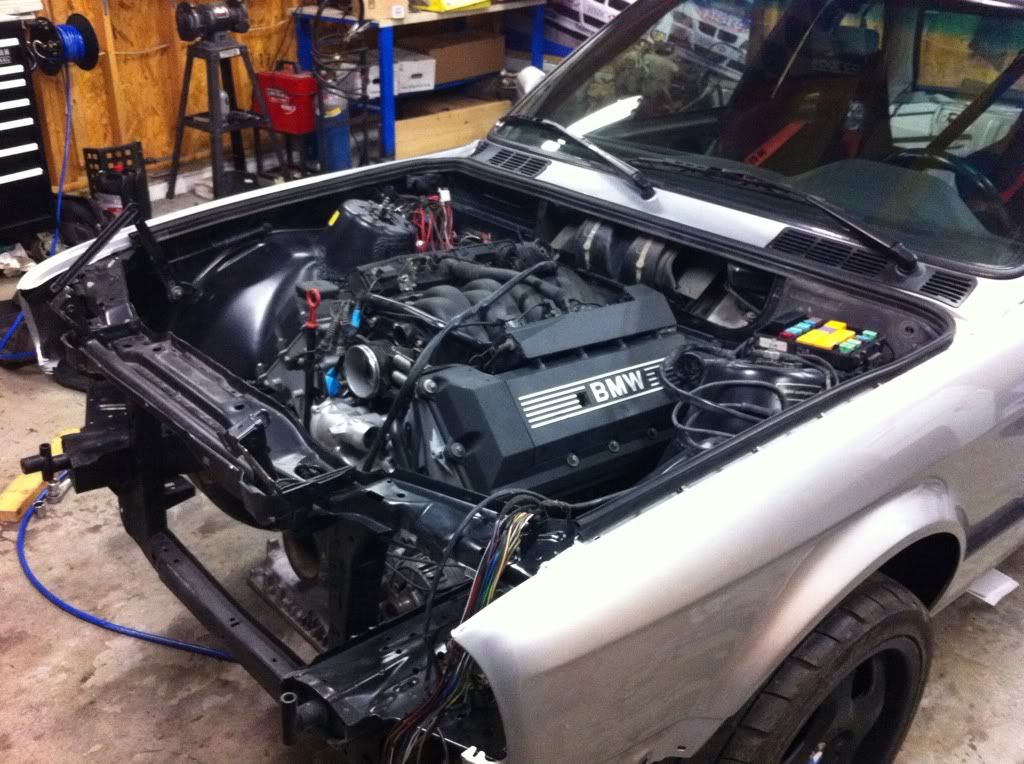

                        Me and my girlfriend shoehorned the M60 in tonight. It's a hell of a squeeze without a leveler on the hoist but we got it!

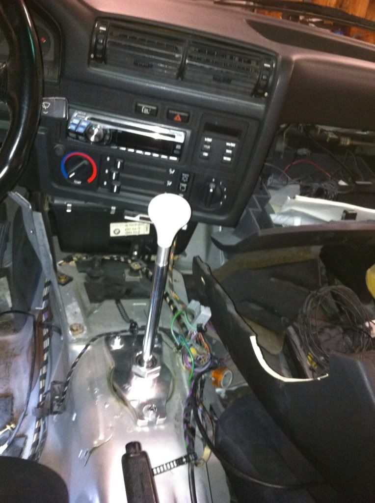

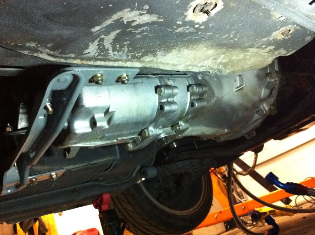

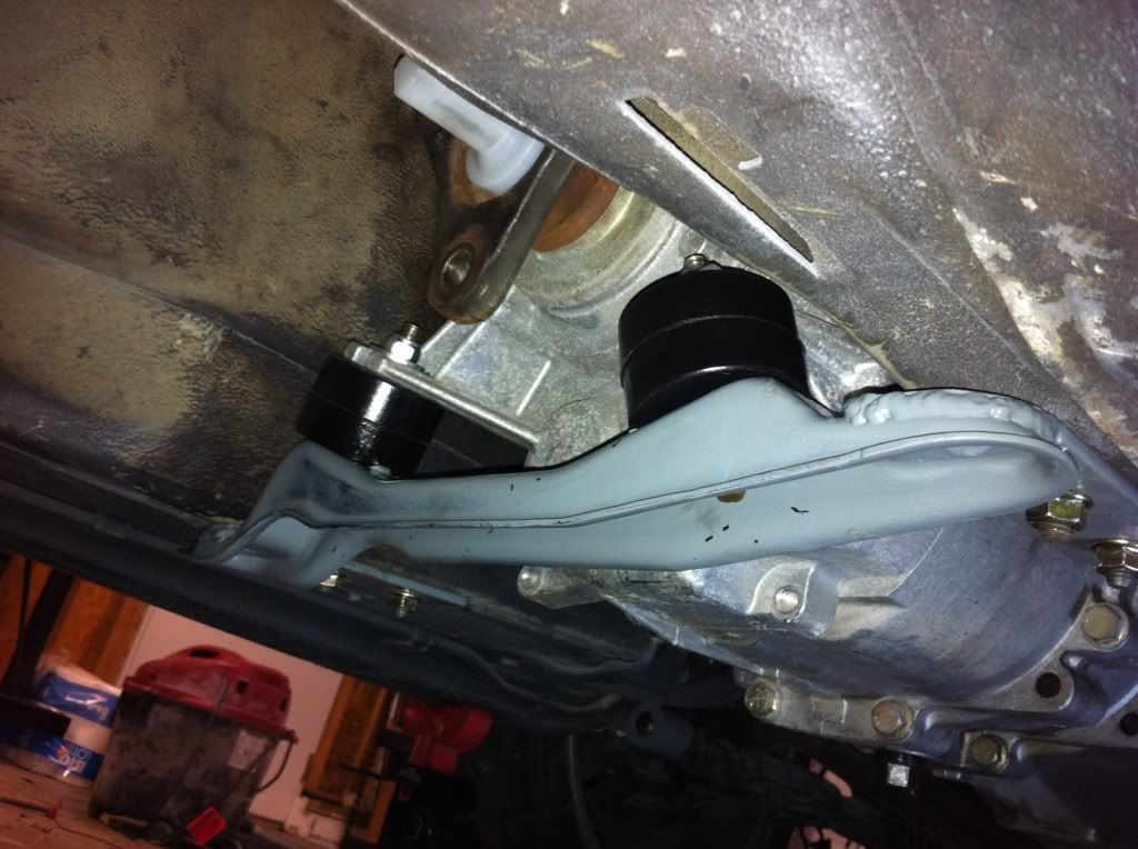

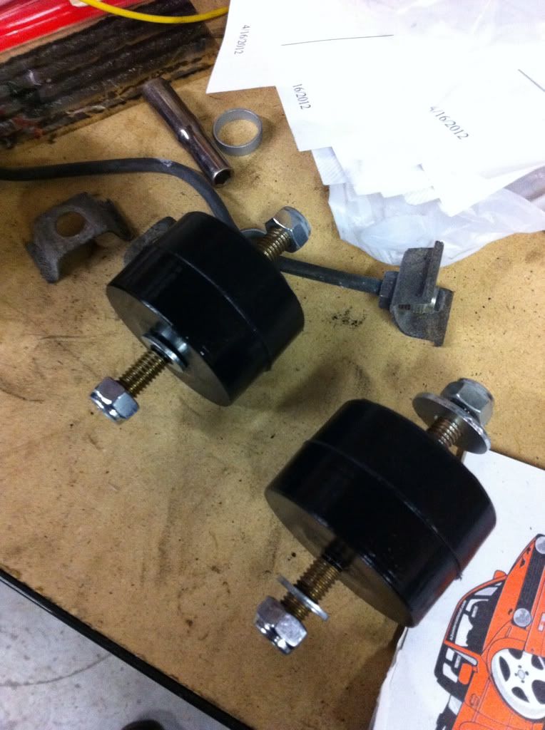

                          My order from AKG arrived today...
                          Played around with mounting the shifter
                          Group N trans mounts
                          • dnick
                            • Apr 2011
                            • 1377
                            #148
                            lookin good! your going to love the shifter :) pair it with a dssr and it feels amazing. subd!

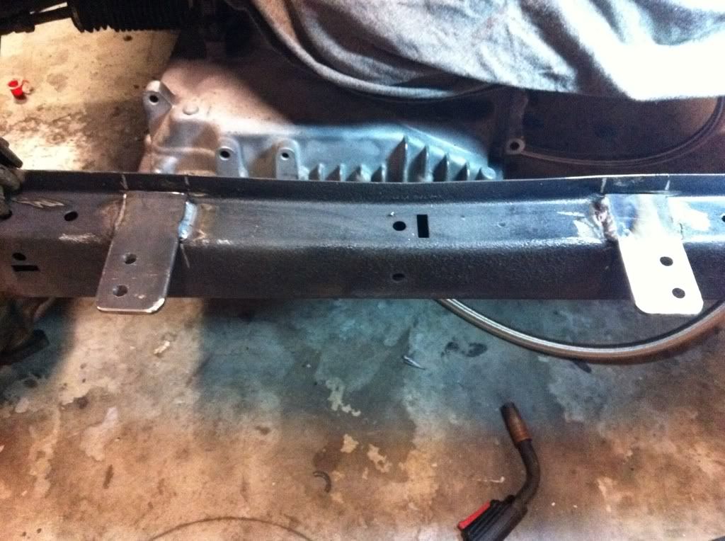

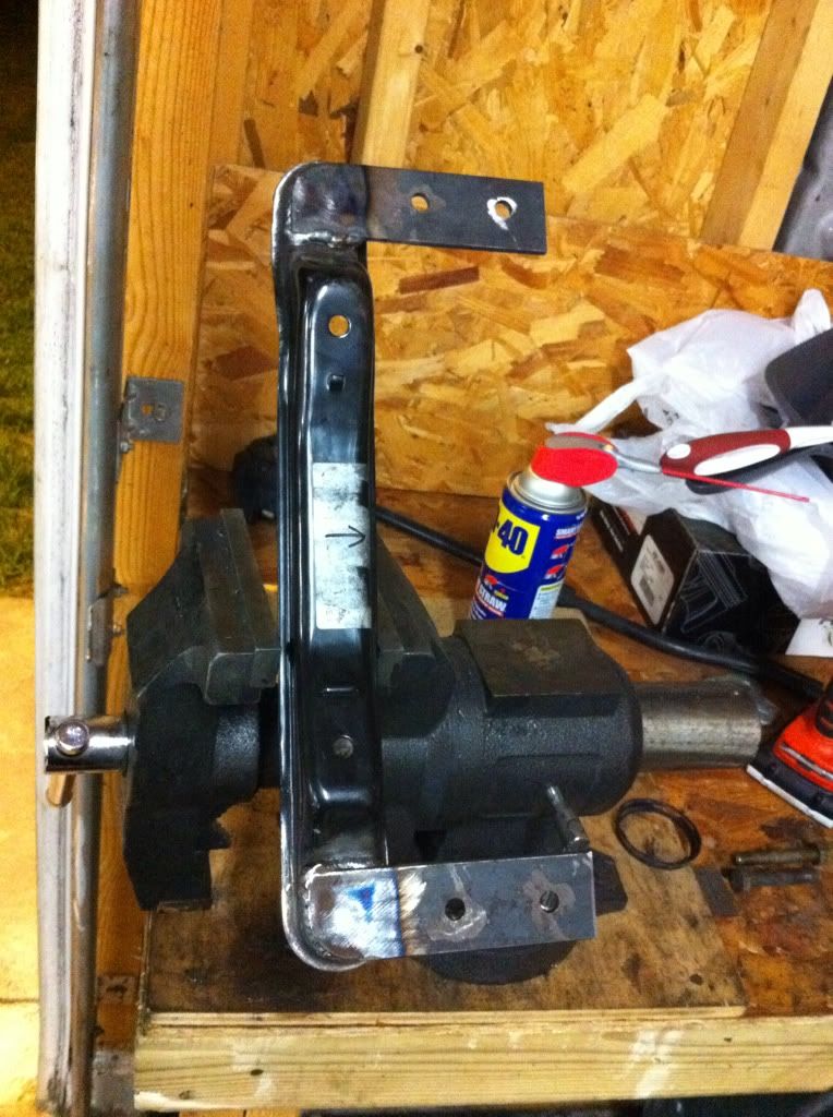

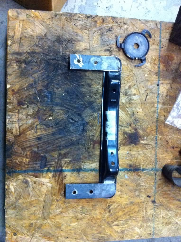

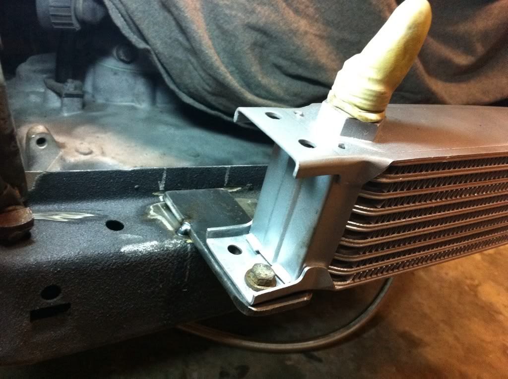

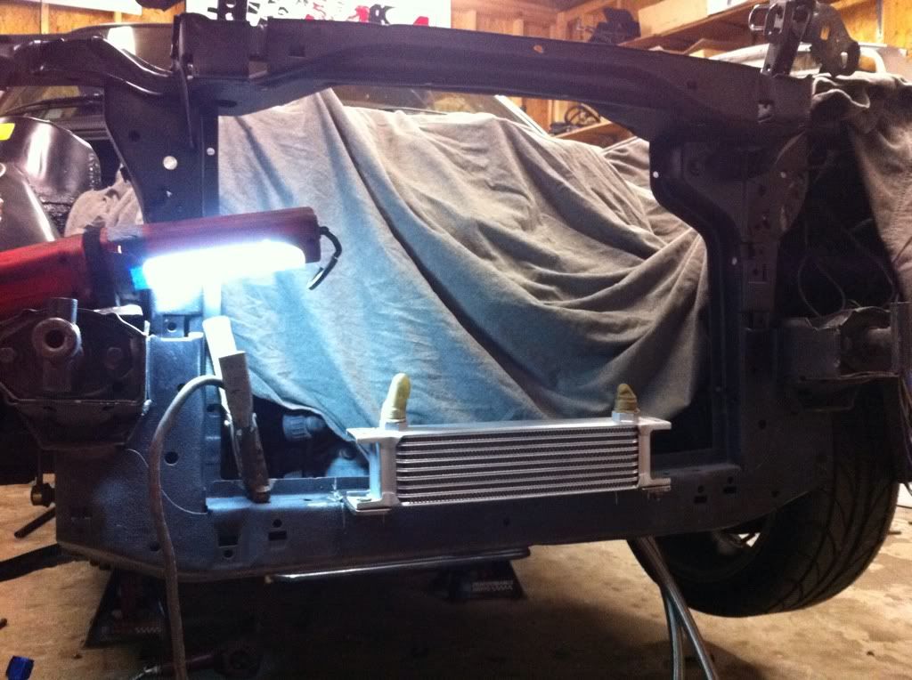

                              Cut the "legs" for the trans mount and tacked them.
                              Welded
                              Painted
                              Mounted
                              Oil cooler brackets
                              That's all for now
