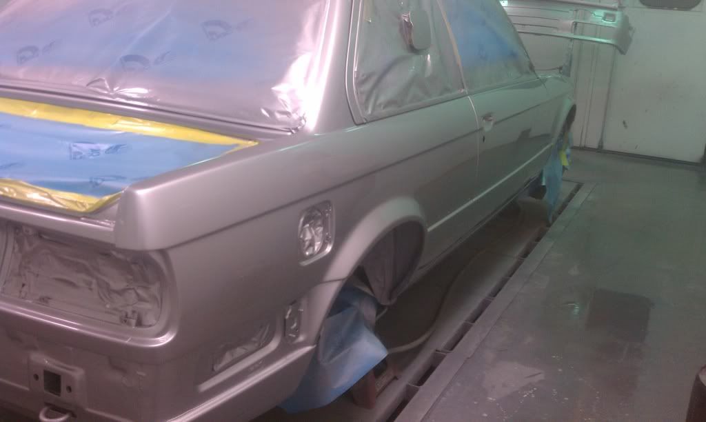

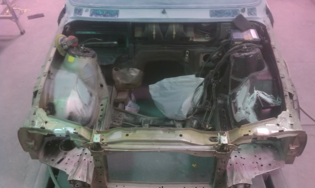

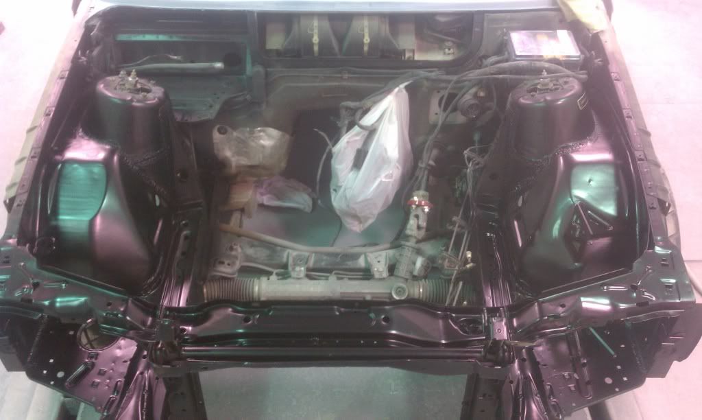

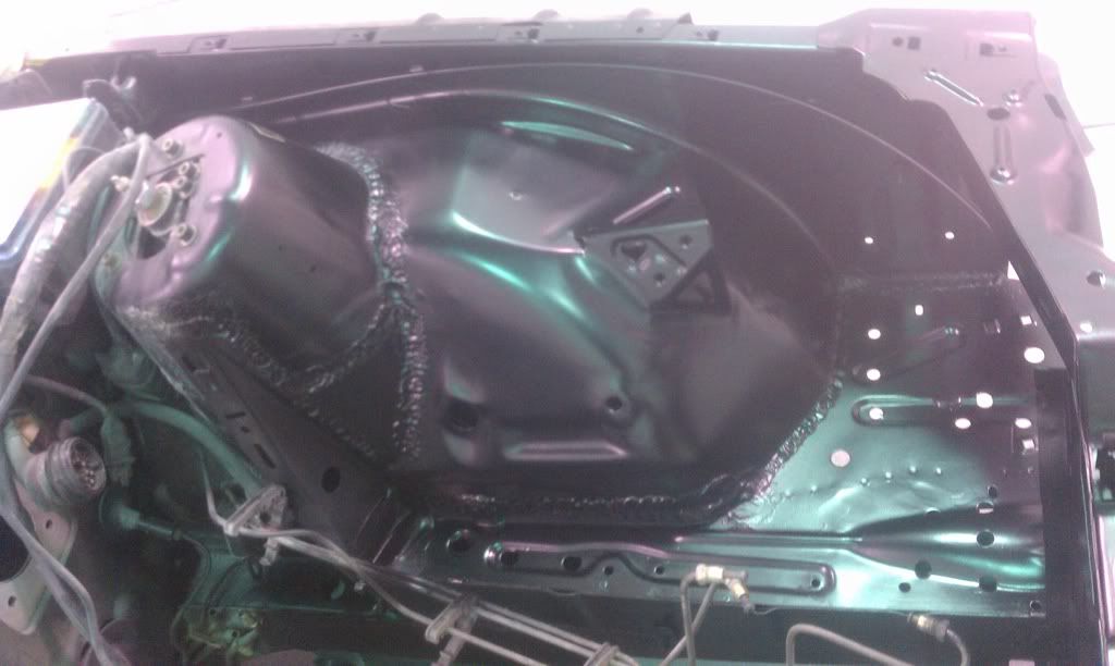

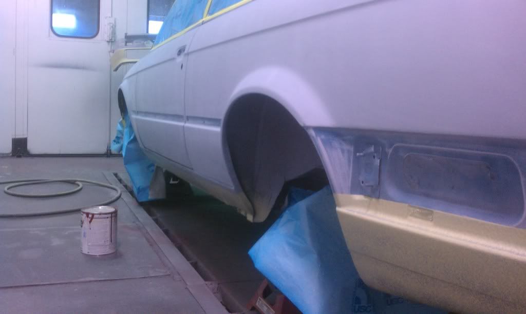

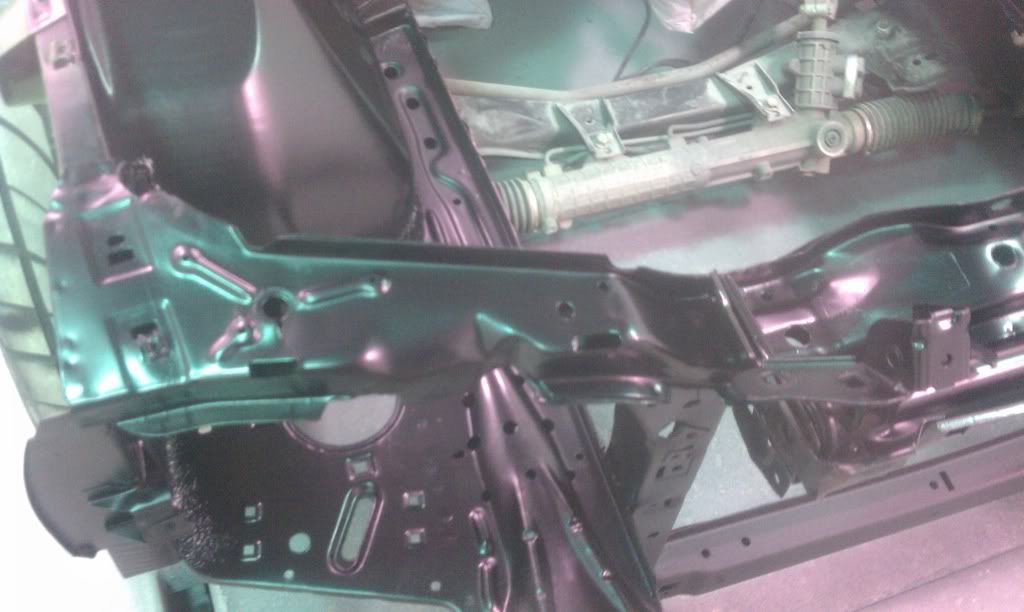

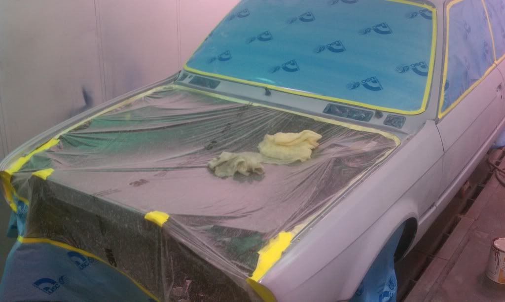

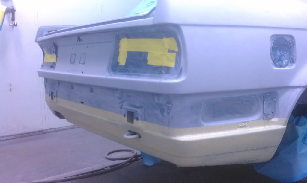

    New stone guard going on
    Final bay prep
    pre clearcoat pic

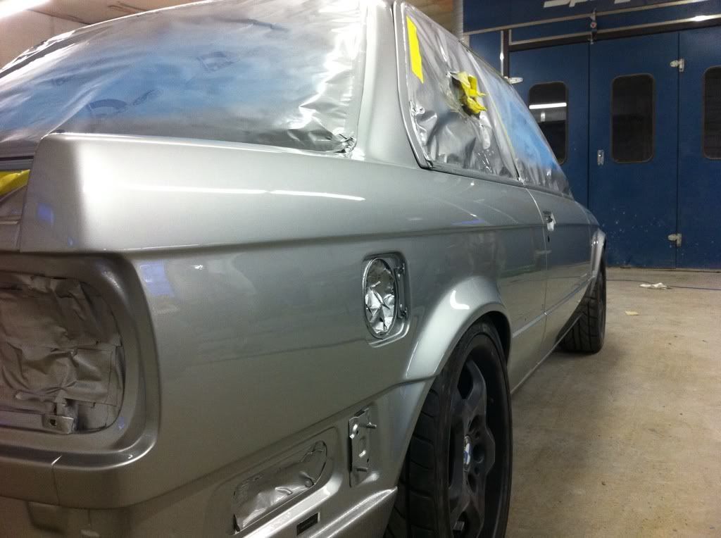

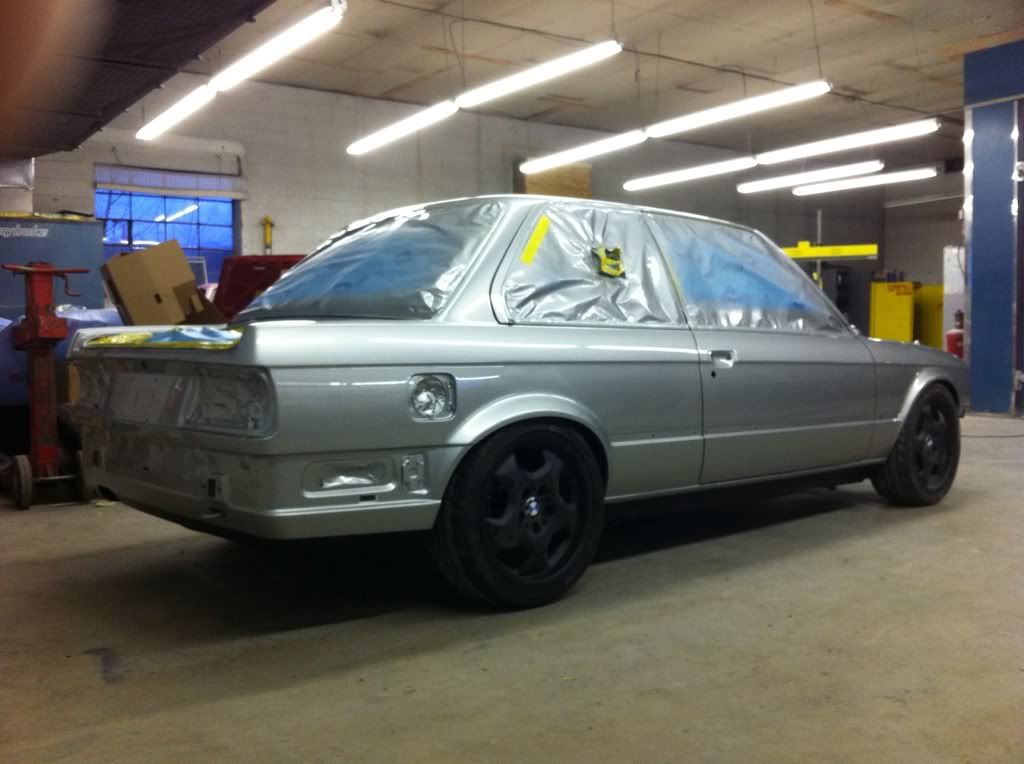

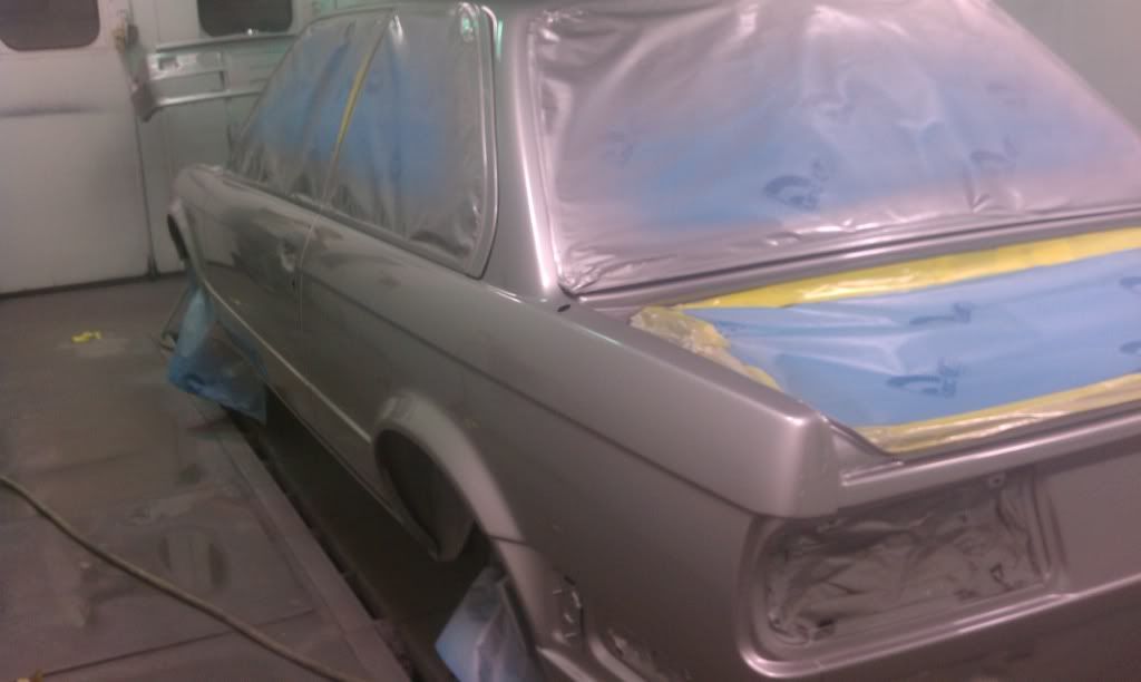

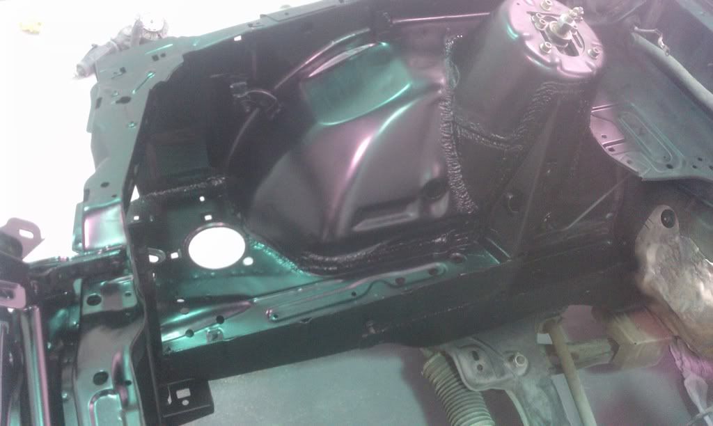

      Final coat!!

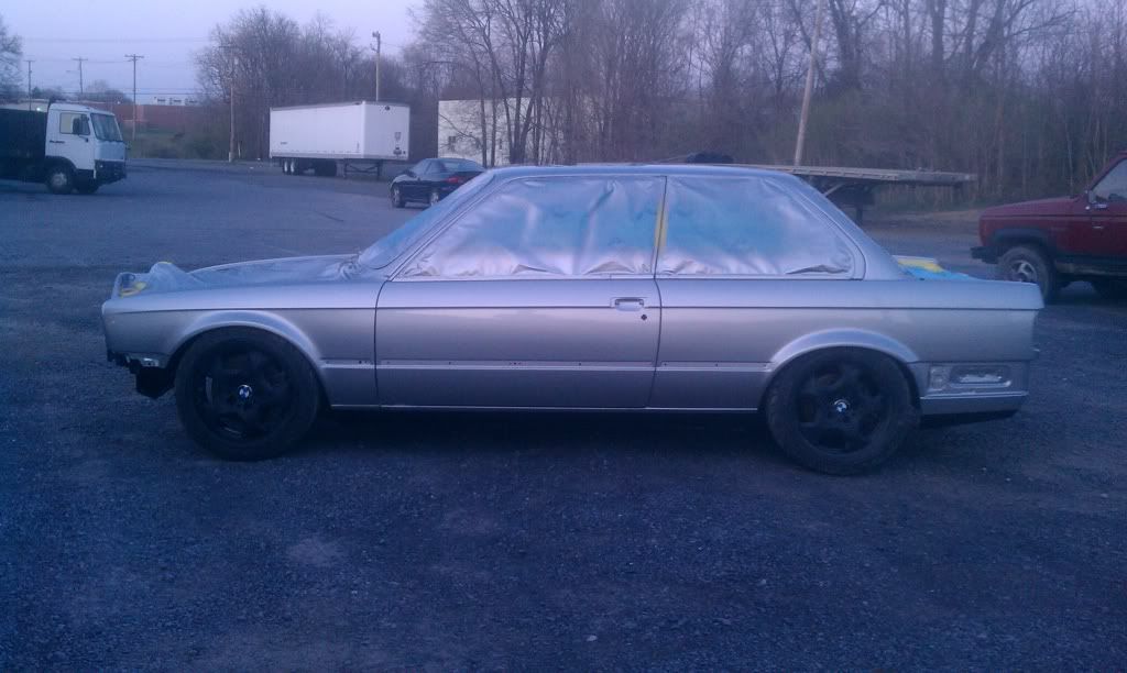

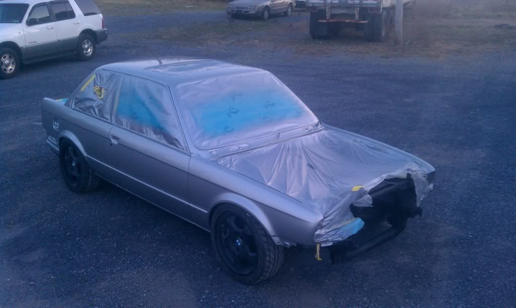

          First time outside since August 2011

              Originally posted by einarsss
              Nice work and its looks really good :)
              I'm going to steal your idea of using the booster bracket from e32 :D
              It makes things a hell of a lot easier! You'll have to massage that mount a little to get it to fit correctly with the inner fender contour.
              EDIT: Also meant to add my body guy said the inner fender alone wasn't enough structure to endure repeated braking force applied to it. I had plans to beef up the mount area and also brace it against the core support but have since moved to building a boosterless set-up.

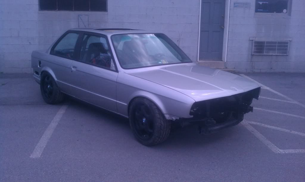

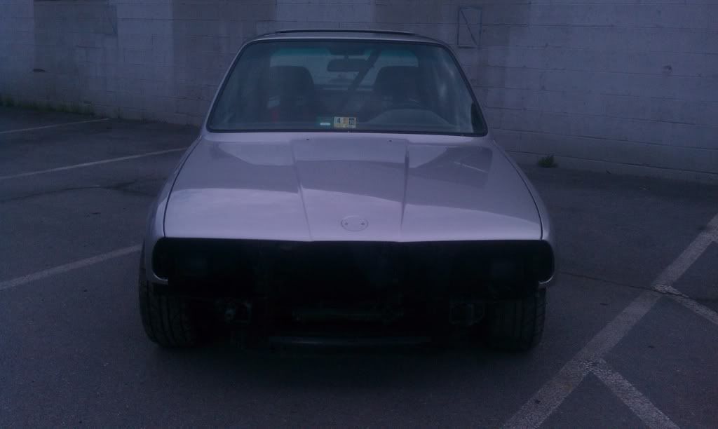

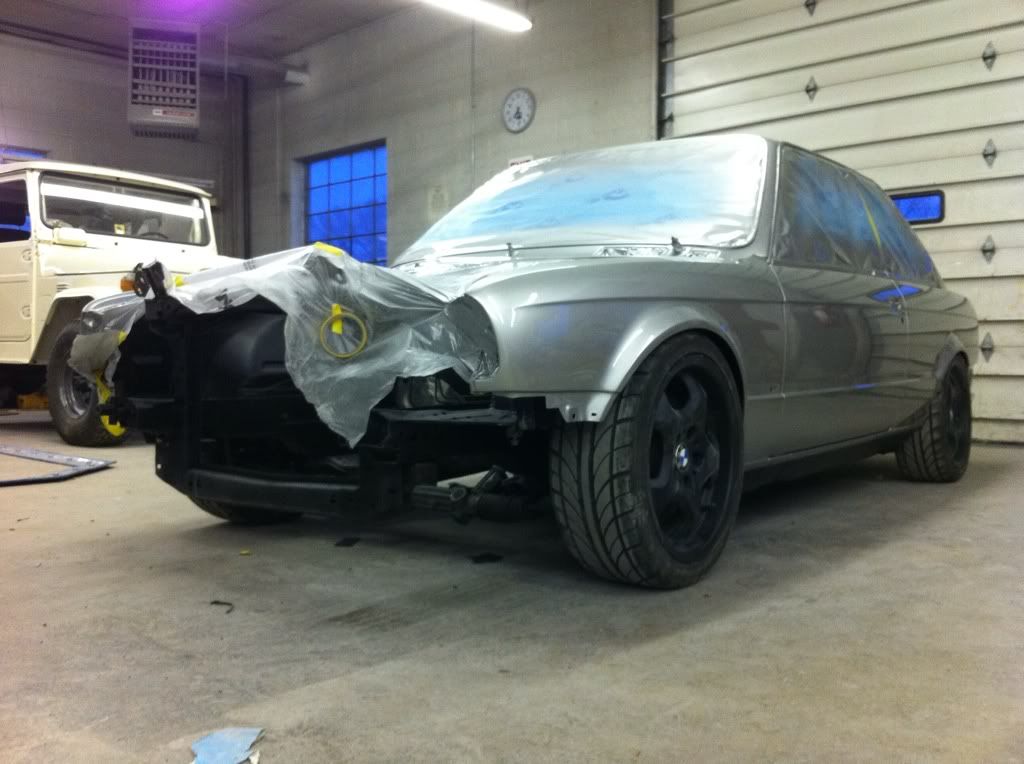

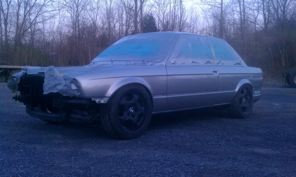

                Some clearer pictures, can't believe its finally painted!

                  Great job! Looks great man love the color.. I personally would've done the engine bay same color. But still looks nice.
                    That was my original plan but it would have been more money to paint body color and the semi flat lets me change things in the bay (weld brackets etc.) and then I can just touch it up myself without a trip back to the body shop.

                      Oh ya good decision man!

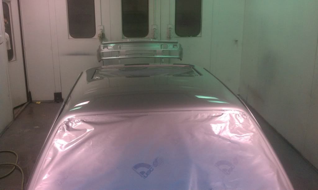

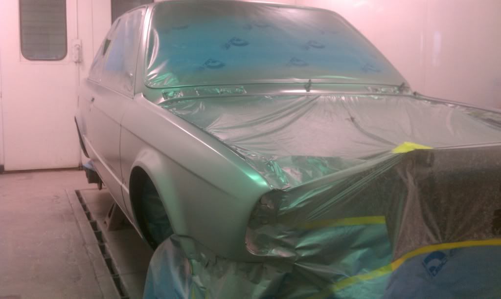

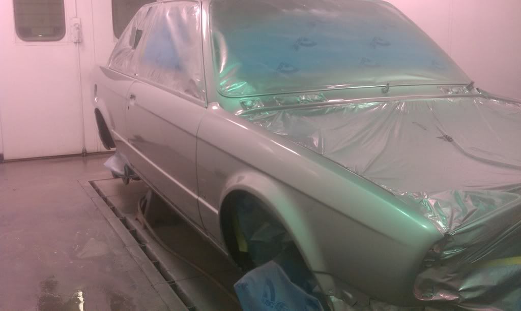

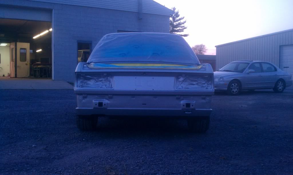

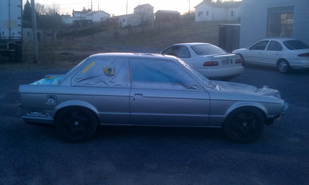

                            Masking off
