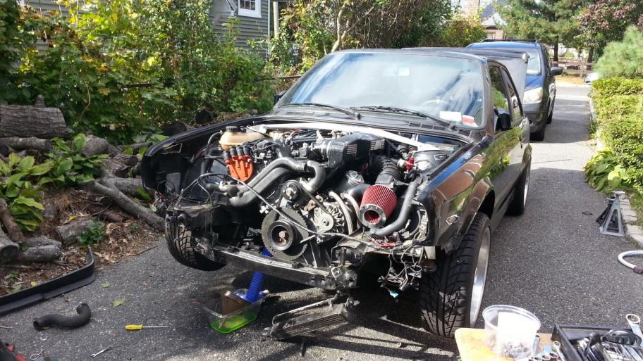

    It should recirculate through the engine until the t-stat opens? Yes there is quite a difference in size. I guess if I had decided to run the B35 cooling system to save the space I would have considered it but I'm glad the B36 fits as well as it does
    It's not just the pump... From what I saw it was the manifold that wraps around the front of the engine also; isn't that one of the big things that drove you to move the radiator?
    And some bling:
    Note the dry sump pump...

      The large b36 manifold was what motivated me to use the first radiator i had (the small one that fit in the core support) and eventually the mishimoto m20/m50. With that manifold and front mounted distributor so close its impossible to mount the radiator in the original position. Now there were two reasons why I made my own radiator support. First i wanted a bigger radiator. This past summer i had overheating issues. Due to the small size of the radiator i was limited to a 9" fan. Second reason was to be able to use the oem hoses again. With the radiator in the core support it was located much closer to that manifold/the engine than stock. Finding any oem hose to fit was impossible. I had two options. Make custom hoses from a mold (quoted at 800-1k to make) or buy silicone 90/45s aluminum connectors. Well i went with making my own but had to make them out of several peices of hose. It looked sloppy. Thats why i went with the custom support, mishimoto radiator and 16" spal.

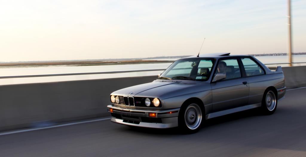

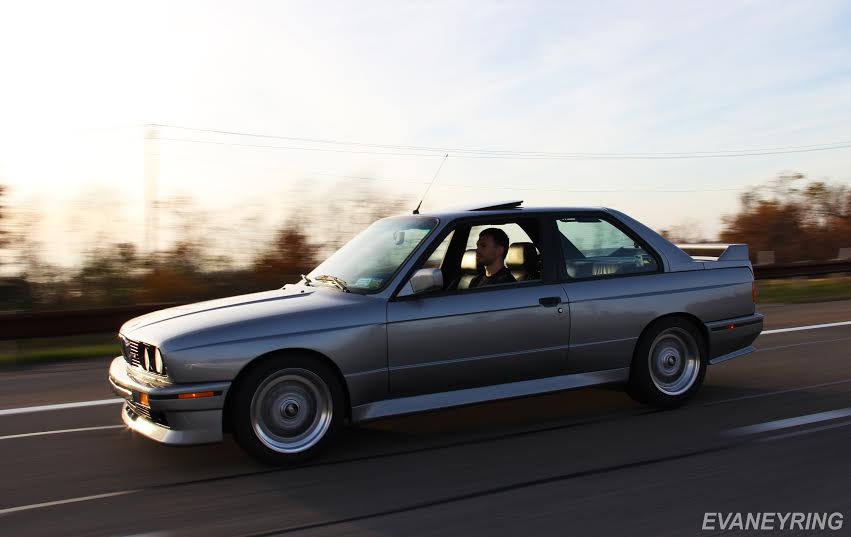

          Had a friend take some rolling shots.

          Bought some oem fogs and some DEPO smileys. Quality seems ok. made some adapters so I can go back to OEM headlights if I need to.

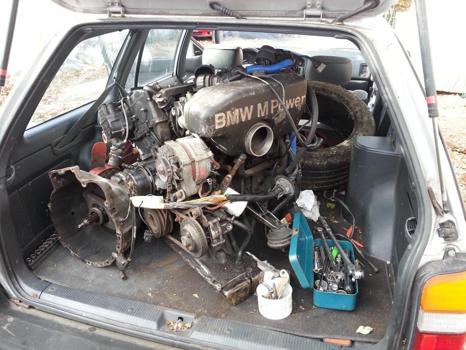

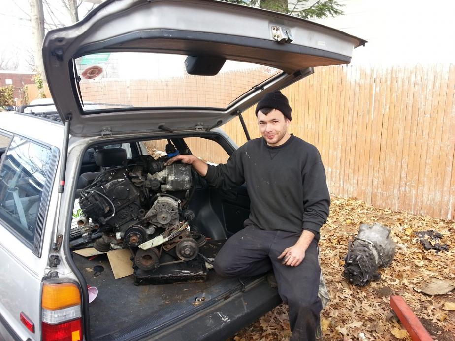

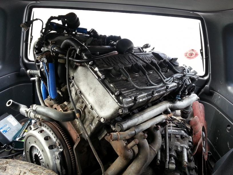

            Picked up an S14B23 and G265/5 a few weeks ago. Right now i'm not sure what i'm going to do with it. I have considered a few options, drivetrain for a future 2002 project, swap out the S38 and drop it in my 325is and make a more balanced car or just hold on to it for parts. Either way nothing to immediate.
            Vin number tag is no longer existent on engine however the tag on the tranny is still partially there. All I have is the last 3 numbers, 643 and im pretty sure the number before is a 1 or 4. I have checked M registry. No luck. Just curious of the history of the engine.

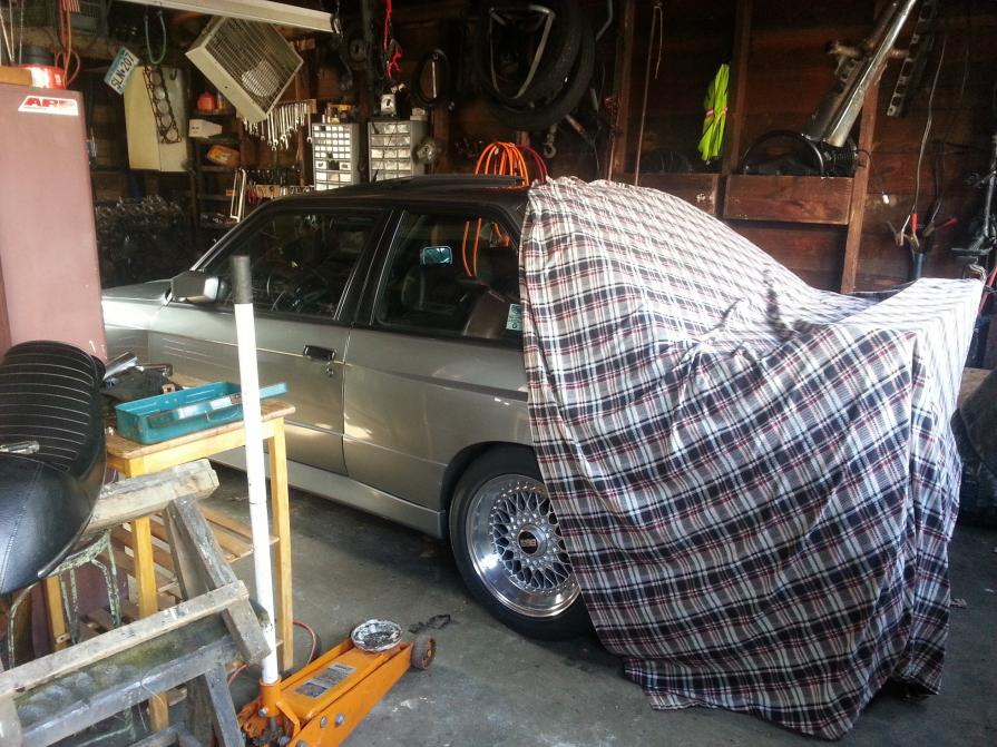

            She sleeps....

                              Post #334 the last photo is of me when you let me drive on that nice day! Wished we had more time the weekend you just stayed at my place, would have let you taken Polly through some back roads :)
