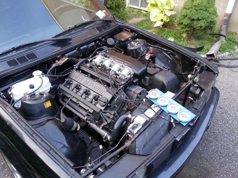

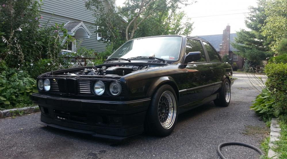

        Well its been a while since an update. I have been busy with work leaving no time in the last 4 months for the car. Ill have a lot more free time so its back to work on this neglected project.

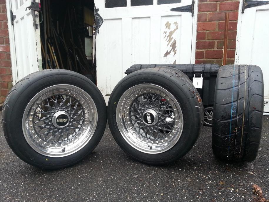

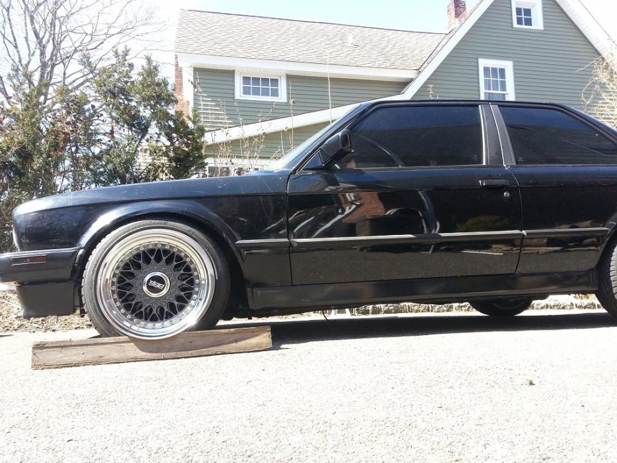

        Months ago i found a good deal on 15x8 4x100 BBS RS wheels. i fitted them with 225/45 Nitto NT01s. These would be my track setup. For street I intend to use the RC090s.

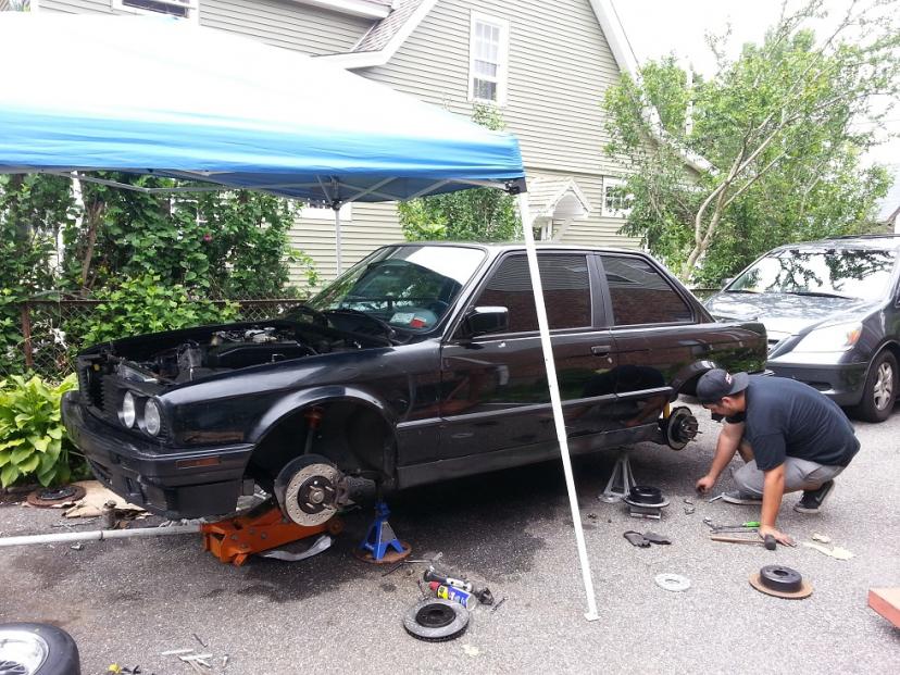

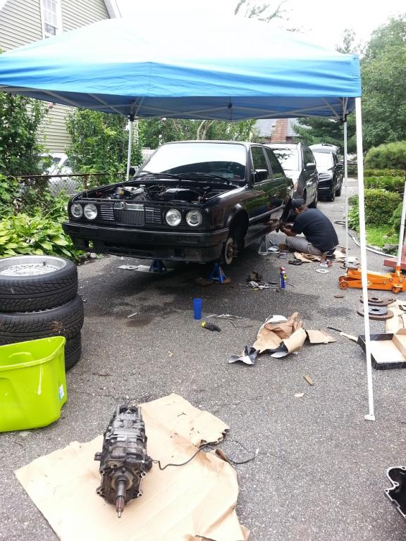

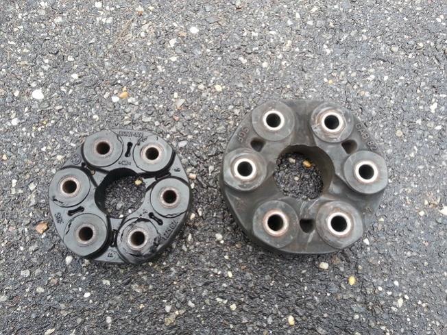

        I ran into one of my first big setbacks. It turned out the G265 tranny that i had was once in a 325i. What they did was swap the tranny output flange to fit the small input flange of the 325i driveshaft. The was an "oh shit" moment when i was under the car trying to bolt up the M3 driveshaft.
        Went to order another G265 output flange but it was NLA. Needing a flywheel sensor which was NLA as well, i began to look for another G265. Pic of the difference between a 325i(small) guibo and the M3(large) guibo.
        Originally I was running the UUC BBK kit. Realized that i would need a 22mm or larger spacer for the 15" RS wheels to fit over the caliper. This would not work an I would have fender rub issues. I'm ditching the UUC kit for now and running stock size.

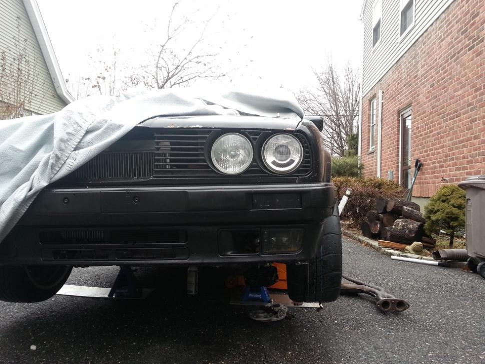

          Pretty much as she sits right now. Wrapping up the swap and hopefully be driving soon. Went to bleed the calipers the other day. I had saved the calipers from a rusted 88 325is I parted. Well my luck the bleeder snapped in half. Currently waiting on remanufactured girling calipers.

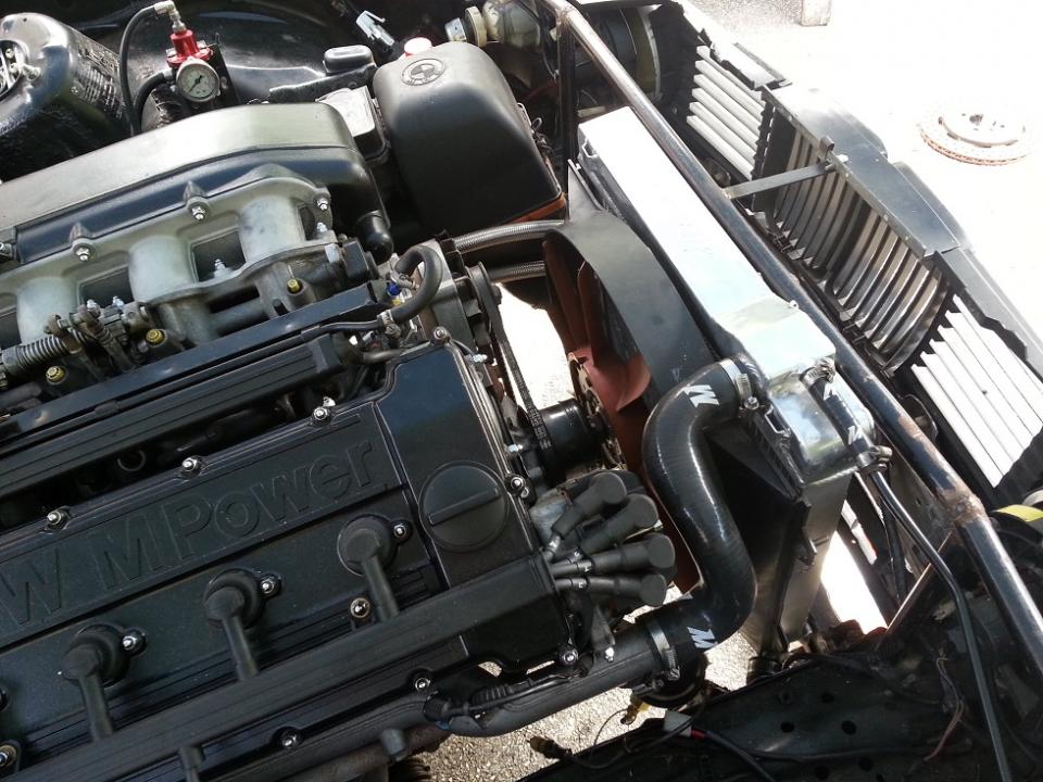

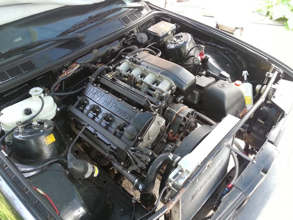

          Found myself another G265 with belhousing sensors. Swapped it in. Mounted the new supersprint exhaust and an upgraded S50 timing chain tensioner.
          Running the mechanical fan for now. Had to make some brackets to get it to fit centered.

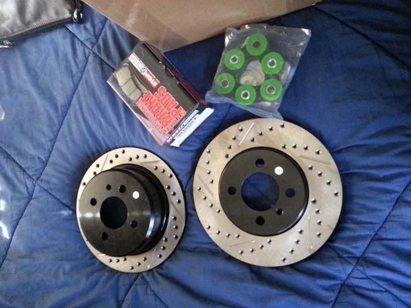

                            Well I caught the bug and before i knew it a few boxes in suspension parts were at my door. What I ordered was
                            -Suspension techniques Sway bar kit. front and rear.
                            -AKG E30 M3 Poly mounts. These ended up raising my engine more than half an inch. My old mounts were shot.
                            -Reinforcing plates and poly bushings for subframes.
                            -Adjustable end links for front sway bar.
                            Bit the bullet and bought the AKG shifter. Was it worth the $375...I try not to think about that but I really do love the shifter.

                            3 years ago when I took out the rear subframe for the first time I noticed my brake lines on the T looked very corroded. I didn't have a brake line flare tool at the time so the job was put on hold until now.
                            New brake lines were made up from lines I had lying around and stainless lines replaced the remaining old rubber lines. The subframe was finally able to be mated with the chassis again.
                            Driving after these changed was as you would expect. Awesome. Its faster and handles better than the M3.
