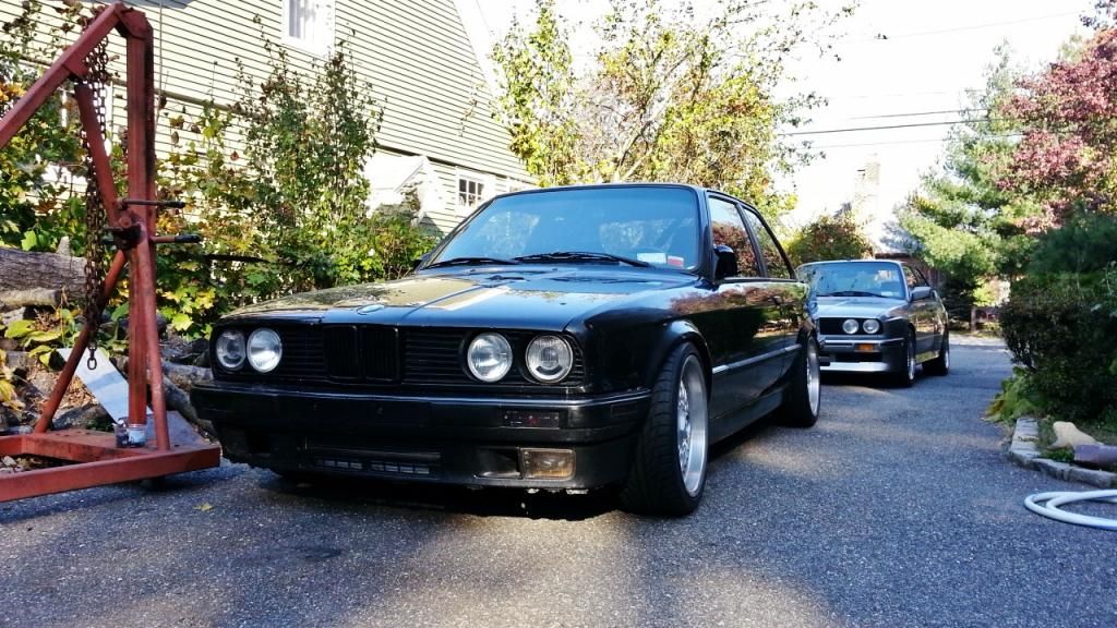

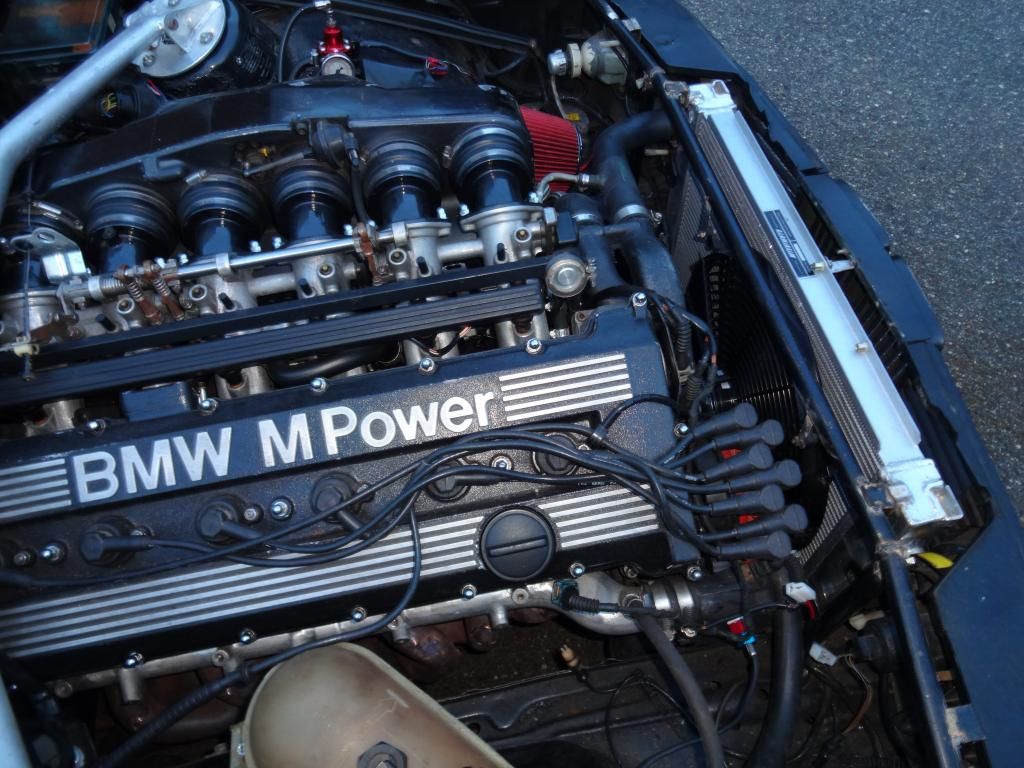

    More progress on the black car. The cooling has been the last real issue I have faced in the swap. I had hopes that the small radiator that I mounted within the core support would be able to keep up with my cooling needs but this summer it seemed to struggle a little. Also I was not happy at how close the radiator was to the front of the engine. This required custom radiator hoses. I looked into having silicone ones made up but at the cost of almost a grand to have the two made, I decided to make my own which were rather ghetto rigged. After blowing out a radiator hose I decided "F**k it" Ill make a new solution out of 1/2" schedule 40 pipe.
    So much more room and I can use the stock s38b36 radiator hoses. Mishimoto M20/M50 radiator.
    Happy with first tests. Temp stayed around 180F even at low speed.

      You should grab the mishimoto/ebay 3 core Z3M rad, then you could say goodbye to cooling issues.

        Stock fan?

          And you went back to the B36 waterpump also (I thought you had been running the B35 waterpump)
                    Will i have been running the b36 water pump since day 1.

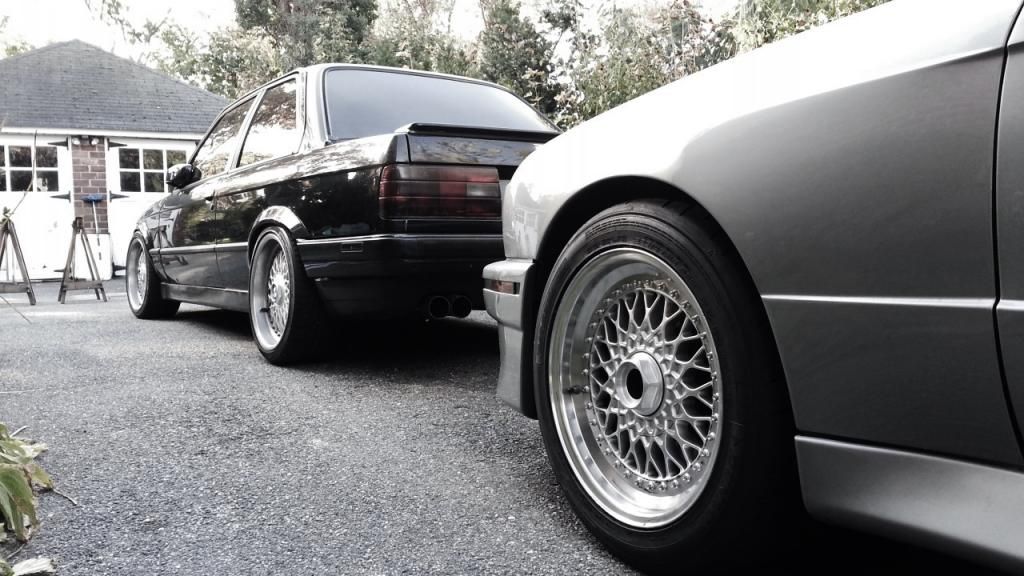

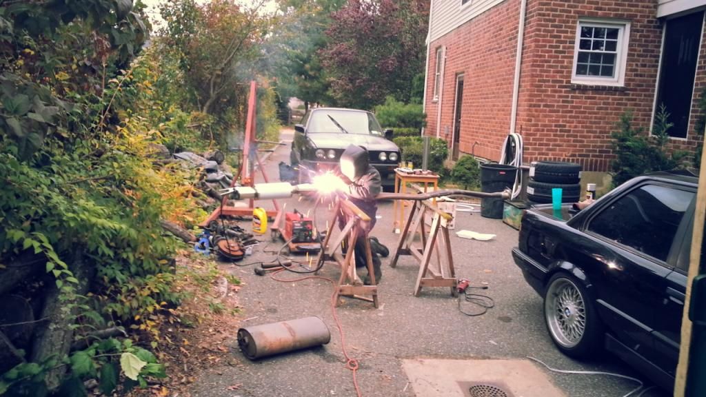

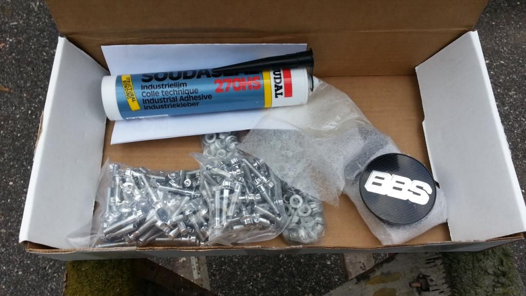

                    Productive week. Built an exhaust for my friends M54 swapped e30, worked on the front end of the s38 car and finished up the RS restore.
                    Mounted a 16" Spal puller behind the radiator. So far seems to be working very well.
                    Front end after the tubular support welded in

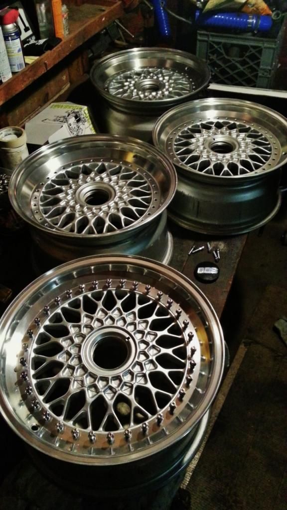

                    The wheels ready for assembly. So please with how well they cleaned up. About 40 hours of my time scrubbing and polishing and about 350 dollars to get to this point.
                    Goodies from black forest.

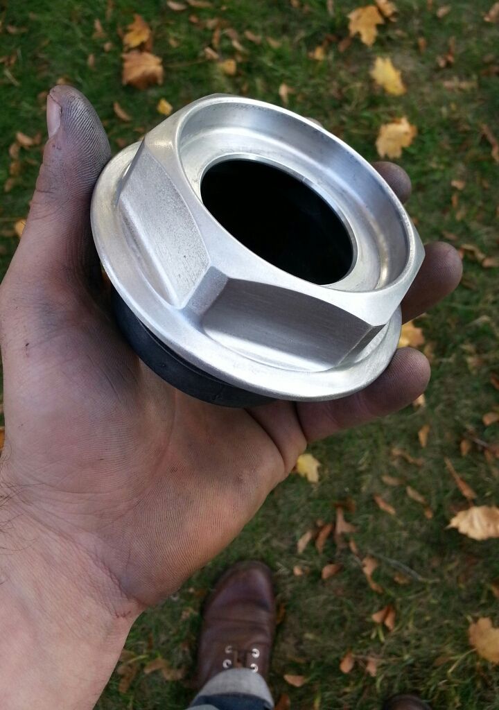

                    Center nuts cleaned up nicely as well. 72mm
                    New meat. Very hard to find sizes that i wanted in 16" Tried to get tires with similar characteristics. So far so please with how well this combo has worked. Car grips the road so well.
                    fronts: 225/45R-16 Dunlop Direzza ZII Star Spec
                    rears: 245/45R-16 Bridgestone Potenza RE-11 SL
                    Finally the wheels were put back together. Ive read people telling different ways to assemble these 3 piece wheels. Some call for putting the silicone on after torquing and some recommended torques as high as 44ft.lbs. I laid on a layer so silicone on each side. Put the 3 pieces together, then hand tightened all the bolts. First going to 15ft.lbs in a star pattern so it was tightened evenly. Finished up at about 25ft.lbs for the second pass. Thread locker used on the bolts.
                    Thanks for viewing

                              Hi.. a lot have happened .. M3... BBS etc etc
                              i like the cooling solution..
                              just one thing.. i would really recommend that you isolate the intake filter.. for heat
                              here is a picture of how i did it..
                              the oem airbox was heated underneath ,, because of the ABS unit,,, and i had to cut of the intake hose.. but there is some difference between B38 and B36 intake lengt,, incl MAF
                                After a work out the bugs i plan to run something like that. unfortunately I don't have a stock airbox lying a round so ill have to fab something.

                                It should recirculate through the engine until the t-stat opens? Yes there is quite a difference in size. I guess if I had decided to run the B35 cooling system to save the space I would have considered it but I'm glad the B36 fits as well as it does
