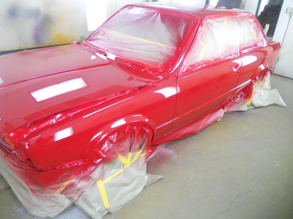

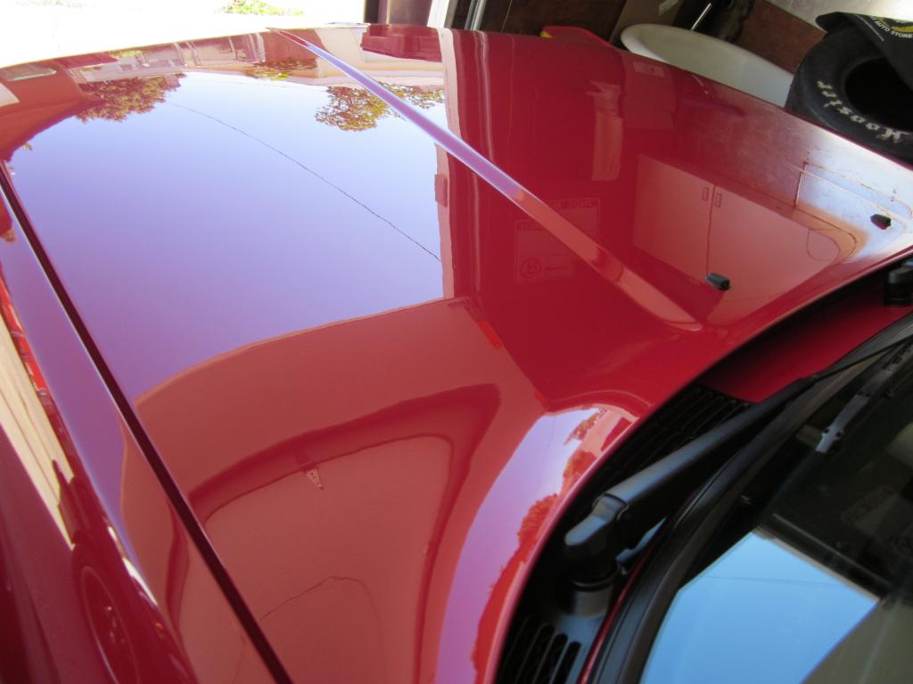

                        You've got to be so happy at this point, even with the clear situation. Did you have any dust-up issues with not using a booth?
                        Had my car resprayed last year and he used PPG base/clear. The 3000 clear lays on easy and looks great after it's color-sanded. I've heard good things about the Eastwood line, just haven't seen it in person. Seems to be a muscle car preference.
                        Here's a couple pics to get you eager to finish:
Name:	Body & Paint 22.jpg
