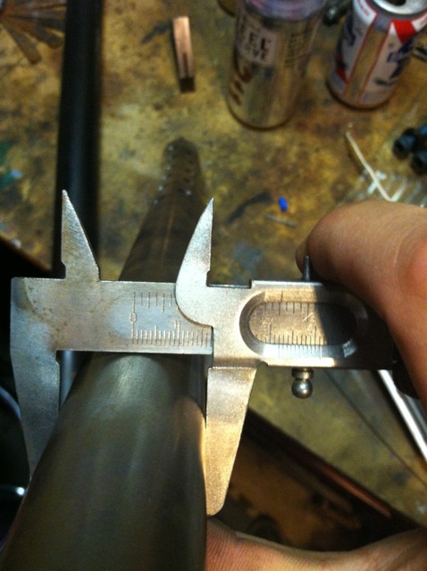

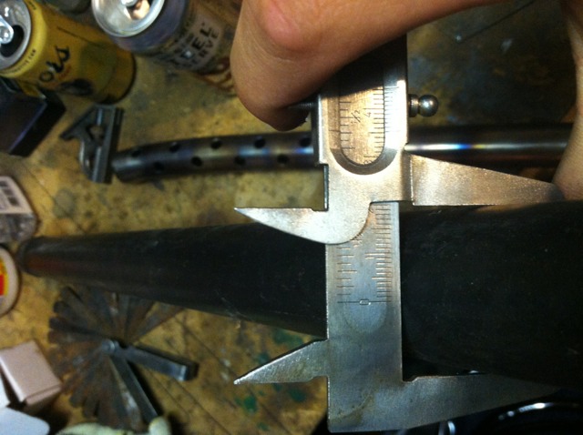

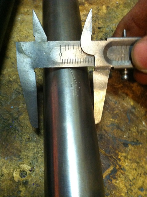

                      The original ds was 1 3/8". I inadvertently put the smaller one (1 1/4") in when i did my first swap because the splines were in better condition. It was the one that got destroyed when the bolts or whatever failed.
                      Here are the pics of the measurements i just took.

                      http://r3vlimited.com/board/showthread.php?t=201774

                        I wonder if it's not oem bmw?
                            Perhaps!! Good idea

                              I just measured the two I have on my shelf (definitely OEM BMW) and they were both 32mm in diameter exactly

                                Which would be the smaller of the two sizes i have. The larger one was 35mm. That was the shaft that was in the car since day 1. This is kinda weird, i know for a fact based on receipt history that the 2 old men that owned the car before the guy i got it from never changed a thing, it was bone stock. Only maintenance items were addressed. The guy that had it before me told me about how you could shim the shaft to catch more meat on the splines but had never bothered touching the thing. Its not a euro ix cause its the 3.91 final drive, although the car was imported from germany. Pretty sure all ix's were, right? Theres always the possibility that it could have been replaced and the records are missing.
