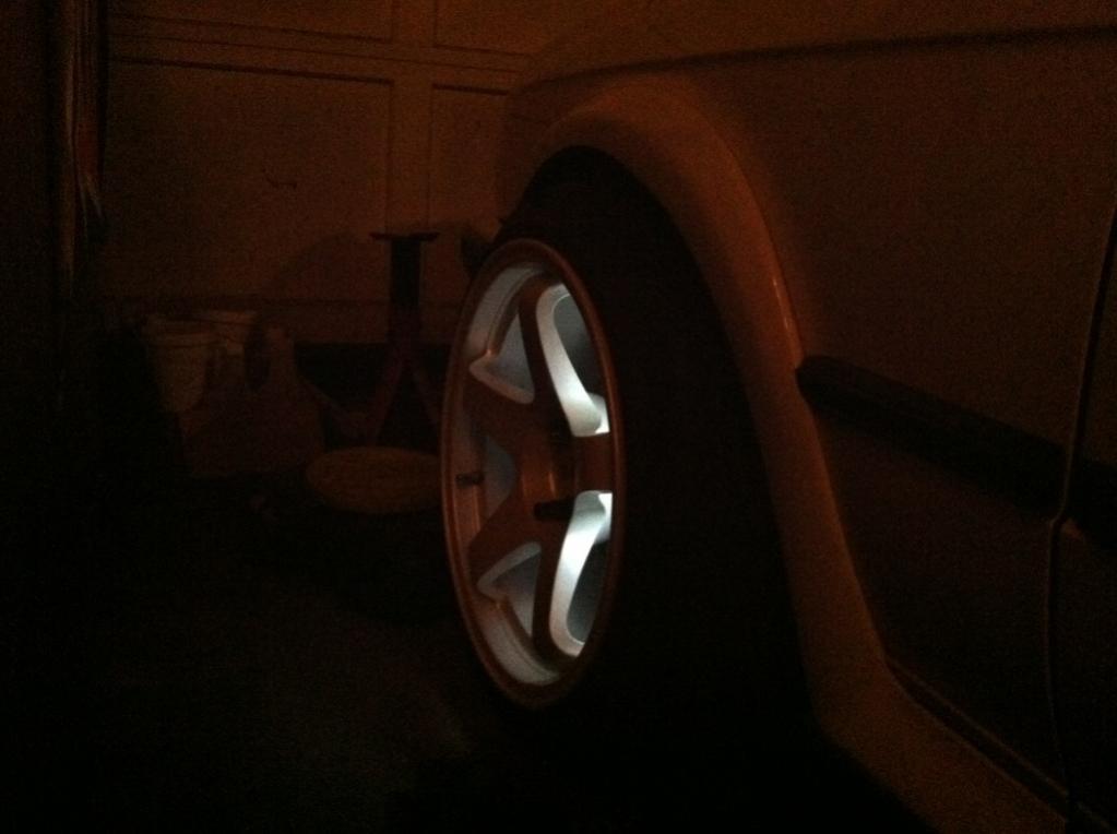

        more pics with the Rotas on PLEAAAASE :hitler:
        • IxTech
          • 471
          #94

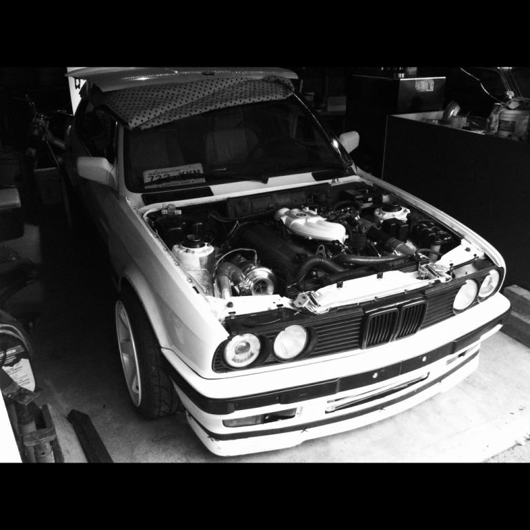

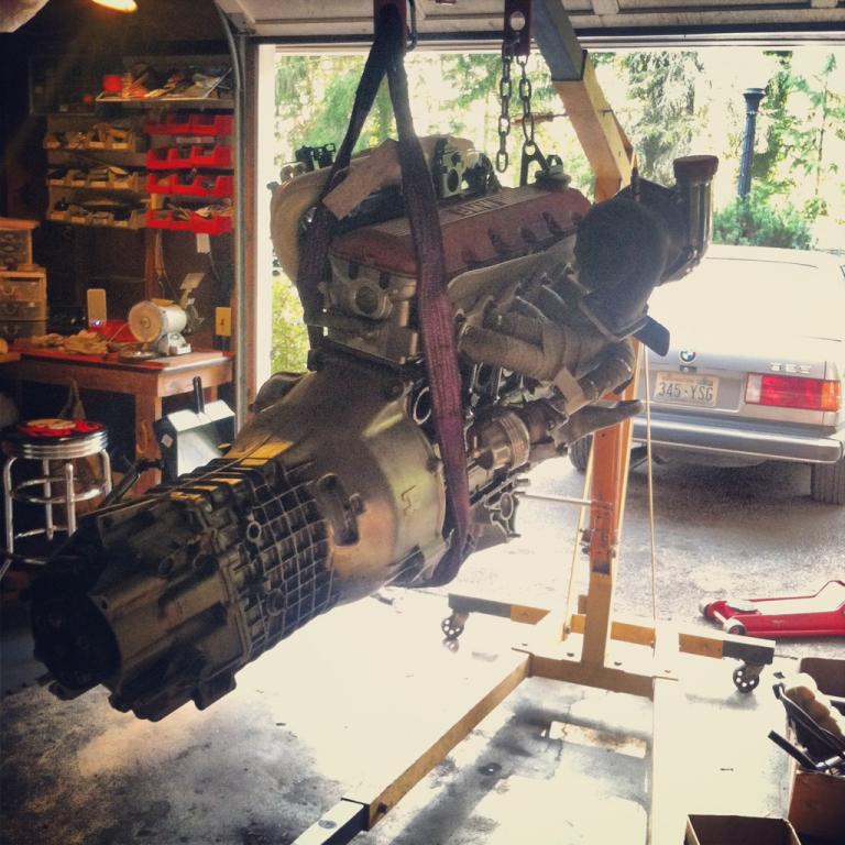

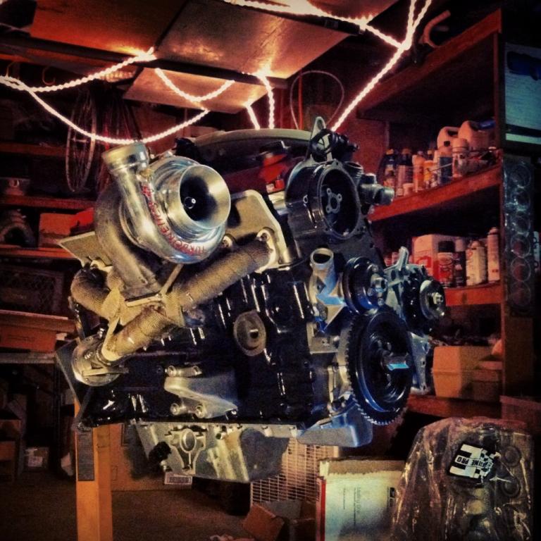

          It was dark and kinda grainy. All these are off my iphone. Got my .120 mls and was able to get the m20 assembled tonight. Will be drippitydroppin it in this weekend so stop working on your shit and follow this hoonigangster build as i wrap her up and break it in on the way to portland.

              DAMN!!! Epic build. What boost levels are you planning on running? I plan on building a turbo motor in the near future. Did you fire-ring the head? Again nicely done.
                Thanks man! Gonna break it in at 8lbs. Then retune at 15lbs. It will boost creep to about 20 though....thats as much as i want to push on the stock pistons.
                You should! If youre really bored, patient, have uncontrollable urges to be a gangster, and/or are rich. My power/drive train has more money into it than i paid for the car in pristine cond.
                Im not sure what you mean by fire ring? But no oring-ing was done. Just metal hg, i will be getting a groove-o-matic soon though so i can oring the next block with a stock hg. I didnt go that route this time because the block was decked so i had to bring that compression back down to a boostable zone, and then some. Sittin about 8.0:1 ;)

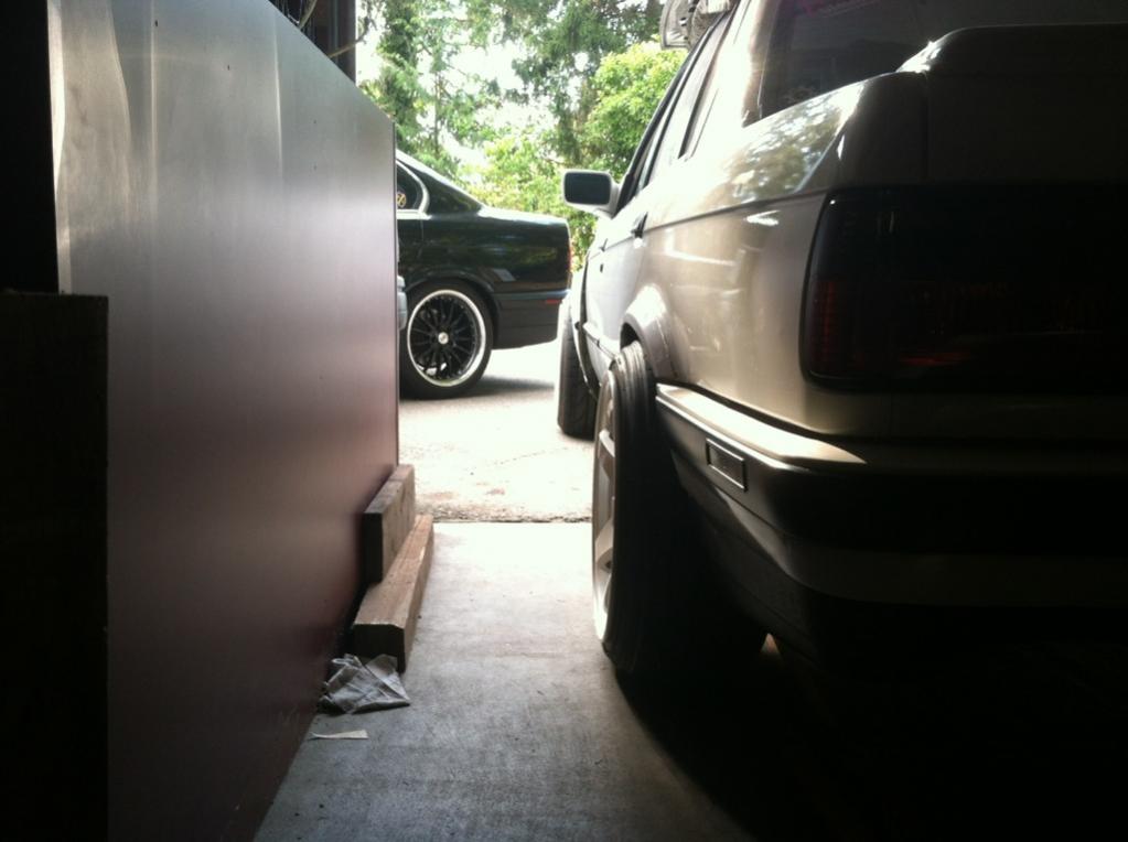

                Heres a pic from the weekend. Im only a few more days away from having everything ready for the first start.

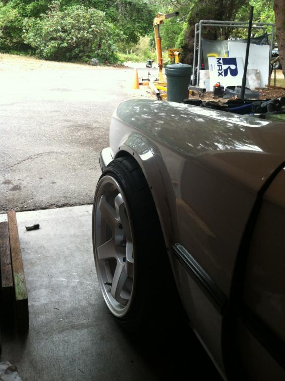

                            Ill leave this hereClick image for larger version
                            Truckin a little bit still.
