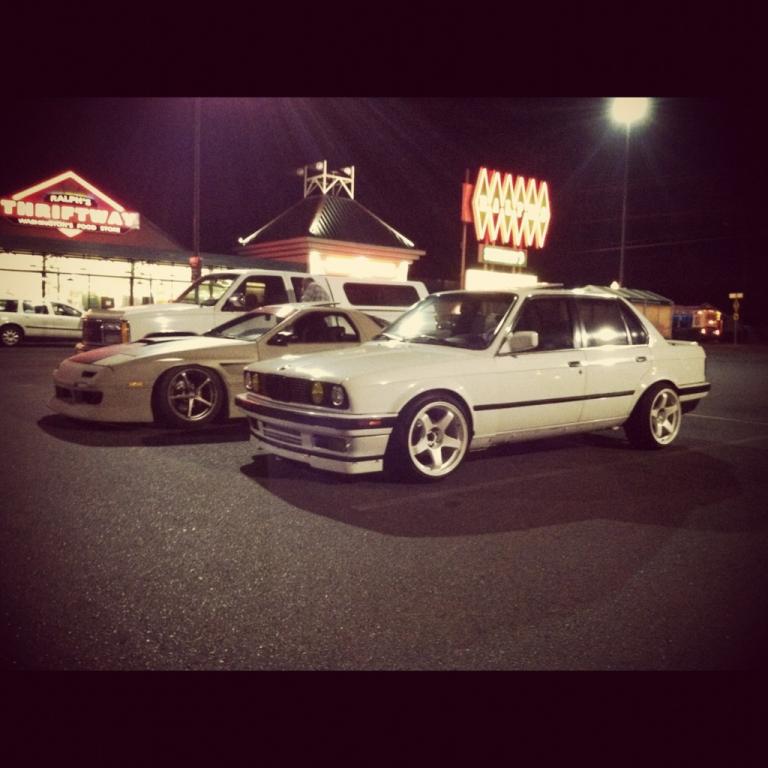

                    Went out last night with some buddies for a stroll. Had a great time with some good people.
