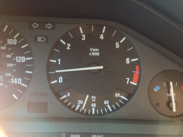

                Got this installed. Still some bugs to work out... but it'll be nice when it's finished!
                e30 restoration and V8 swap
                24 Hours of Lemons e30 build
                  That looks cool... if I didn't have the aftermarket VDO pressure gauge, I'd do that, for sure...

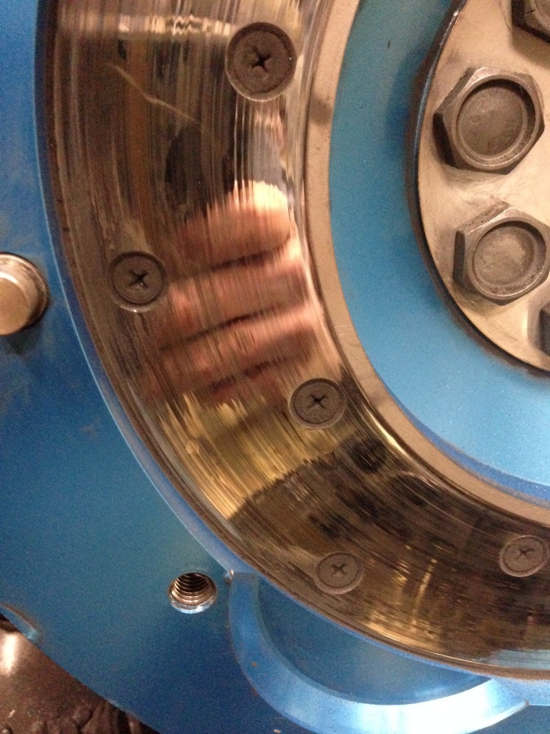

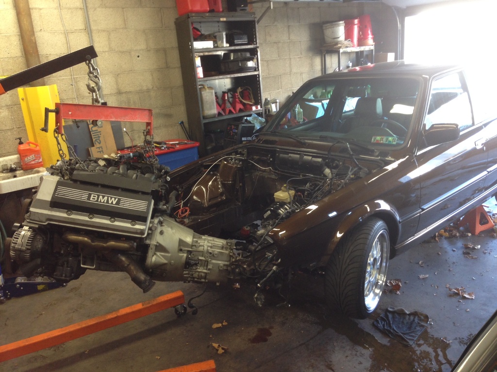

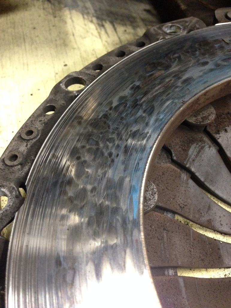

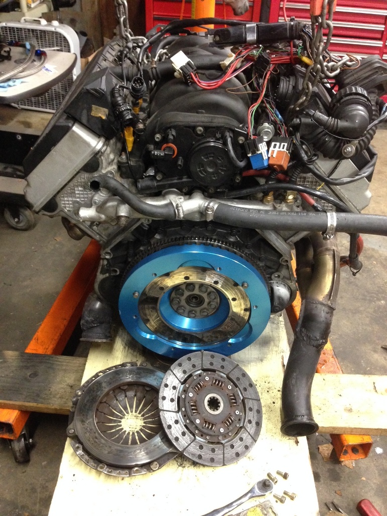

                            I tore the engine and trans out this weekend to pull the clutch, since the slipping is getting worse.
                            The clutch is trashed. The disc itself is worn a lot more then I was expecting, and both the pressure plate and flywheel are covered in grooves and hot spots. So I ordered a new flywheel friction disc and a SPEC Stage 1 m52 clutch rated for 345 lbs ft. I'm going to do a few other little things while the engine is out, and hopefully have it back in and running within a few weeks.
                              Lol holy shit. How long did that clutch last you?
                                12k miles. I didn't break it in at all, and at about 3k miles in, went drag racing with it. It started shuddering after that night when engaging the clutch, so I started slipping it to make take-offs smoother. Basically, I beat the shit out of it and did everything you aren't supposed to do. All of that on top of the fact that it was designed for an m52, not an m60.
                                I honestly would have tried another Clutchmasters FX100, and broke it in properly this time, but they didn't respond to my inquires. SPEC did (very quickly, at that), so they got my business. They are both 'stage 1' organic clutches. The FX100 didn't have a torque rating, it just said 70% over stock. The SPEC has a rating of 345 lbs ft.
