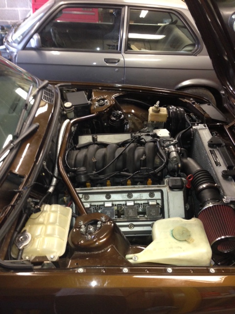

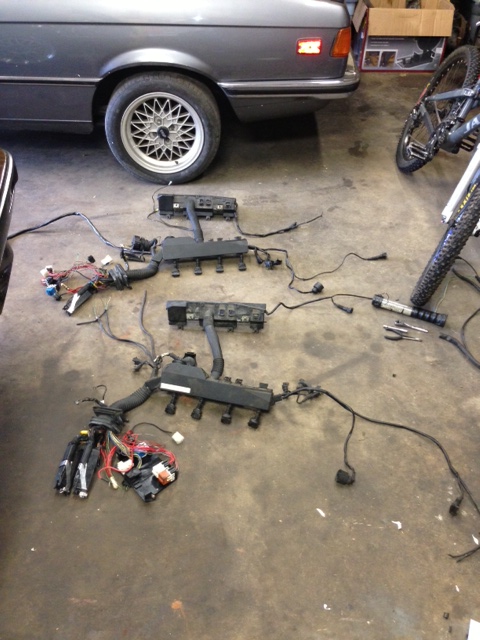

          Well, it's been a little while since I've posted in this thread. I've been working on the car off and on, still trying to work out some kinks.
          I still have my issue where it backfires/hesitates when getting on the gas after engine braking. After replacing the entire fuel system, ignition system, DME, and running every test known to man, I decided to replace the engine wiring harness. This was a 2 day affair, as I used an auto harness that had cut o2 wires, so there was a lot of work involved in getting that sorted. In the end, the car drove 100% identical to how it did before. So, I guess there is something wrong with the actual engine. Since compression, leakdown, and vacuum are good, it must be timing related.

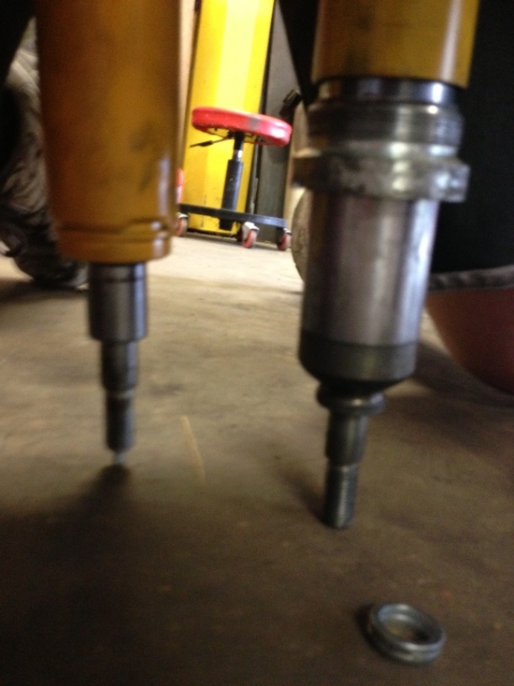

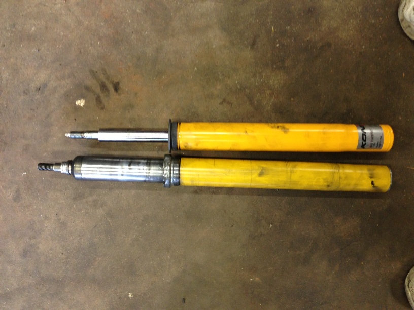

          Finally, I replaced the front 325iX Bilstein HD's with 325iX Koni SA's, which were a grade upgrade. Much better matched to the 450 lb springs. Also lost about 2" of droop and gained about 2-3" of travel.

              I *FINALLY* got the drivability issues sorted. It was a bad chip that I got from a member on bf.c. I put a stock DME from an automatic car back in, and all of the hesitation and stalling issues disappeared. It did do some weird things because of it being a factory automatic chip (power limited below 3k, hanging RPM's when lifting, etc...) So I picked up a Mark D chip for a manual m60, and put that in, and now the car runs perfect.
              I tried a stock DME before, but I had other issues at the time (pre-o2 exhaust leaks causing the DME to read fault codes on both o2's). And the backfiring. I figured all of these things were being caused by the same issue, so I didn't bother leaving the stock chip in long enough to notice the difference.
              I still get a backfire/crackling when getting on the gas after engine braking, but this seems to be the norm when running catless m60's. I may put a set of cats on it, as it's pretty annoying.

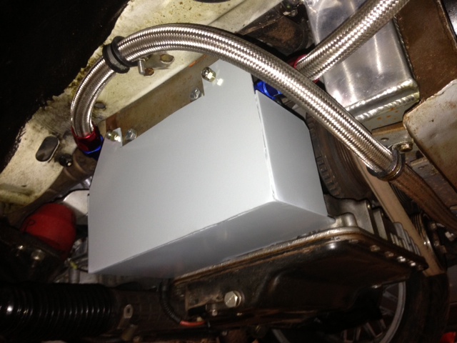

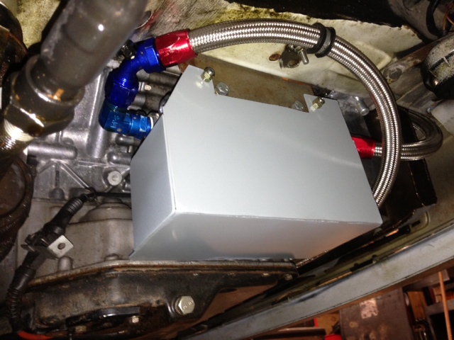

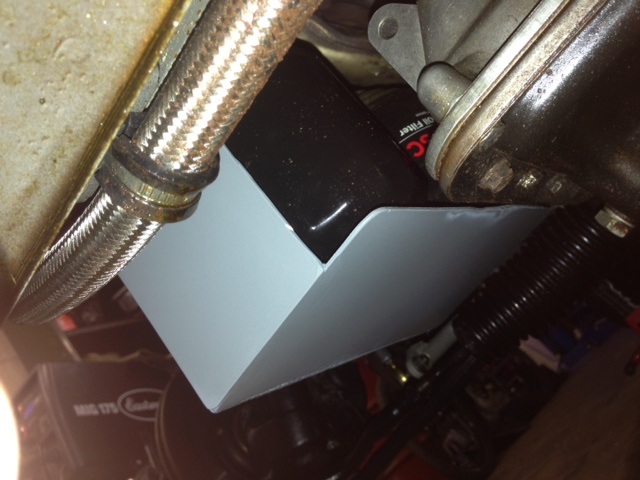

                          Well, just hours after posting this, I blew out another oil filter on my way home from work. This time I cut it apart to see if it was a filter failure, or if I could see evidence of debris hitting it. I built a metal box to surround the filter, there's no way debris should have hit it. I couldn't even find the pinhole leak in the casing after cutting it open, which is odd because the filter was dumping out oil with only ~10psi to them. So I have no idea.

                          Yeah, well I had to grind the filter mounts off of the cylinder head for radiator hose clearance, so I can't use it in the stock location regardless. But I'm thinking of converting the housing to AN fittings and mounting it over on the passenger side where the A/C accumulator used to be, there's a round hole in that tray already. I could stick it down in there, out of site, and still be able to remove the filter from the top. My AN hoses are already run over there, I'd just need to run the pressure bleed-off hose back to the oil pan on the drivers side.
                          I don't want to deal with any aftermarket parts anymore, at least not for the oil system.
