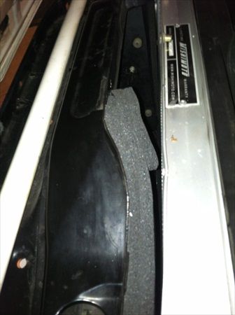

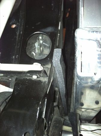

                                cutting, all the grill vents open may help get a little more airflow to the radiator.
                                you can also buy this for 5 bucks at home depot,
                                1 kit is enough to do an e30 radiator.
                                the idea is to help seal all the airflow from escaping around the radiator.
                                and seal it to the core support.
                                every little bit helps.

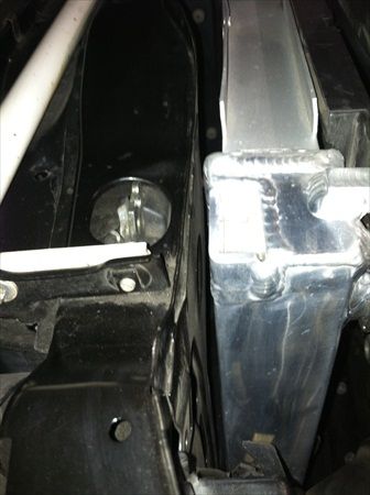

                                the gap I'm referring too
                                apply product, its adhesive backed on one side
                                you can also do the top between the radiator bracket
