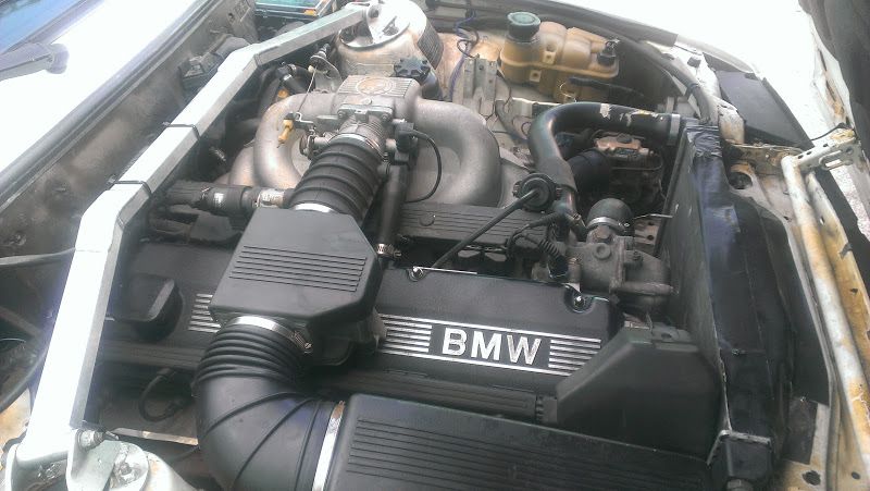

                  I had this saved from a long time ago,
                  looks like a member just used black duct tape on a track car to help seal the radiator gap.
                  maybe something like this but executed cleanly would help the cooling issue
