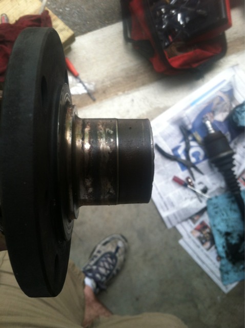

              Worn out wheel bearings? How's this? Click image for larger version
ID:	7147615 stock suspension though. Estimated 300-350k miles.
              I agree with nando though. I don't see how lowering the car will kill the bearing. The cv joint, yeah sure...

                              Originally posted by Kershaw
                              Worn out wheel bearings? How's this? [ATTACH]61169[/ATTACH] stock suspension though. Estimated 300-350k miles.
                              My right rear wheel hub looks like this as well. Wheel bearing went south and this is what I found. Mine is super high mileage as well though. ~500 something thousand
