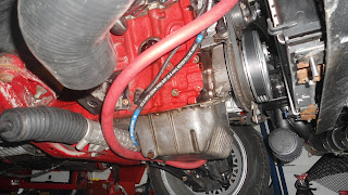

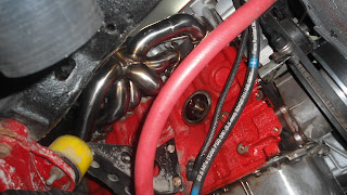

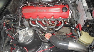

      making room for the new turbo... cut some useless brakets.. push my EPS further to make room for air filter
      I just put a used filter temp on the pipe at the other end so no debrie would go in..but that pipe is going to connect to the turbo.
      shot of the intercooler
      another shot so you can see that the filter now hits the manifold... anybody have a spare filter adapter I can buy from?
      and just a quick shot of the turbo (still needs to be turned the correct way for the oil feed/drain and air outlet
      more to come...

          can't you use the stock filter adapter? Or do you need it for your oil feed?

            I lost the one that came with the engine :( but I would so need one right now... the kit comes with a clever sandwich adapter that provides for the oil inlet to turbo...but unless I have the stock oil filter adapter that does a 90 degree bend so my oil filter sits behind the manifold am SOL right now...:(

                Just use a smaller filter off an m42 I think? I had one for awhile, no problems.
                Could also tee your turbo oil inlet off the stock oil pressure sender outlet.
                I wound up running a trans dapt relocation kit to a Ford temp controlled sandwich plate to an oil cooler and a wix 51515 filter

                      Sorry believe it was an s14 filter that is short and fits.

                        ok thanks! I just remembered the oild filter I removed and didnt fit was an even smaller filter then stock (because it didnt fit the headers) and its from a 80's V6 toyota Camry. So I would have to compare the size of the S14 to the one I have but unless its really shorter with the sandwich adapter it wont fit.. :(

                              s14 filter is the same size as the small camry filter :( wont fit at all unfortunatly.
                              thanks for those who PM'd me with offers to sell me a filter adapter..I bought one from member "e30euro" should have it soon.
                              I will wait to install it before installing exhaust manifold...so I will attack other parts of the build until it arrives... Exhaust system, turbo air pipes...
