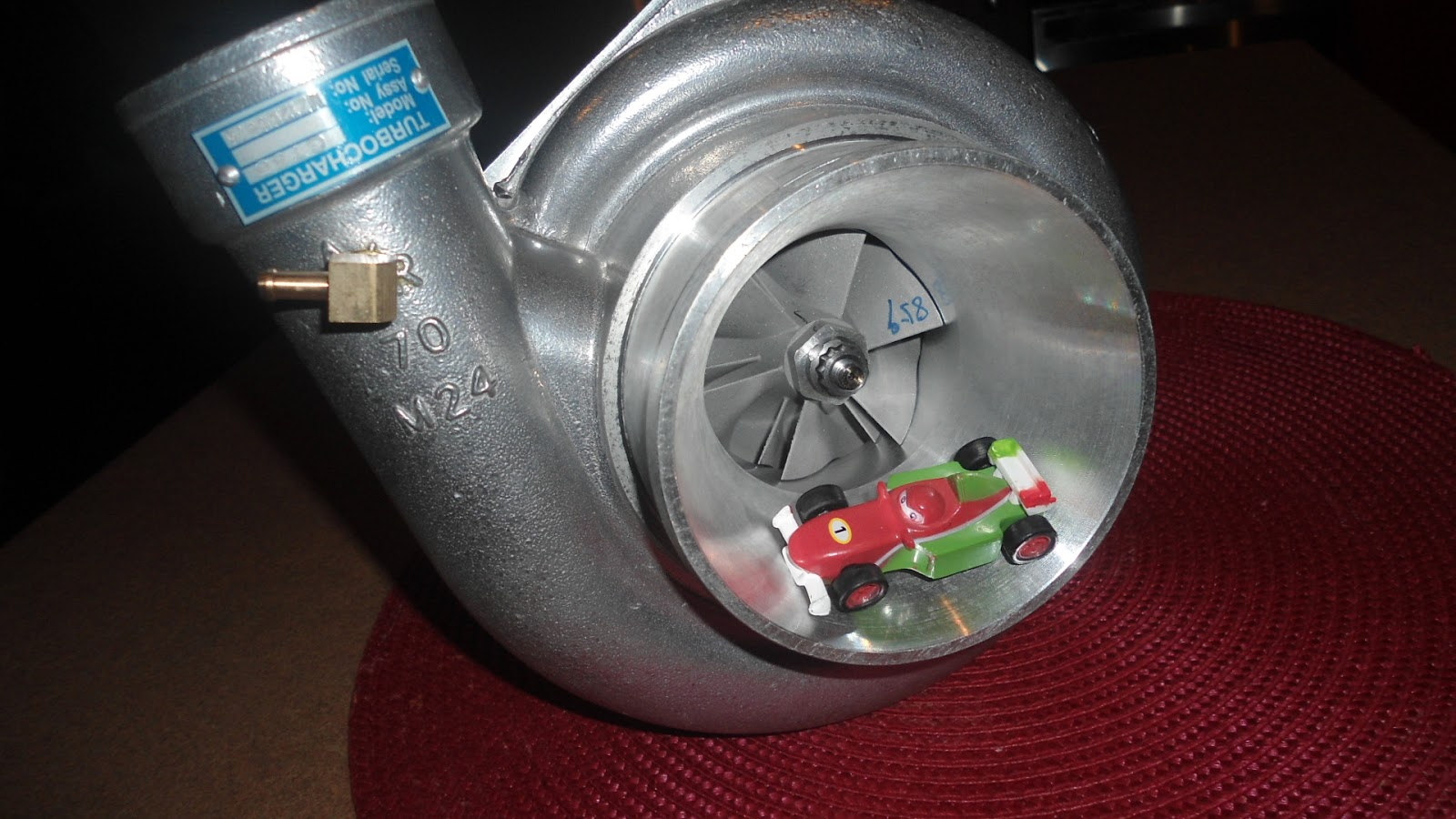

    Good information. I actually have that cx turbo back exhaust in waiting. Only thing I don't like is the fart can on the back.
    I also have CX intercooler, CX piping and two exhaust manifolds, one being the one you posted above. From my reasearch on exhaust systems I am surprised to hear you like it, KAmotors. I know it clears the oil cooler and AC but it does not have equal length tubes. Care to comment?
    The second manifold I have and want to use due to the strength and equal length runners, but need to modify to clear stuff, is this model:
      I also have CX intercooler, CX piping and two exhaust manifolds, one being the one you posted above. From my reasearch on ecxhaust systems I am surprised to hear you like it, KAmotors. I know it clears the oil cooler and AC but it does not have equal length tubes. Care to comment?
      CXracing has a good rep for sure.... cant wait to see if its really all good..not that I doubt but need to see with my own eyes. The manifold CXracing makes (second version) not only clears stuff better but is also to my opinions much stronger then the manifold with equal lenght runners in the pic you have up?!? the manifold is shorter, braced and just looks like it wont break in half...lol... no knock on the full lengh manifold..just my view..

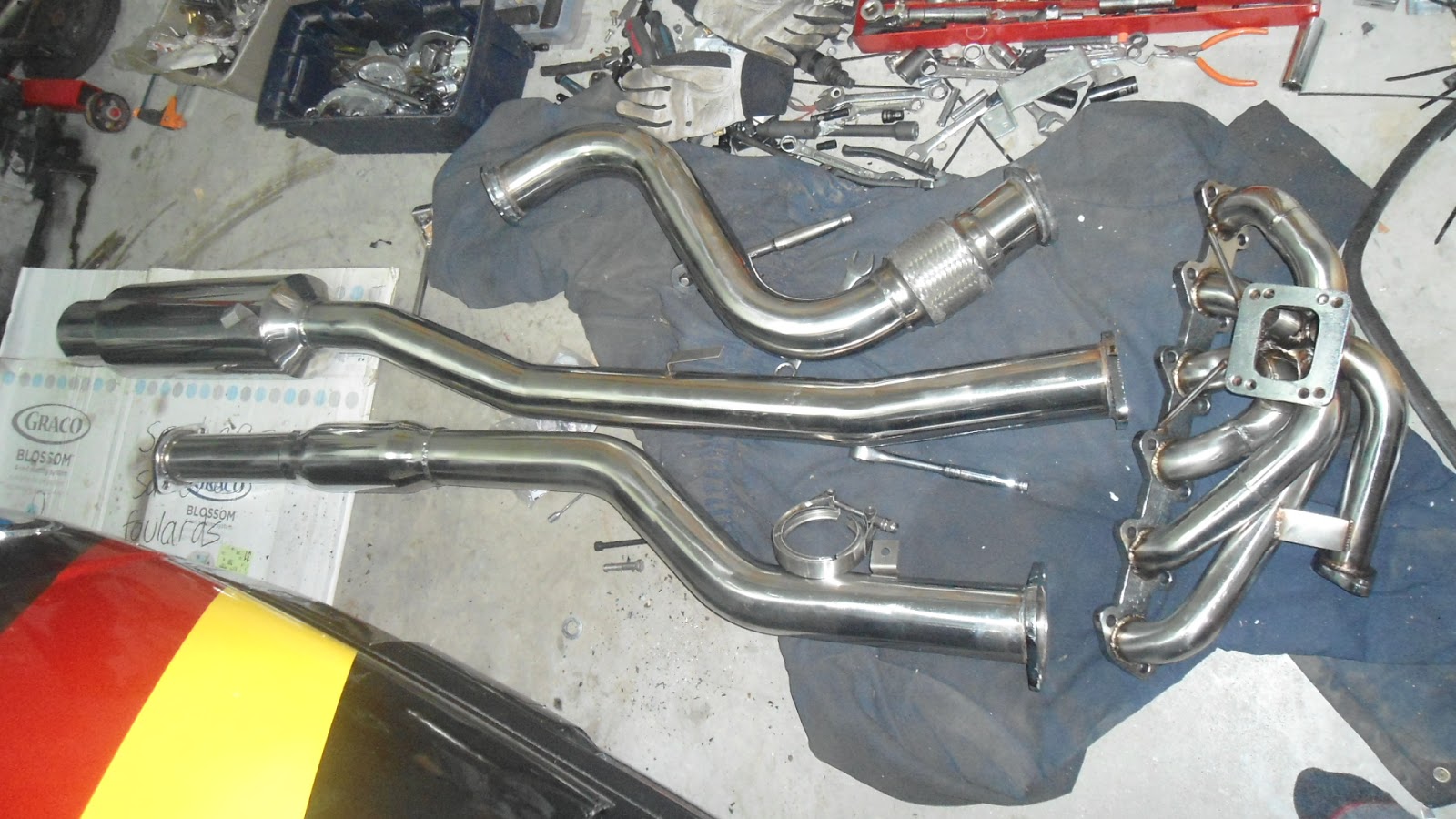

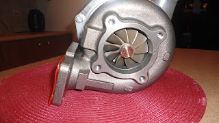

          Surprisingly the ebay manifold is heavier than the cx racing manifold. It is also much larger. Mine has a brace welded onto it for strength.
          The cx manifold has different length runners and does not have smooth transitions, as the flow collects it seems it would collide rather than come together to spin the turbo. The only things the cx manifold has over the ebay manifold is a wastegate provision and smaller tubes that would increase the air velocity and spin up the turbo quicker.
          Just my thoughts having looked at them both.

            The cxracing manifold has smooth ports but not equal length(not that that matters for most). Depending on what dyno you look at I'm making 400+WHP just fine on it. Subaru's use extremely different length manifolds from the factory and work just fine and usually only gain about 10hp with an equal length setup.
            I'm getting boost before 3k rpms and making plenty of power.

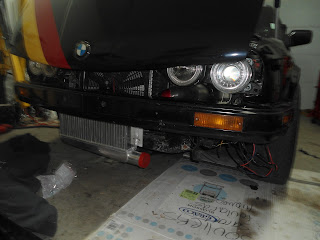

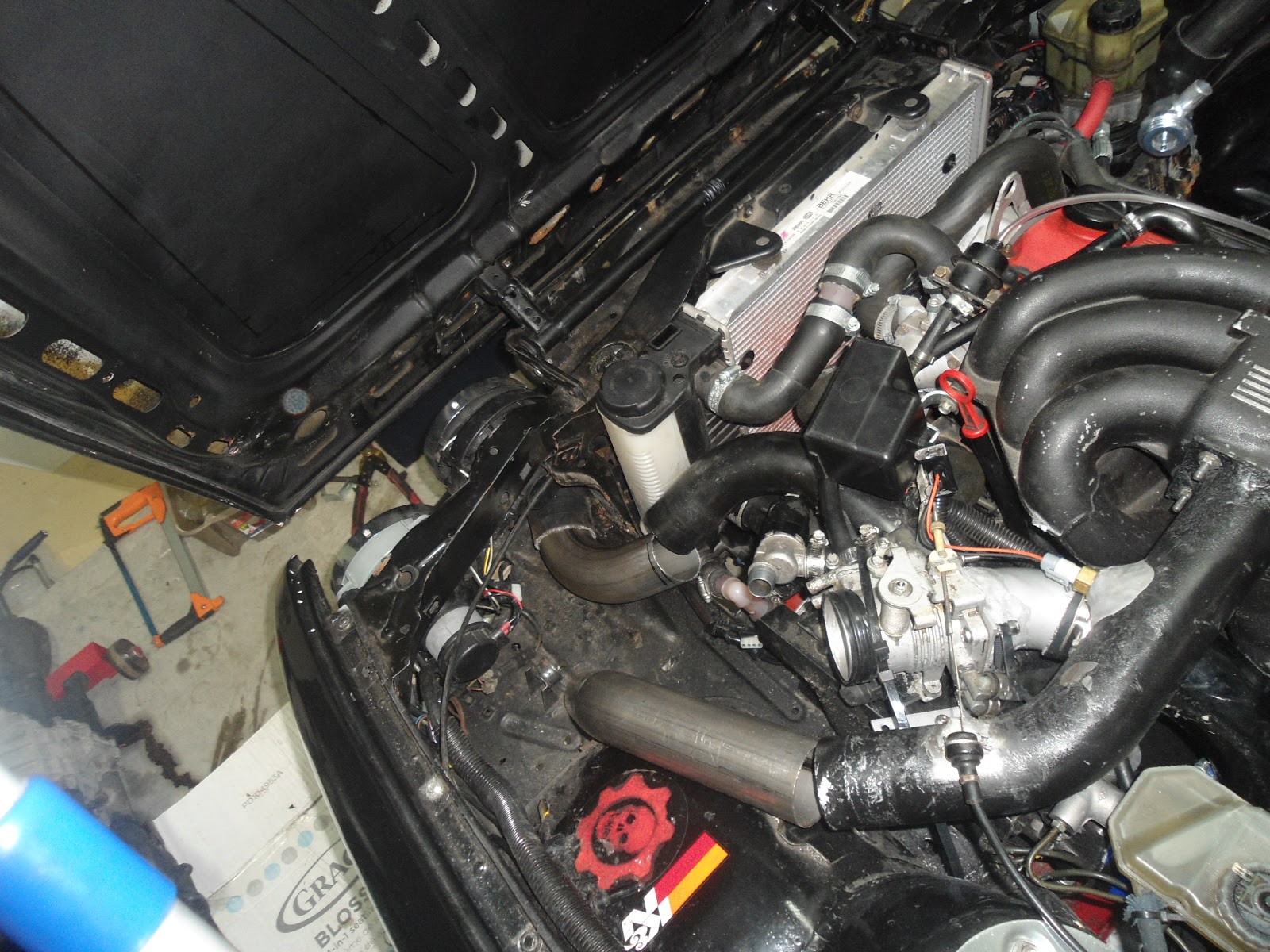

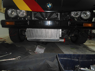

              more intercooler work..
              Lined up and bolted in place to get all the airflow possible...
              started working on the new pipe routing... waiting on all the new couplers, reducers, pipes.. should be here soon...
              Waiting on many parts but tomorrow I should receive all the turbo components cant wait!..

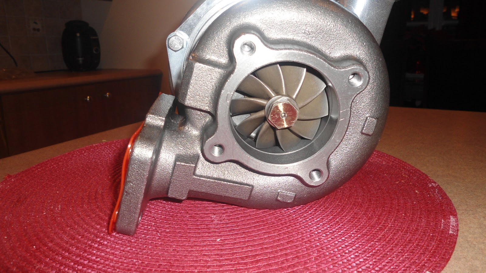

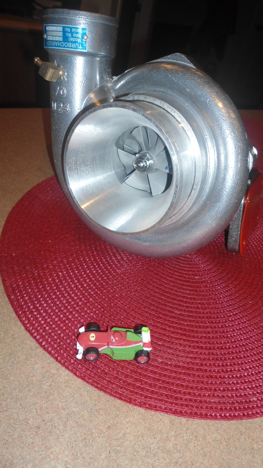

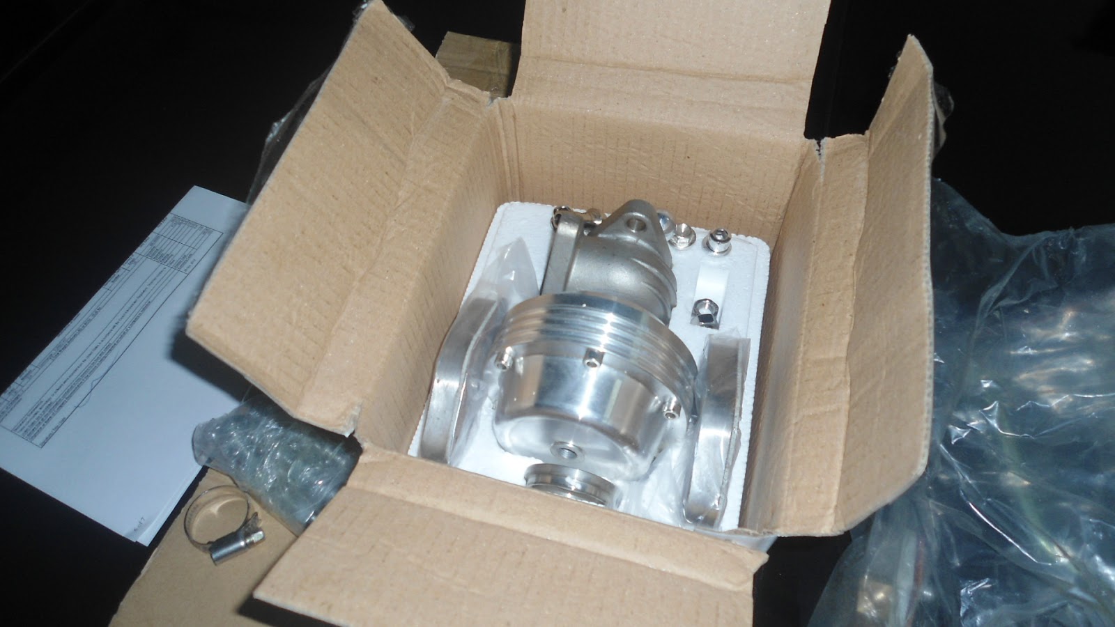

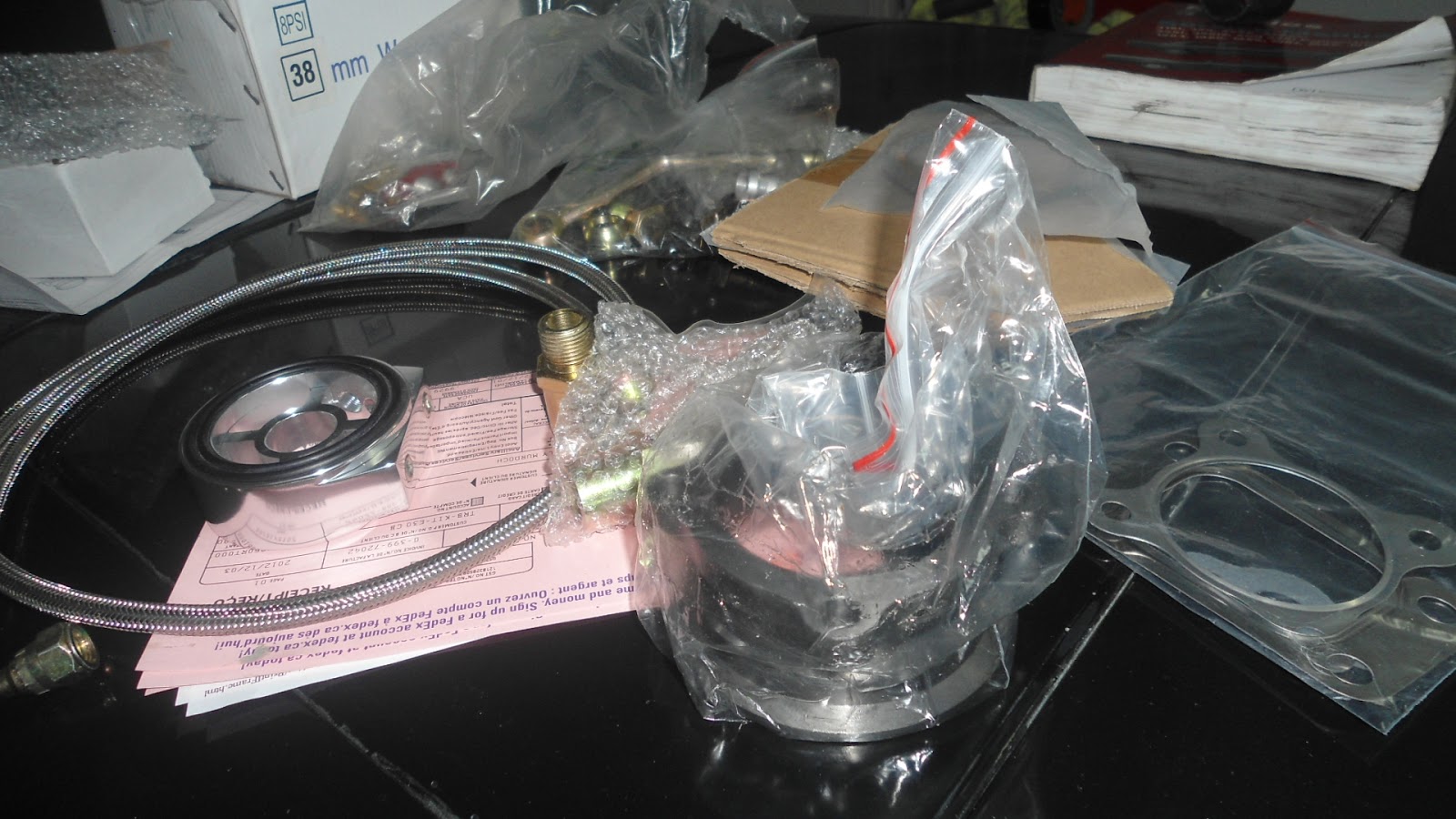

                FEDEX just dropped 2 BIG boxes that weight 65 pounds... :)
                I was very excited to receive the CXRACING turbo kit for the E30 for a few reasons... and one of them I couldn't wait to take out my magnifying glass and inspect the hell out of it to check out its quality construction... at first the metal is very heavy so good sign :)
                I checked the flanges for straightness and thickness, welds, I have to admit that I am very surprised by the quality of all this stuff. I know a good weld when I see one and these welds are very very precise with almost perfect penetration and also the welds are grinded down nice and smooth and haven't seen any pin holes either.. (My old thermal research cat back for my old 91 Mitsubishi eclipse back in the day that cost 1500$ was not as quality as this) so am scratching my head on why people hate on some ebay vendors?!? I cant vouch for others but CXRACING has a very solid kit here...
                38mm ext Wastegate again everything looks quality..
                The turbo is a replica of a garrett GT35 with a A/R 70 ratio its not a small turbo and again I looked it over and cant see anything different then my old Mitsubishi 14B turbo on my eclipse in the day... How long will it last not sure but all it needs to put out is 8PSI for my goal of total 20 PSI with my Supercharger...
                All the fittings, oil lines, and a really well build oil filter adapter to run the feed oil line. All gaskets are metal, every bolt, this is quite a complete kit...all it doesnt have is the oil return line..
                So far I have to admit am impressed with this kit... am not sponsored by CXRACING and didnt get paid to say this...I just wanted to be honest and maybe stop the nonsense that all Ebay stuff is garbage...
                This kit can be bought directly from www.cxracing.com I grabbed it on special on Blackfriday :)
                Stay tuned...
                  Not trying to hate on your stuff, more just answering your question.
                  A good weld shouldn't have to be ground down. You can't tell much, if anything, about the weld if it's ground down completely smooth without cutting into it (assuming you can't see the backside, etc).
                    Actually the welds are nicely tig welded very minimum ground down its more for looks that they did it as its very minimum. I checked that manifold in and out with a light so on.... Its heavy and the bends are smooth as can be.
                    Its very obvious that the chinese products are not all created equal in this case 2 thumbs to CXracing for whoever built this kit for them.. quality and best bang for the buck this kit cant be beat. Enough praises :) time to get busy...I got lots of work to do :)

                          So you decided supercharger will feed the turbo right?
                          Also what are the specs on your turbo? I will have a very similar setup on a 3.0 stroker setup once I get it running right. Same manifold, same exhaust, same intercooler, I just have to decide on fuel management.
                          The turbo I have is similar but was probably an ebay special as the company is 'JDM Sport' and its called a 'T70'. I'm trying to compare it to something and I think its a bit smaller than a garrett GT35R. Probably similar to the turbo you got. Specs are:
                          T70 Turbocharger
                          Manufacturer - JDM Sport
                          Ideal for large (3.0L-6.0L) displacement engines
                          Capable of 25-35 PSI output at peak power performance
                          Wet float bearing
                          External wastegate
                          Compressor Inlet = 4"
                          Intake (ID / OD) = 2" / 2.5"
                          Inducer = 56.2 MM
                          Exducer = 72.9 MM
                          Trim = 59
                          A/R = 0.70
                          Turbine Outlet = 2.5"
                          Turbo flange = T3 [twin entry divided flange]
                          Downpipe flange = 2.5" V-band
                          Inducer = 73.9 MM
                          Exducer = 58.3 MM
                          Trim = 62
                          A/R = 0.84
                          Oil cool system
                          Oil feed = T3
                          Oil return = T3
                          • Denny
                            • Jan 2010
                            • 822
                            #103
                            T70 Turbocharger
                            Wet float bearing
                            External wastegate
                            Inducer = 56.2 MM
                            Exducer = 72.9 MM
                            Trim = 59
                            A/R = 0.70
                            Inducer = 73.9 MM
                            Exducer = 58.3 MM
                            Trim = 62
                            A/R = 0.84
                            Oil cool system
                            Oil feed = T3
                            Oil return = T3
                            Hey I decided to have the turbo feed the blower. But doing it this way the blower will continue to do its job with low end grunt and with the extra 1L of displacement spool that turbo a lot faster. I was told the difference between the GT35 and GT35R is the later is ball-bearing same size. AR70 same as this turbo.
