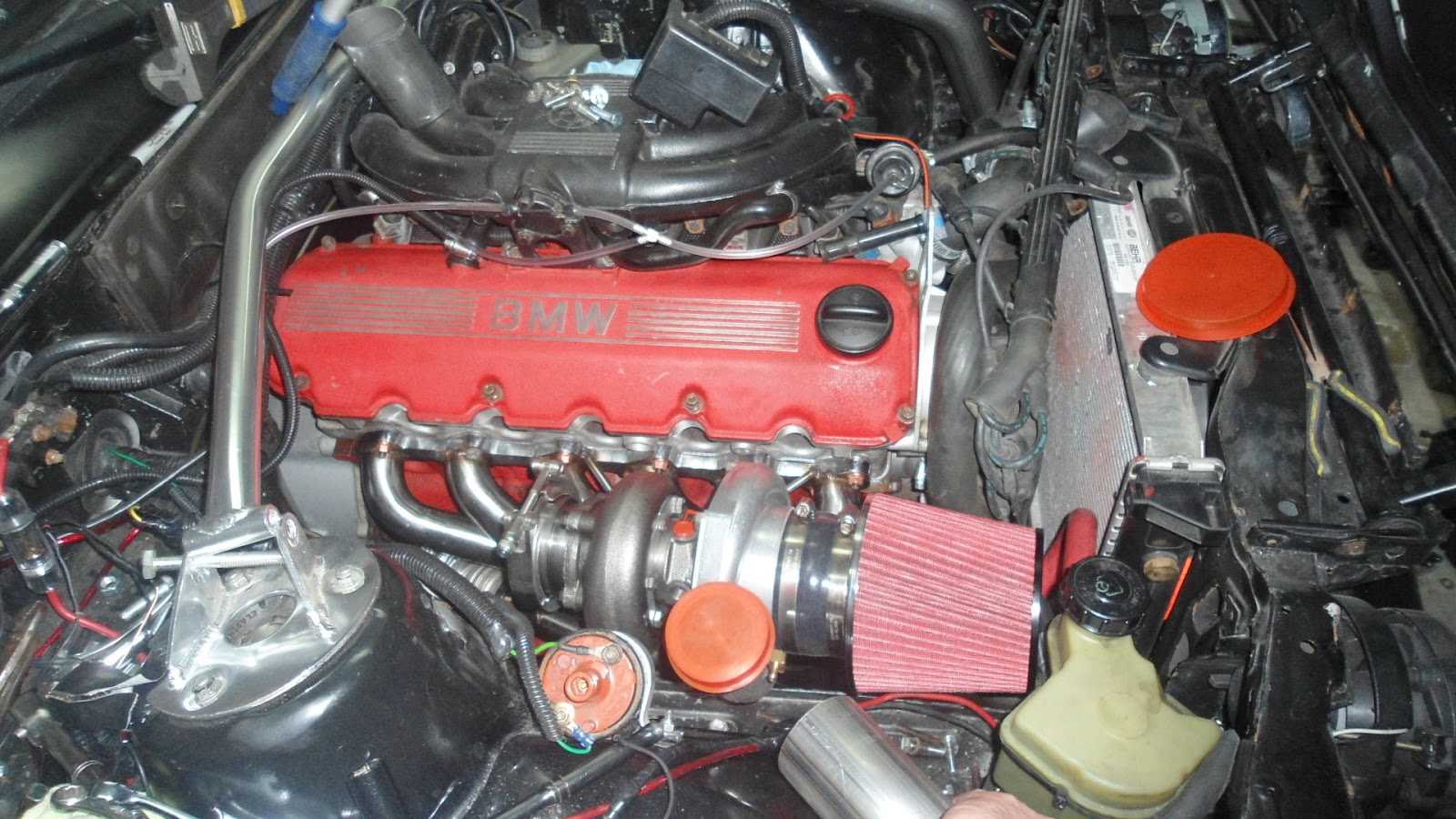

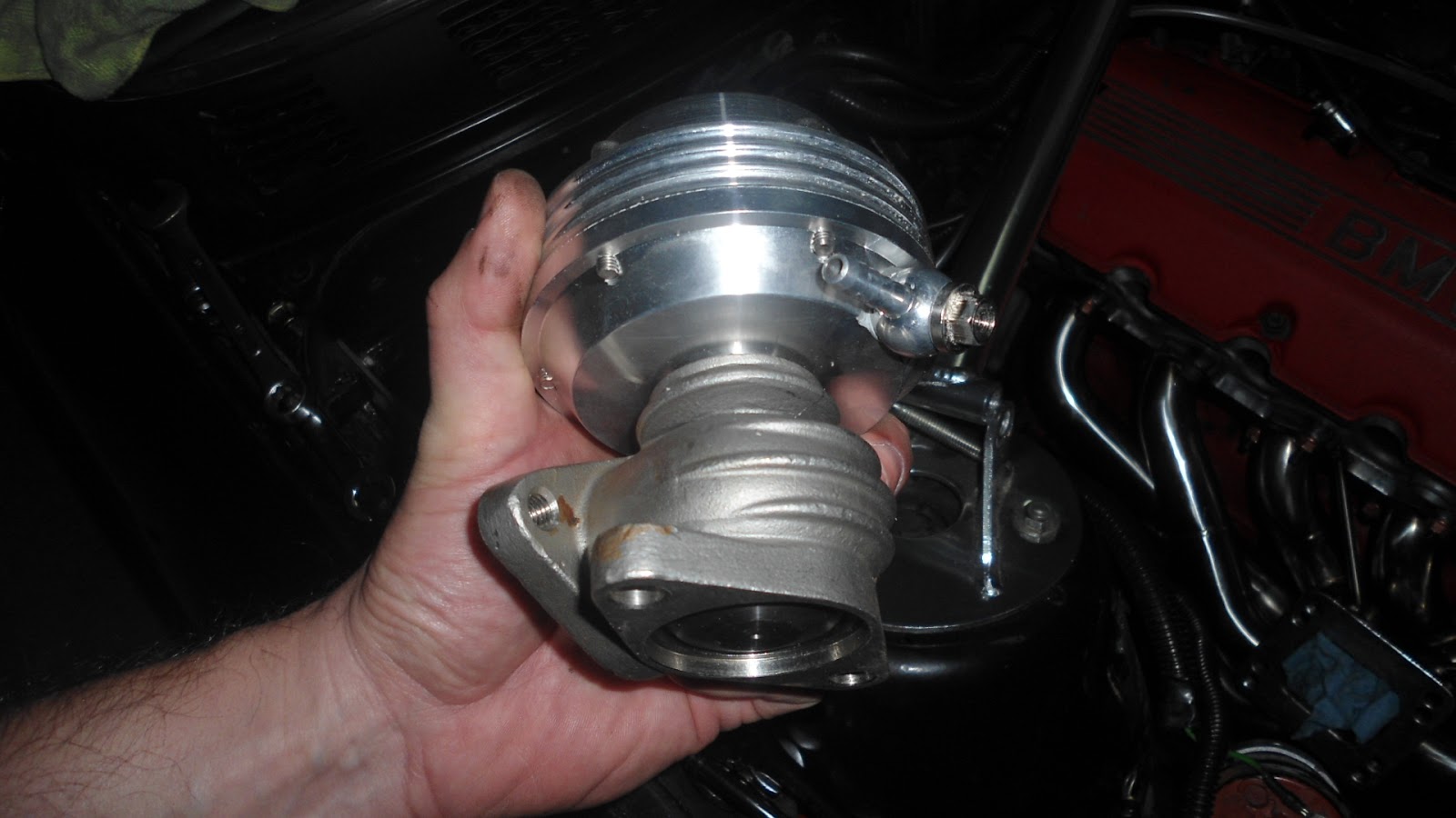

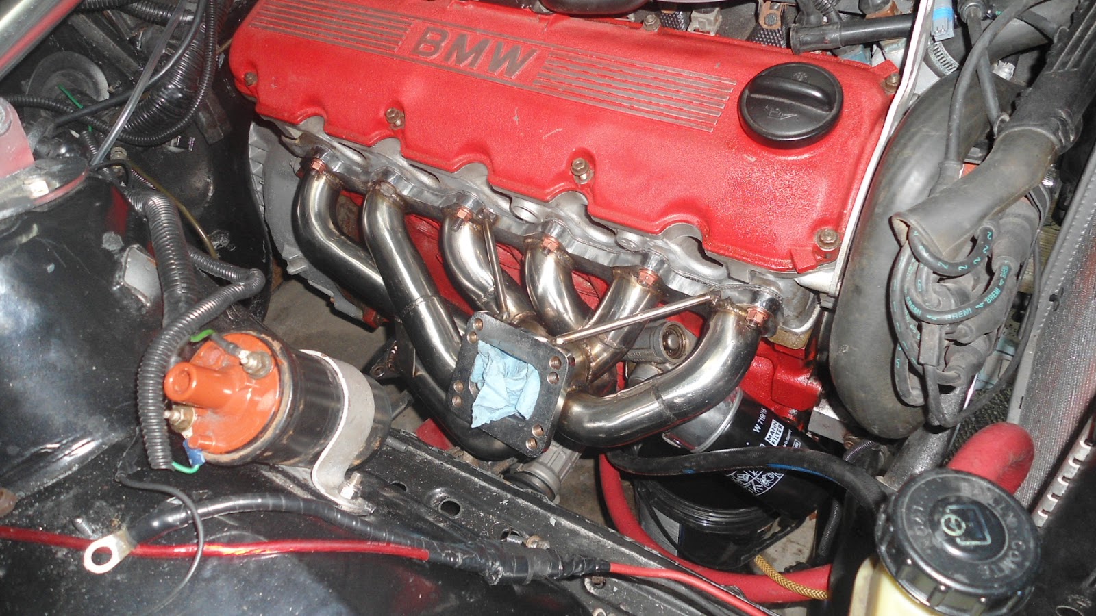

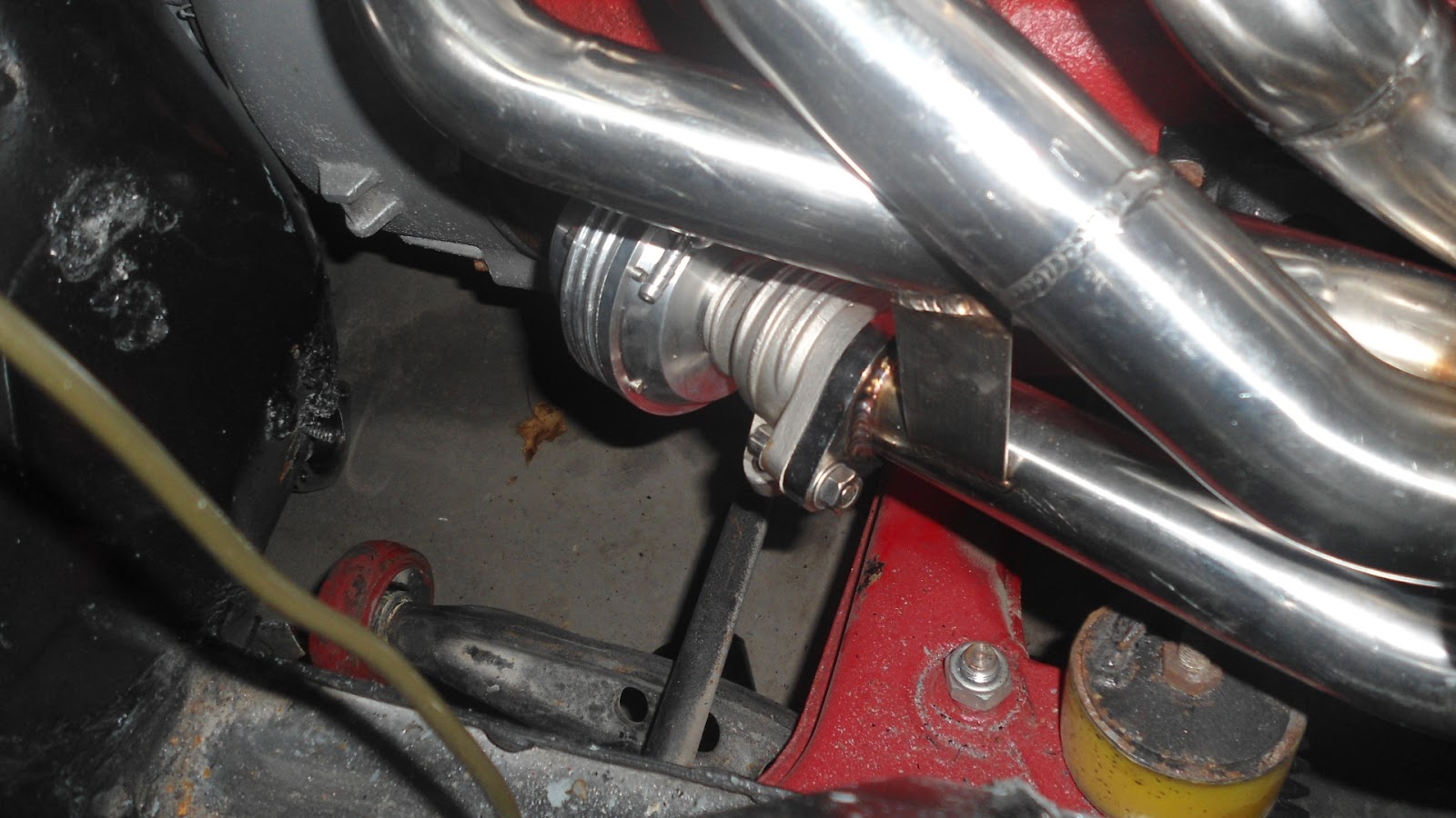

                        After a lot of research the way to make serious power was to go like the lotus in the video (thanks for the link) and the Delta S4 lancia. I will dyno it at a local shop here to tune the timing and tweak the fuel :)
                        I will for sure have some REAL videos of inside and outside as am going to the track so speed is legal there :) am planning on on some slicks as traction is going to be crazy (I had serious issues with my 225/50 with 10PSI of supercharged boost) the low end torque transforms the car into a muscle car.
                        sorry for the long wait time on an update life got in the way lol....
                        UPDATE**
                        Update Project is going forward nice and slow... working on the turbo side of my setup.
                        Received and regasket the oil adapter, welded bolts (dont have a oil cooler), installed turbo oil inlet sandwich
                        clocked it so it fit under the header..
                        manifold installed...bolt holes had to be enlarged as it didnt fit but was very close ...no big deal
                        38mm wastegate installed fitting ready for intall...
                        her it is install with the fitting pointing in right direction.
                        I installed the turbo temp so to clock the housing properly ....
                        installed filter and I will need a 90degree coupler to join the turbo outlet and pipe...
                        so far so good still lots of work but its coming along like I promised a twincharged M20 by spring so stay tuned...
