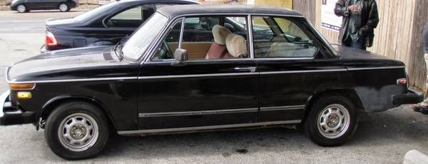

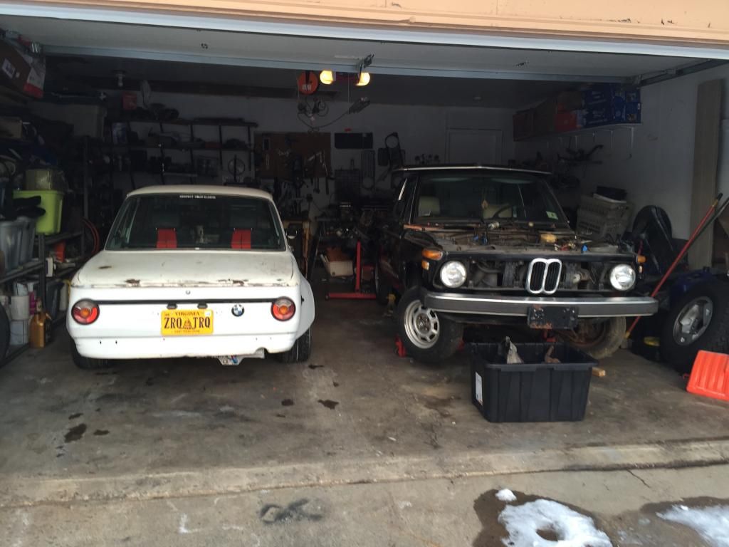

                      Side note I will be picking up another 2002 this weekend! its 76! 4 speed and stock m10. The problem is, it hasnt ran since 2013. My plans are making it into a clean classy daily driver. Picked it up for $800
                      Trust me it stock :yawn:
                      • knuklehead92
                        • Aug 2011
                        • 732
                        #161

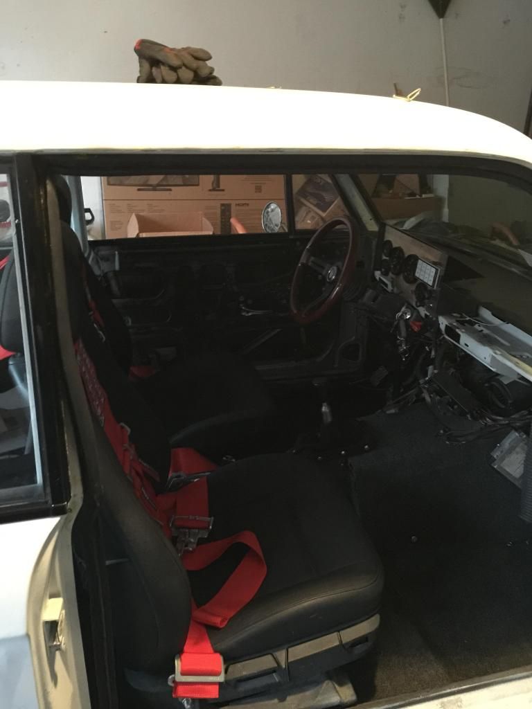

                        current status "grassroots" enough to pass state inspection lol.....

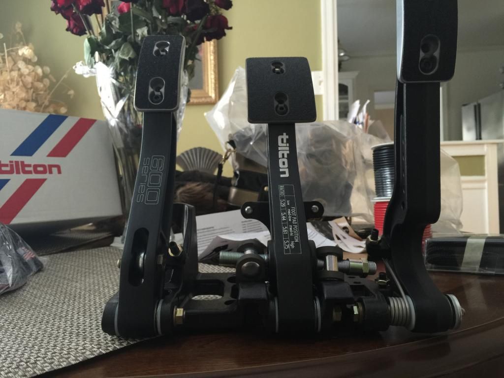

                                this came in
                                my current setup is wilwood swinging pedals and i changing over to tiltons
                                where they sit currently
                                thoughts on miata suspension?
