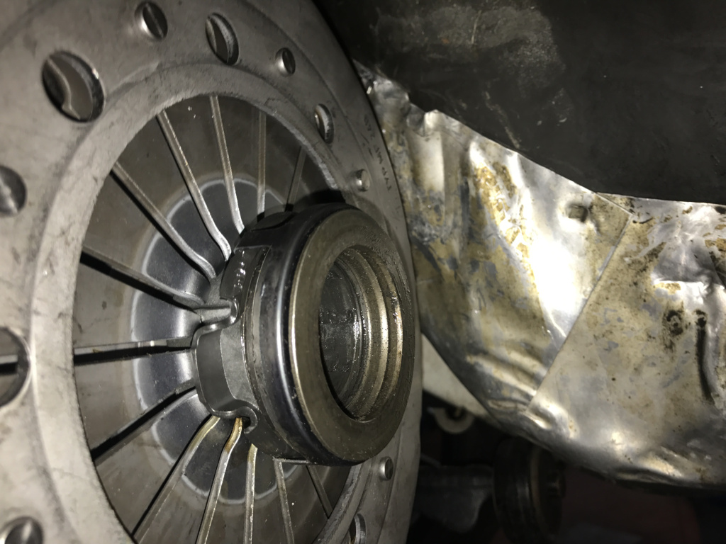

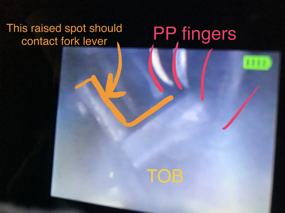

          It's been over 9 years but here I am, I still have the car, and I can provide updates looking back through my notes and photos.

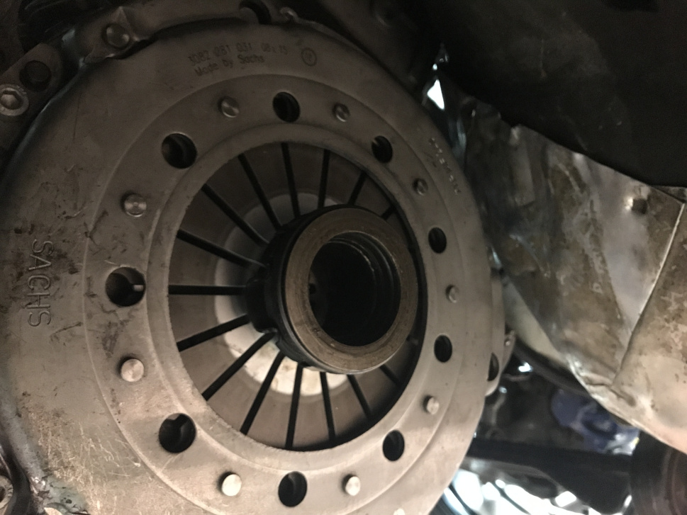

          I think I was embarrassed regarding the issue above with the clutch - it was not a slave issue, it was my mistake installing the throw-out bearing backwards. I hid in shame for 9 years! Just kidding, life has moved on and gotten the better of my free time.
          In the pic below (sweet, R3V can host photos now) you can see what I mean, I stuck a borescope in there to see what was happening.

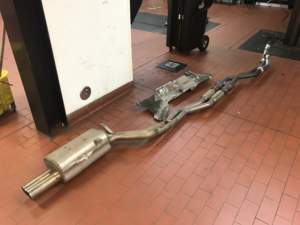

          I really didn't want to drop the trans, so I begged a friend of mine to get it on his lift at work. Here's the exhaust, still in this form today.
          And proof that I'm human. Backwards TOB.

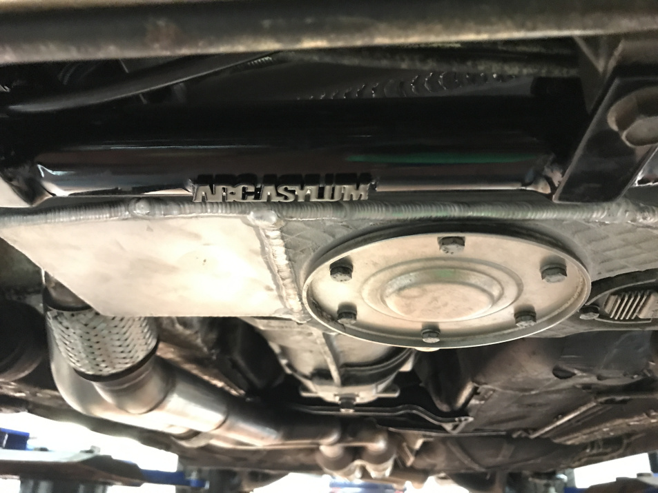

          And a cool pic of the subframe and Tyler's logo.

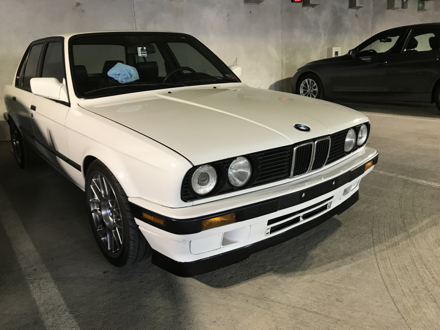

            In 2017 I moved into an apartment and kept the car in the garage there rather than my parents' garage, really didn't get much done but it was driving-ish (more on that later) so I put a few miles on it here and there. My gf became my fiancé in the summer of '17 so wedding planning was happening.

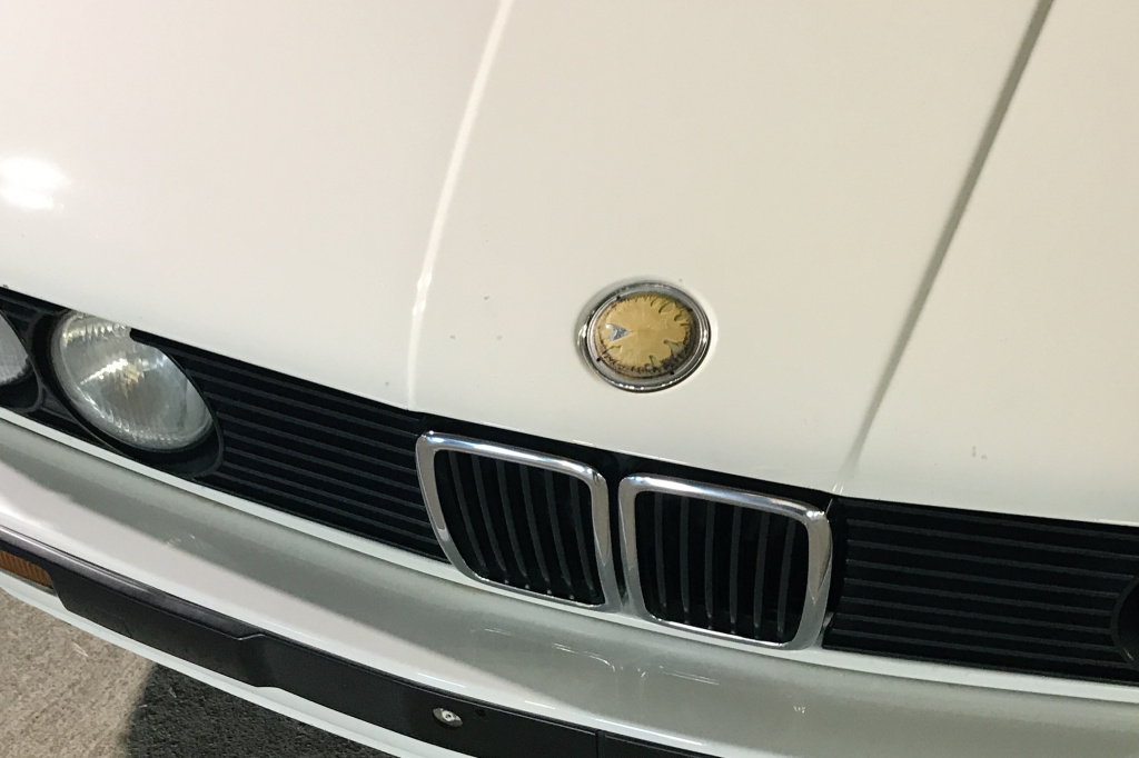

            The hood roundel broke, I replaced it.

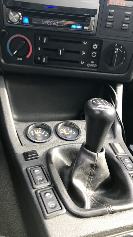

              Browsing through this thread I can't find the specifics of where I got the clutch kit that I installed initially... but anyway, all was not well after attempting to get into gear with the TOB backwards. The clutch disc was bent, and/or the PP fingers were messed up, and I was not getting complete disengagement with the clutch. I couldn't really drive it much. This begins the phase of paying professionals to help me make the car enjoyable. I took it to Bimmerbuddies in central PA, I really no longer had the resources to DIY a clutch job but I felt it was worth spending the money on having it done for me. So I ended up putting in a new Z3M dual mass flywheel, Sachs clutch kit, and pilot bearing for good measure. They also resolved some other issues, including a replacement of the Vanos solenoid pack and replacing the subframe bushings, CSB, and for fun I went ahead and got an E90 "BMW Performance" shift lever. That last one really put a smile on my face, amazing feel and while the photo might not show it, must have taken over an inch off the shift knob height.
