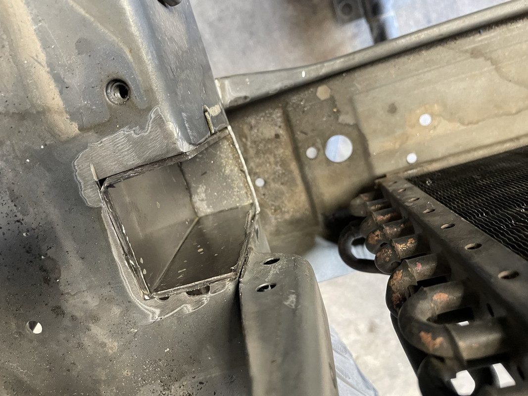

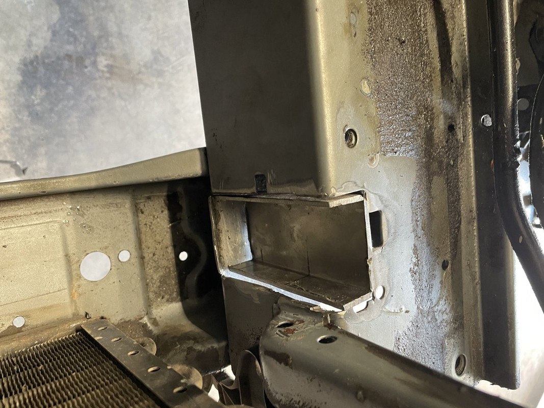

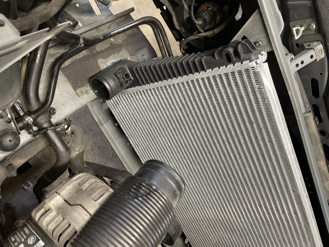

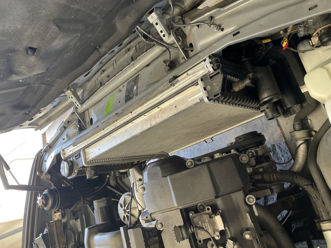

              For anyone out there who cares a factory intercooler from a volvo XC 90 (2005) will slip right into the engine bay of the e34. No matter what you do there is no freaking way to get an intercooler into the lower bumper without hacking the car all to pieces. (not ideal)
              In order for this to work you have to sack up and notch the chassis rails.
              [url=https://postimg.cc/Q9x7fYRc]
              After some light fabrication work some flappy wheel and a little paint we have the final result.

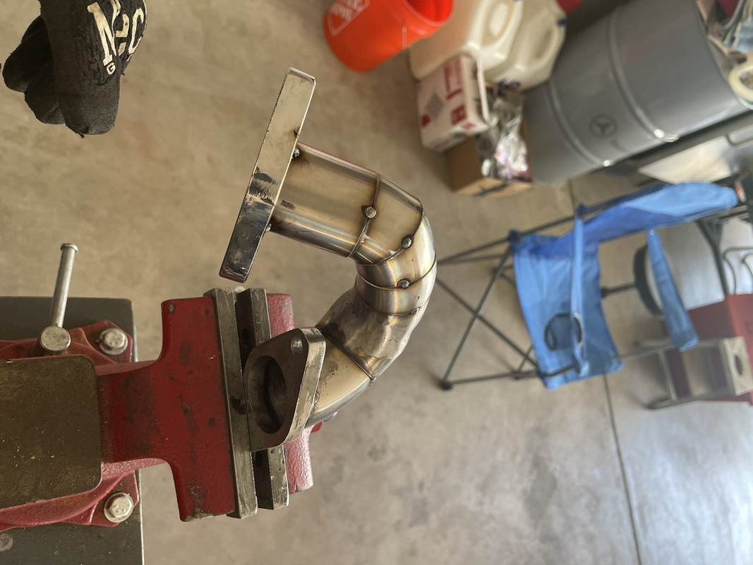

                We are going externally gated on this one. Mainly because with the bottom mount set up there is simply no room for an internal waste gate on the turbo.
                Pie cuts
                And we end up with this:
