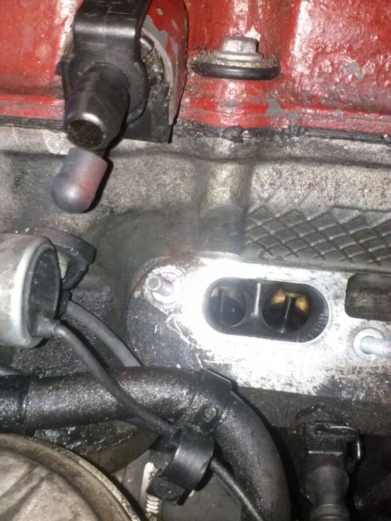

                  Yes. The US rep for Jenvey is local and we asked them to make these. Traded my wife's mini van for an e36 just for these lol. We are in the design stages for m20 kits, they already made some for the m10 (guess they are popular in the UK)
                  Here you can see the first casting being test fit last summer...

                    http://www.e30tech.com/forum/showpos...&postcount=127
                    Cool.
                    I understand that sometimes it just won't go where you want it to go.
                    But I also would have thought Jenvey of all companies would have options to put the linkage in the middle of the array or other such tricks to accommodate potential packaging conflicts.

                      They could make custom units, but these are off-the-shelf throttle bodies (hundreds of them in stock). We wanted them to be affordable as far as aftermarket ITB's go. Also, as the pic suggests, there's very little room down close to the head, would be some trick setup to get 45+mm throttles in there.
