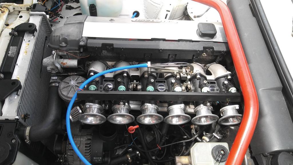

            #215
            Stock booster...

              #216
              tite fit.
