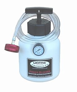

        Buy one of these for bleeding hydraulics, save your thigh muscles for something fun and female.
        http://www.amazon.com/gp/product/B00...GQRD625N5WNA3N
          Something something I am saving it for marriage?
          Or at least I tried. Sort of.
