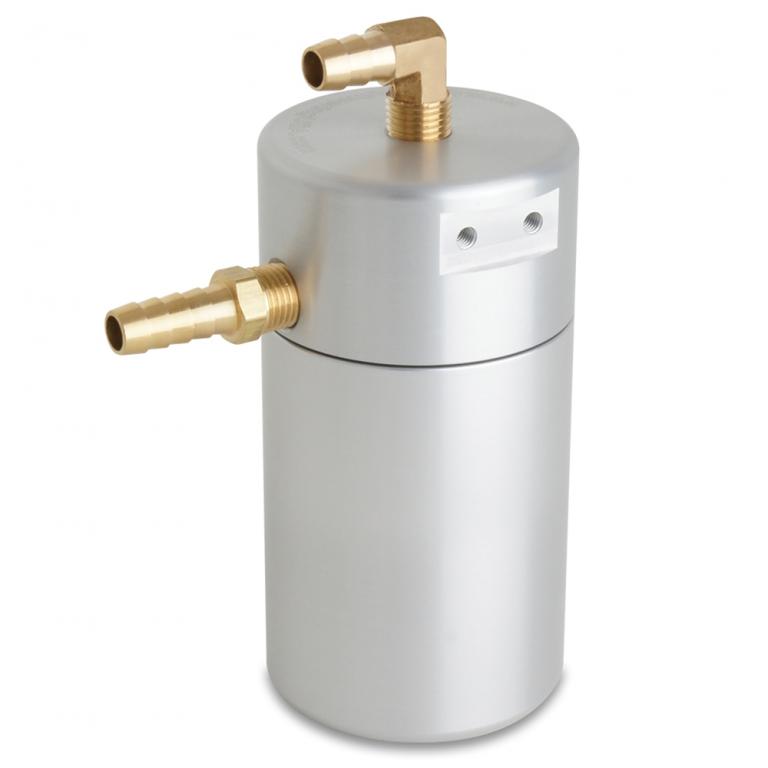

                  Next up, which might be a larger problem is what I think is "engine blow-by". There is oil blowing out of the filter coming from the valve cover vent. It's not much, but it is oil and does concern me. I know this is a new engine, and the piston rings should have theoretically seated by now. I spoke with the engine builder and told me to give the head another 400 miles of "breaking in". He also suggested that I pull the valve cover and see if the passenger side of the upper timing chain cover for leaks. He says they are usually hard to seal up and I may have a leak there. Not very reassuring, but I'll check it as well. And if it is leaking, then what? What are my options?
                  Photo of leaky valve cover vent filter:
                  You can see the oil splatter below and on the filter itself. I'm concerned.

                    A breather filter on the valve cover will drip oil even on tight engine. That originally had a hose going into the air filter housing. I'm not suggesting the amount of oil leaking is not excessive however.
                    Cylinder heads don't break in. Piston rings do, are they new?

                      If you're venting to the atmosphere, your best and environmentally friendly fix is an "Oil-Air Separator", or oil/vapor separator(ovs). In from your valve cover, out to a fitting on your air filter backing plate. It will either need to be drained periodically, or there are versions that use a smaller vacuum size hose to return separated oil to a nipple on the block or pan. Summit Racing, lots of people carry them in different configurations but all do the same job.

                              I bought one of these (unpolished). Thanks for the suggestions and advice.
