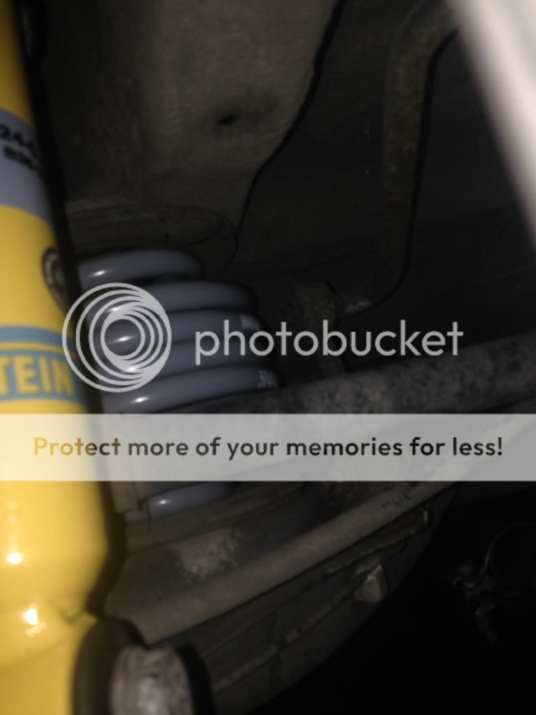

                            #58
                            Well, it looks like I need to keep a better eye out then!
                            Also, installed the H&Rs tonight and the rear is ridiculously low. Why the hell are these coils binding like this? Please excuse the horrendous picture.

                              #59
                              Did some investigating.
                              Turner sent me 50404.55s in the rear, which are completely wrong for the iX. The proper iX rear spring is blue and is a 19.03. Thankfully the fronts were the correct spring.
                              Oh, and 3 miles after installation, my front passenger axle grenaded which was a pleasant surprise. What would an iX be without stupid issues, right?
