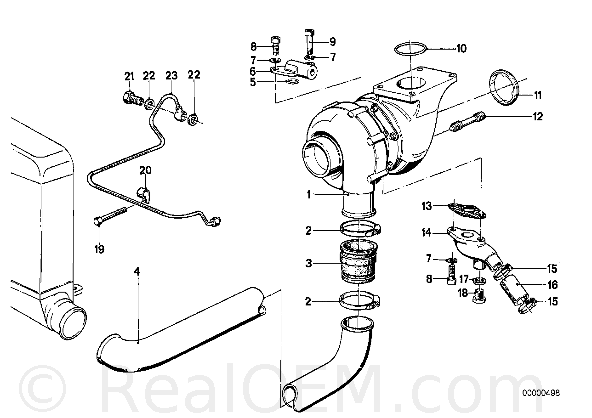

                      Also on the docket was to "create" some bolts for the turbo to mount to the manifold. When I bought the complete m106 system, I couldn't find any of the 4 bolts that I assume we're meant to attach the turbo. And strangely, realOEM doesn't list any.
                      So my solution was to use some of the stock exhaust studs, washers, and nuts to build some bolts. I could have kept these as "studs", but frankly studs are a PITA to use and I didn't see any point in using them as such. It would have made the assembly of the turbo and manifold significantly more difficult to do given all the tight clearances.

                          The bolts are #6 in the image 11 65 1 273 042. They are $38.61 ea lol. Looks like BMW won't sell you them either since its a gray market bolt and they are douchebags like that.

                            Originally posted by kronus
                            studs have some mechanical benefit in that they're put into blind holes until they're tight, and then not fucked with, so the possibility of pulling out the threads or cross-threading the stud is low.
                            so, uh, be careful :)
                            Yes I'll be careful :) Honestly studs make it very difficult to install or remove the turbo, since you can't get any torque on them. I'm more worried about only engaging 3-4 threads on the turbo end and having a whole bunch of threads pushed up past the nut than I am about cross-threading. The long sleeves in the manifold that the studs go through make it nearly impossible to cross-thread.
                            Shit, your right. I've looked at that diagram 100x and never noticed them before
