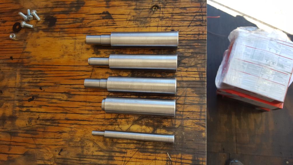

                      I got a set of zf320 service tools made for free through work. l also might have a bunch of other little stuff done while I can.

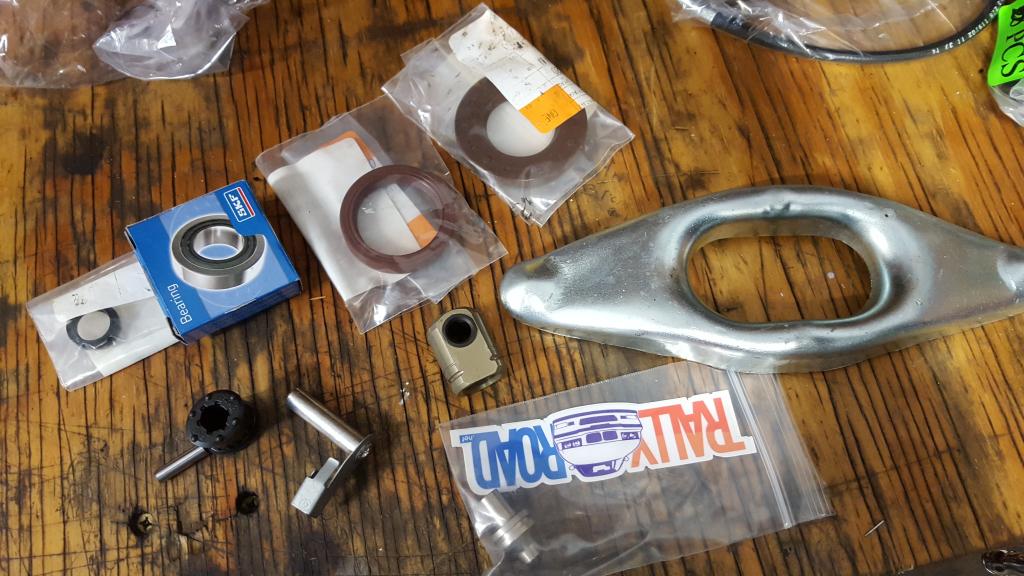

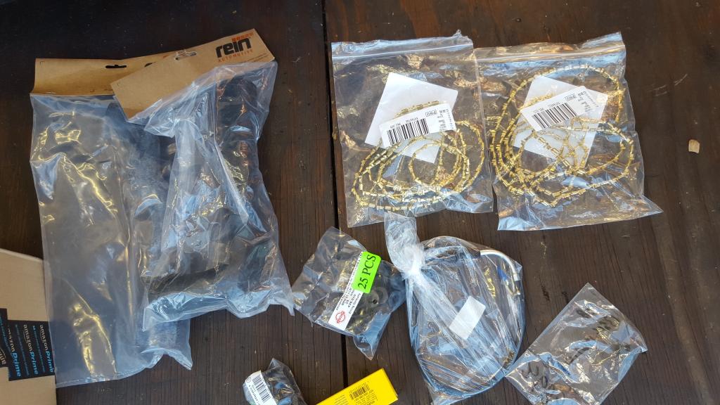

                      A bunch of little odds and ends I ordered during the week to take care of a handful of little issues.

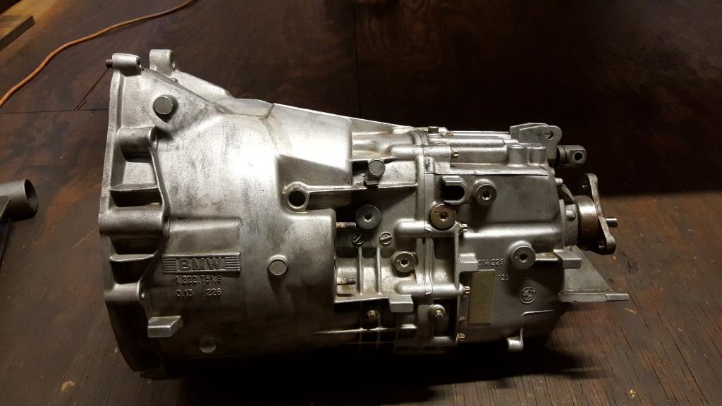

                      I was reorganizing and cleaning up the garage and found basically a full set of seals, bushings, throw out bearing, pilot bearing etc. for a zf320 trans I forgot I bought like 2 years ago which was good timing.....

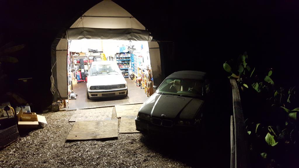

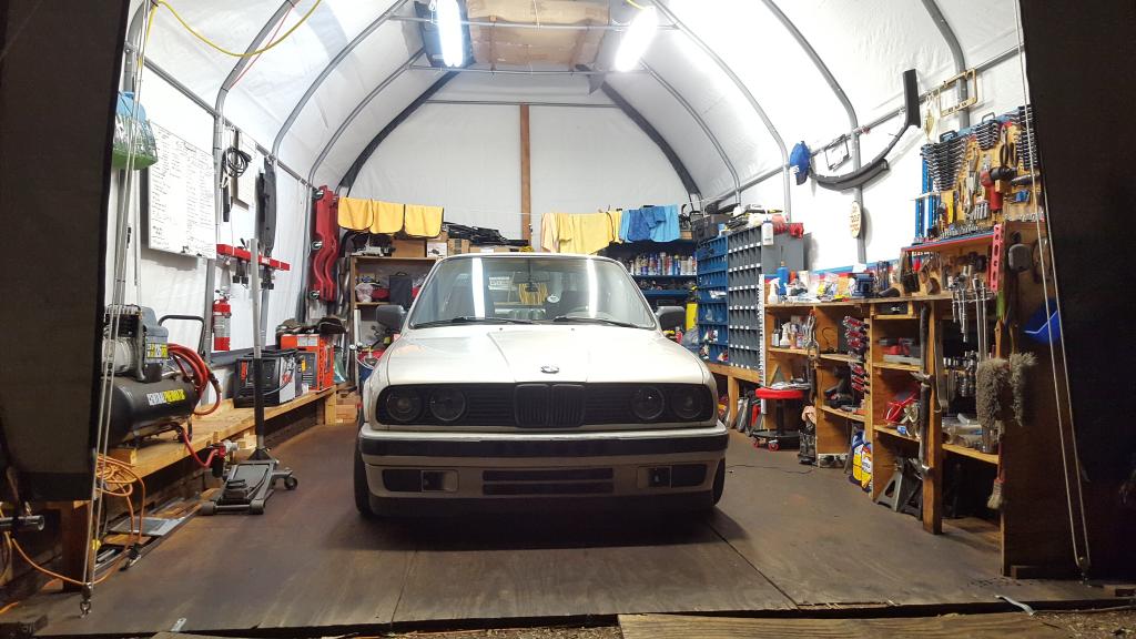

                      The e36 got kicked out of the garage. That can mean only one thing.
                      We gunna do werk.

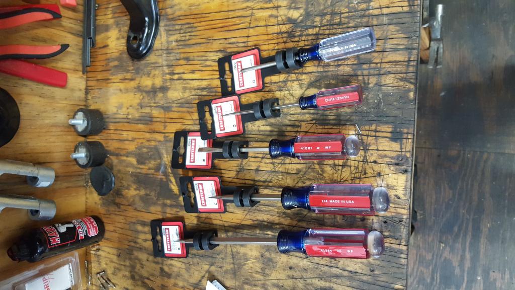

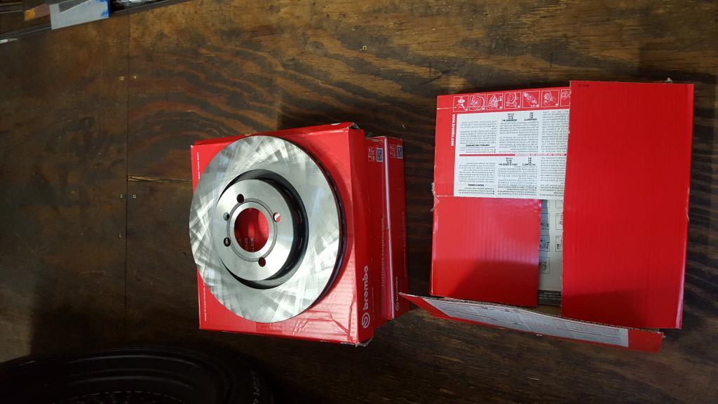

                        I love the sears/craftsman warranties. A bunc of my screwdrivers were a bit worn out from hard use/abuse. Replaced no questions asked.

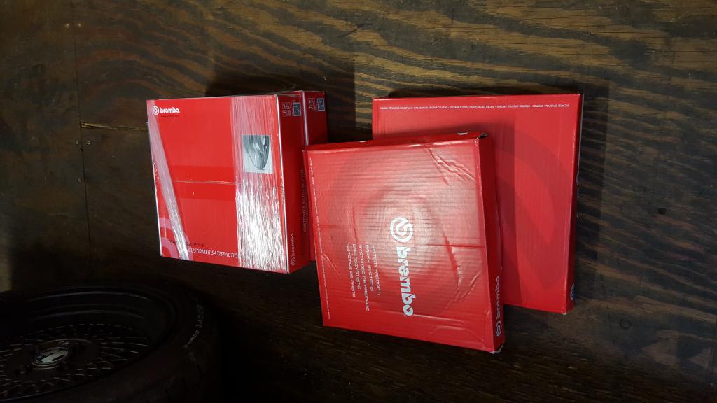

                        Brakes?

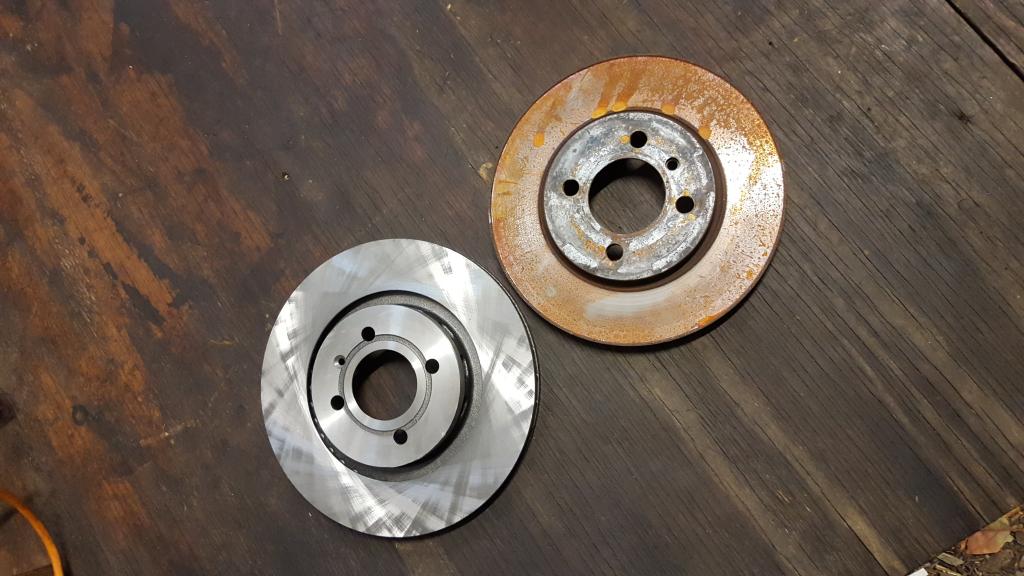

                        Yes, brakes.
                        280mm VW corrado rotors :)

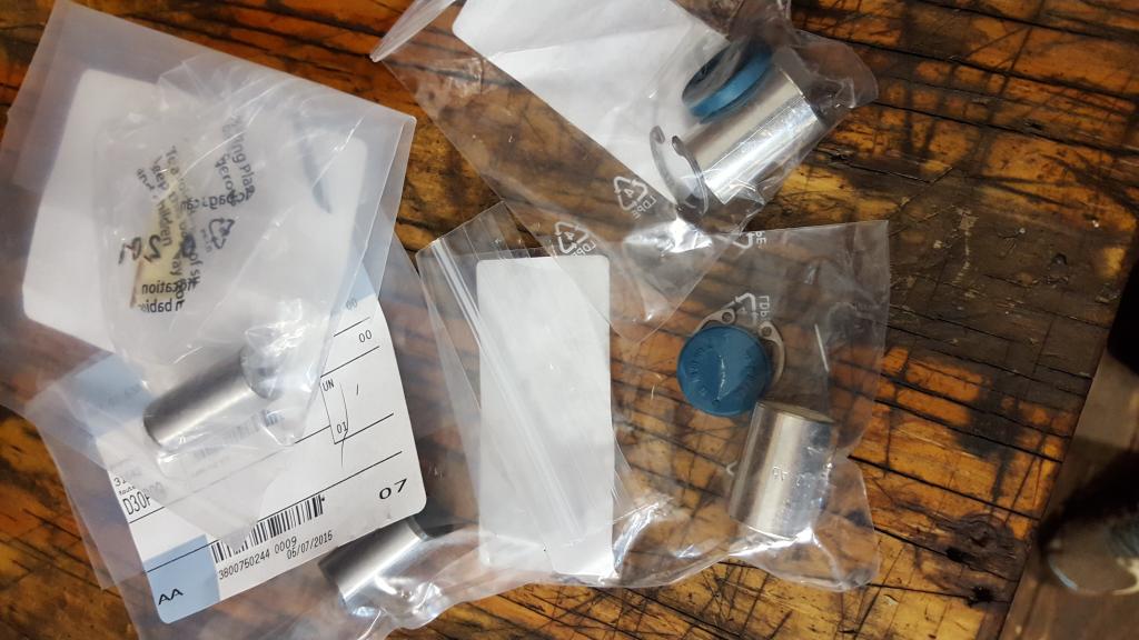

                        5th and reverse detent pins for a zf320. All these parts and tools for a zf320 can only mean one thing.

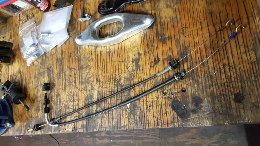

                          So my g260 hasn't been feeling too good lately. This past week felt like it was getting worse. Saturday morning it started grinding gears, popping out of gears, and sometimes I couldn't put it in gear. It was also making some nasty noises for the last 1.5 weeks. I was starting to plan on replacing it, but didn't expect it to happen so soon. Well, I got caught with my pants down. Luckily there were a few available local. This one has ~112000 miles on it and needed the 5th and reverse pins done (parts came from the PO). If I could've planned this, I would've done all of the serviceable pins/detents. Oh well.
                          E30 throttle cable on top, e36 throttle cable on bottom. E36 cable looks like it will be a much better fit for the obd2 throttle body. I currently am using an e34 cable. It's way too long. I don't know where the information came from to use the e34 cable - it's way way way too long.

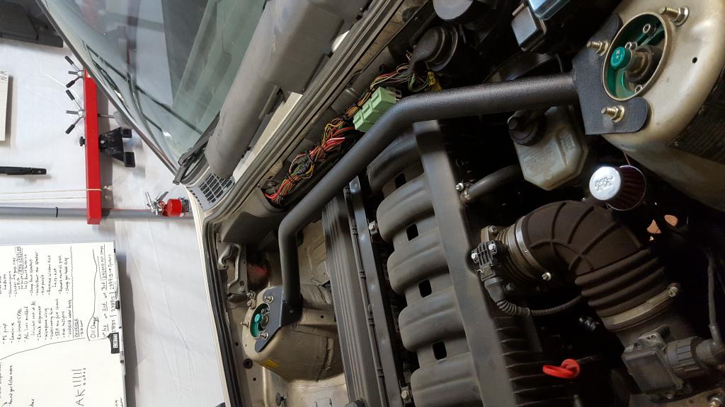

                          Also picked up a strut tower bar at socal vintage. Thanks Andew at IE motorsports!!
                          I am getting annoyed using the galaxy s6/android to mobile upload pictures to tapatalk. The ios app was better for that.

                                nice! getting ready to do the shift pin mod in my ZF also.
                                I have the parts, just no time.
                                Let us know how it goes!
