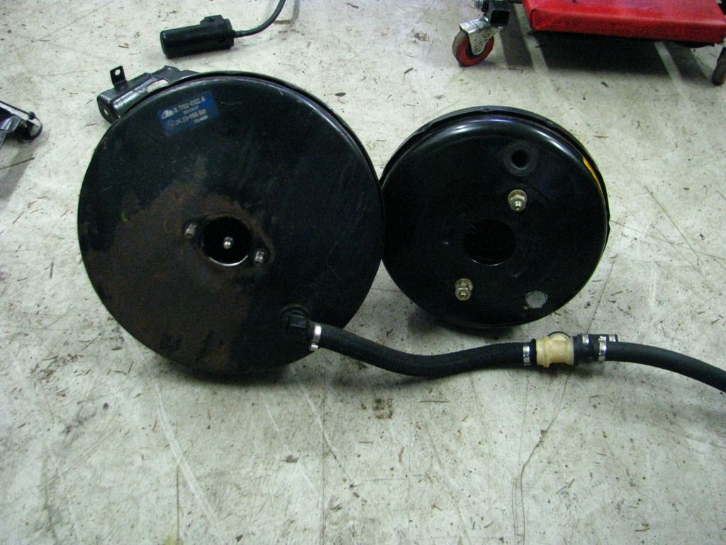

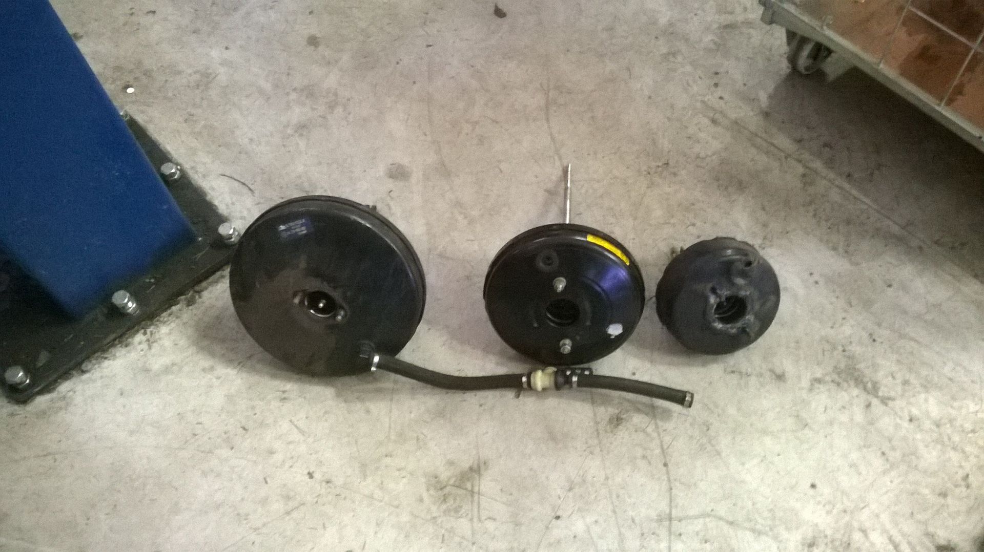

      also a slight curve on the runners doesnt hurt anything at all should you not want to use a smaller booster, clio booster is very common in the UK
          yeah I'm trying to find good one atm ;)

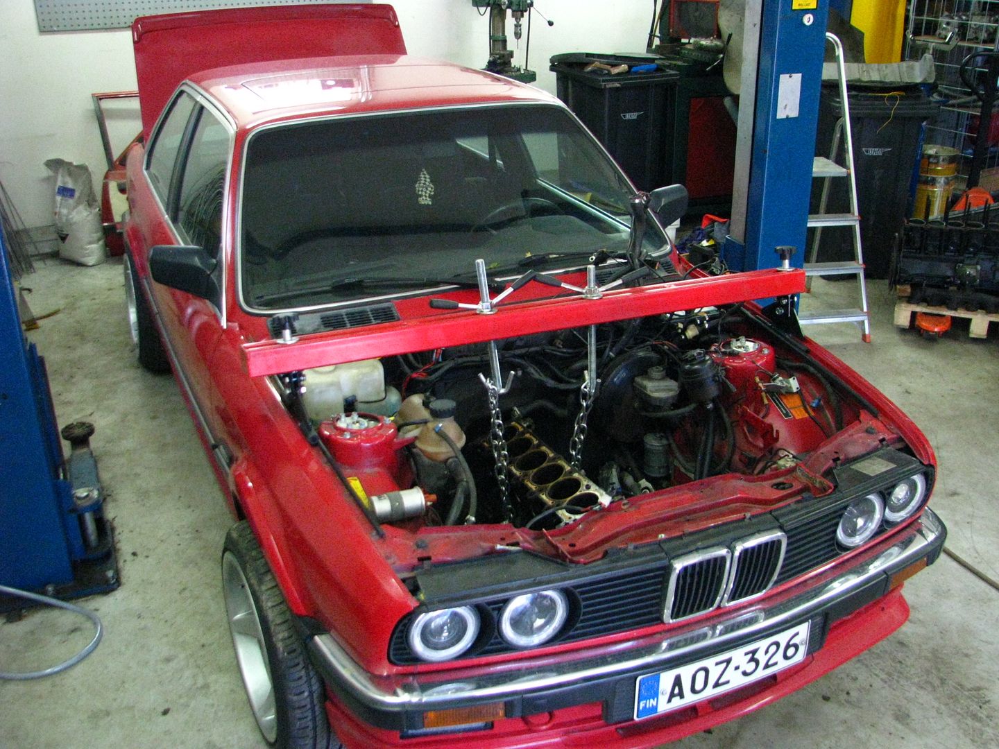

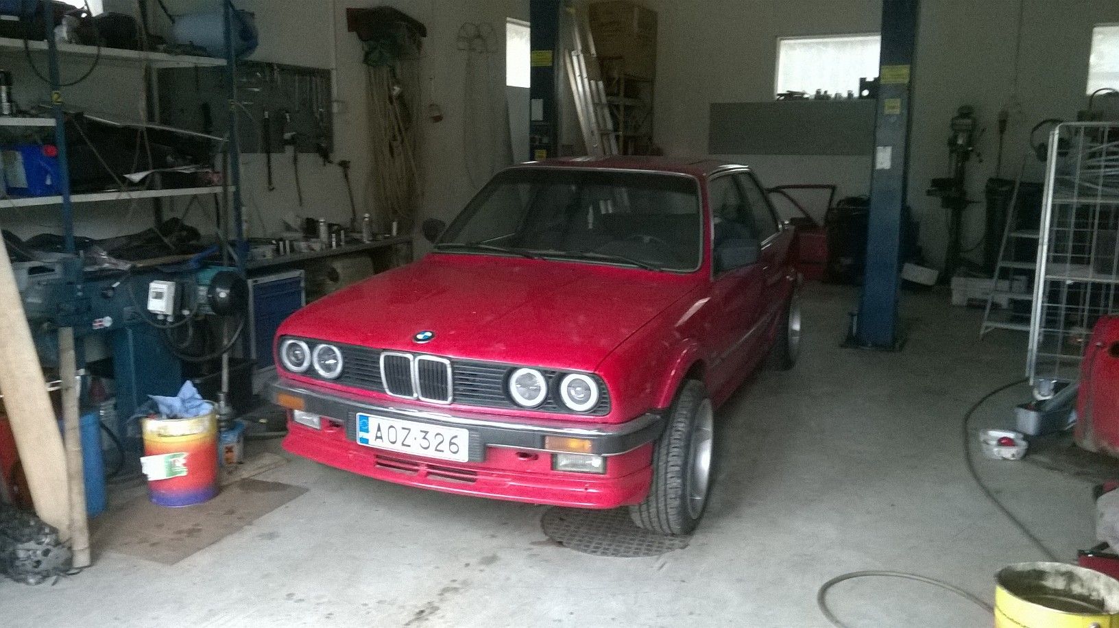

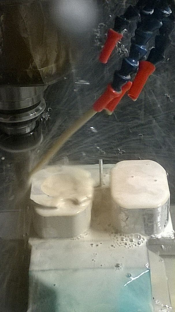

            Some milling with higher cut speed
            Time to get this baby inside the garage ;)
            lot to do

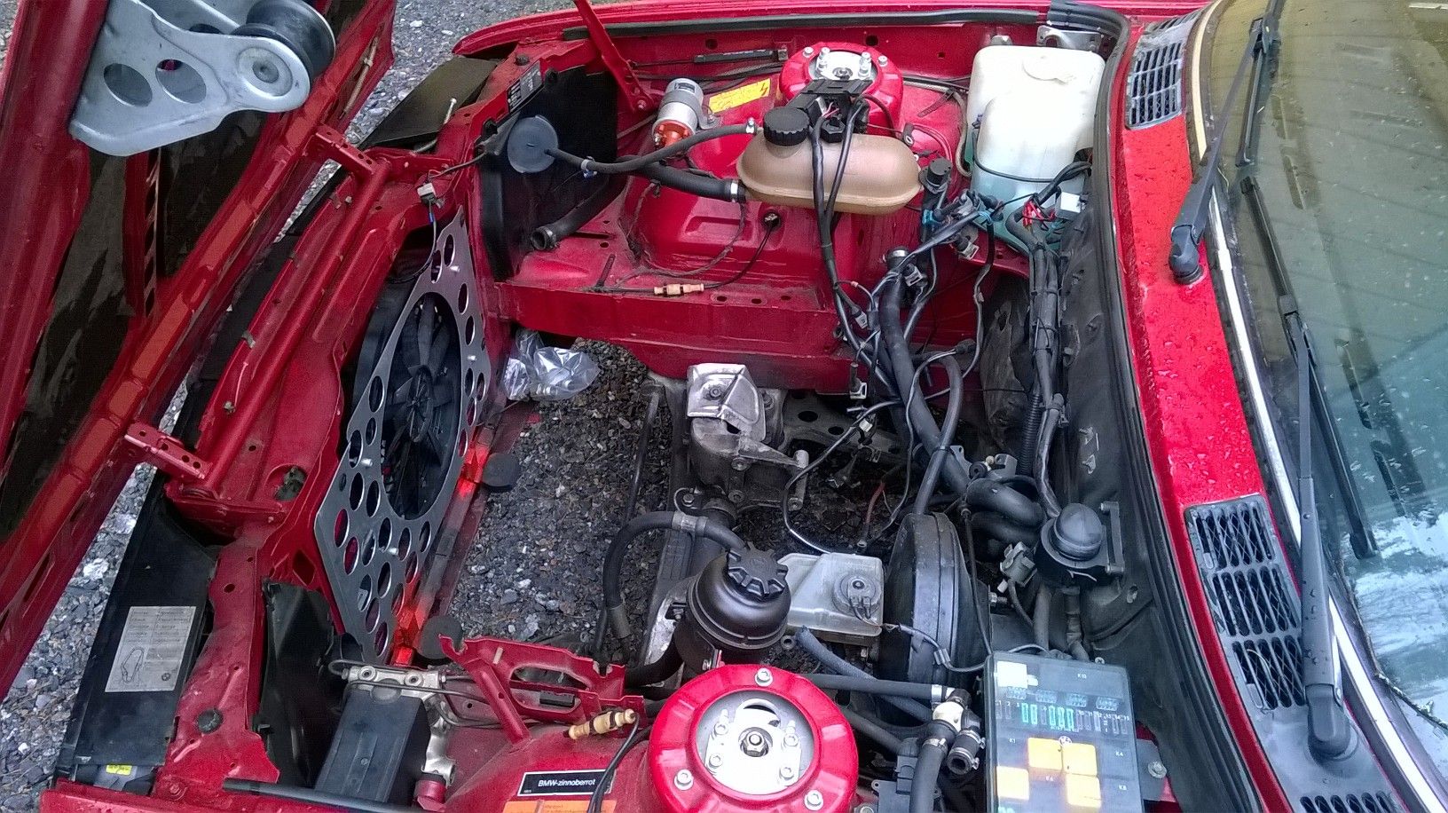

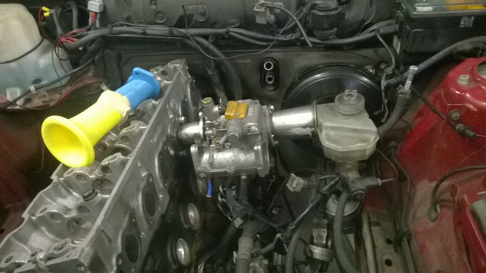

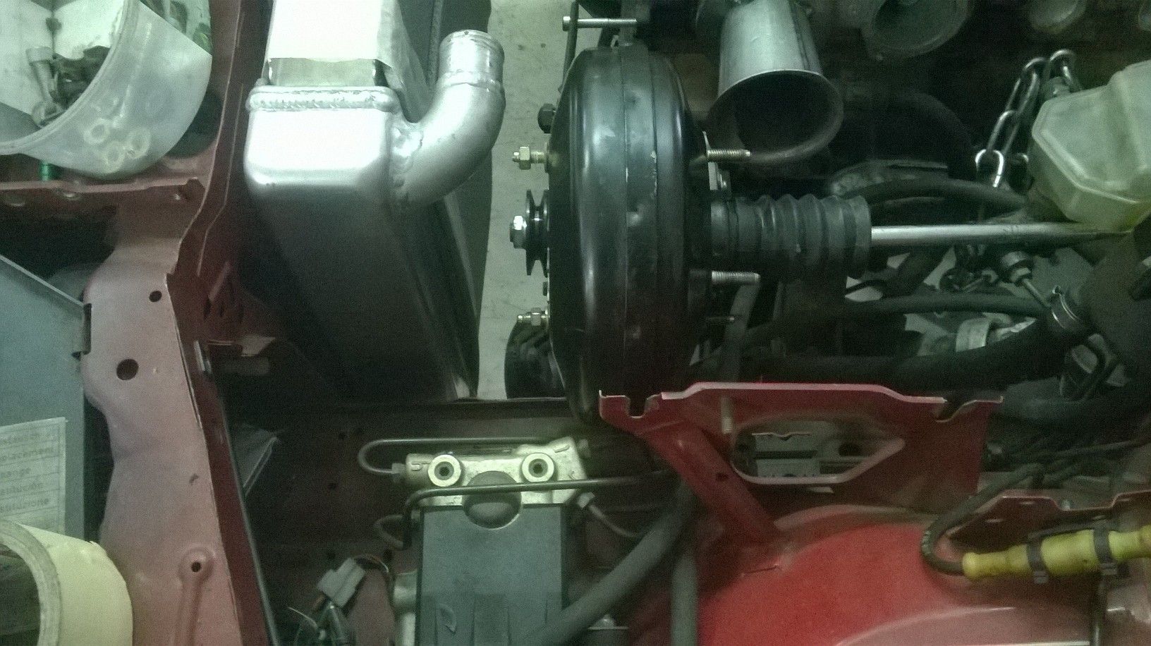

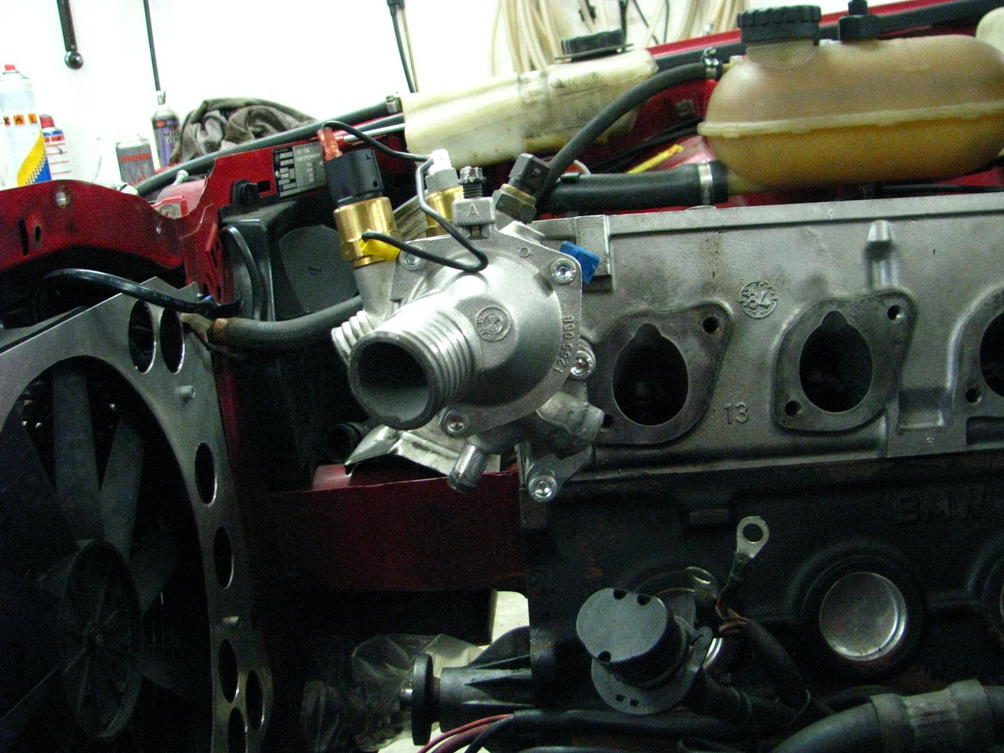

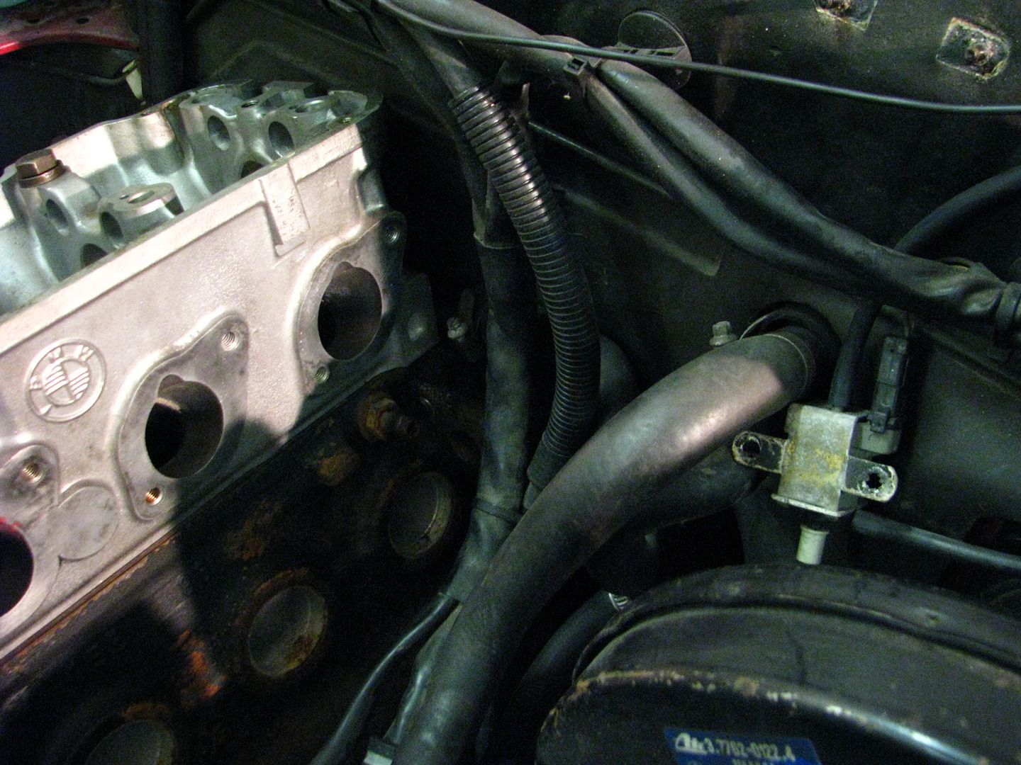

              Lets put the engine back in for solving the fitment.
              heater core hoses :S
              Ford Ka booster time!
              not enough

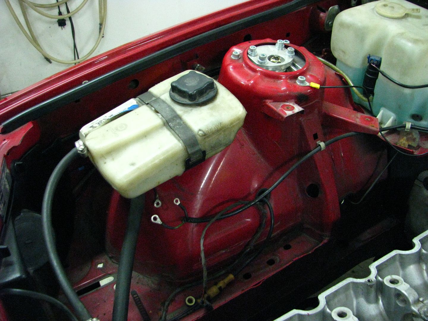

              need to modify this thermostat housing
              volvo expansion chamber on it's place

                  #38

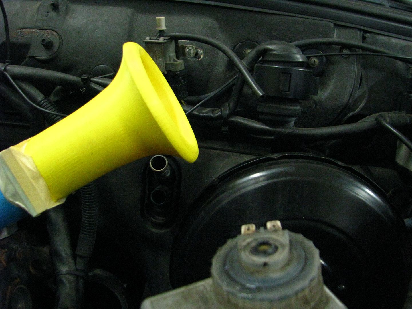

                  Still need a smaller booster.
                  This time suzuki swift
                  Also found on Facebook - Juuso Tero, Tampere

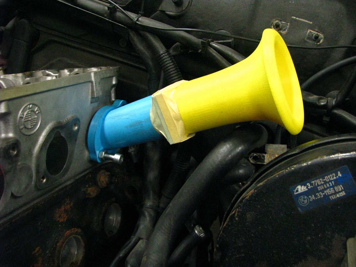

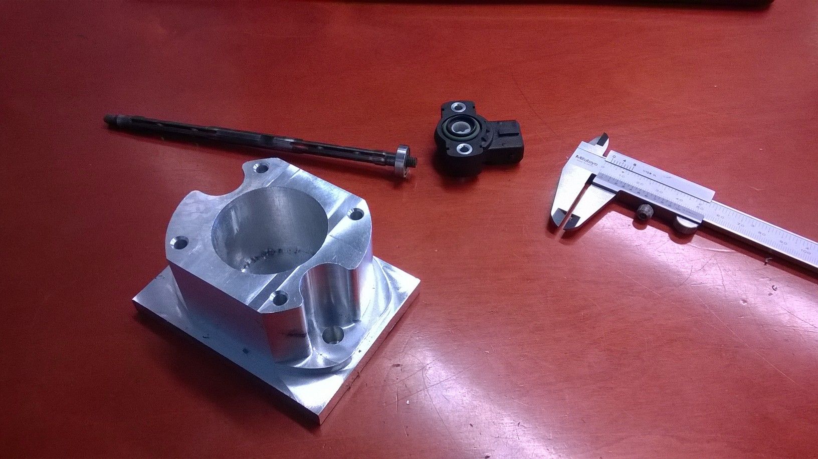

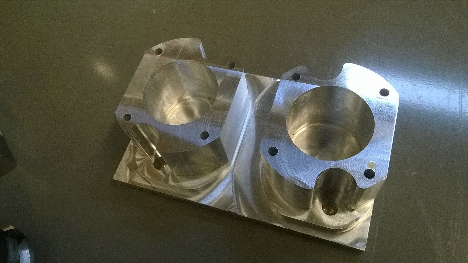

                        So finally got time to play with the e30 thanks to rainy weather, cant work outside.. So the stock intake manifold will be modified to do the job for the itb's.
                        flange being straighten up.
