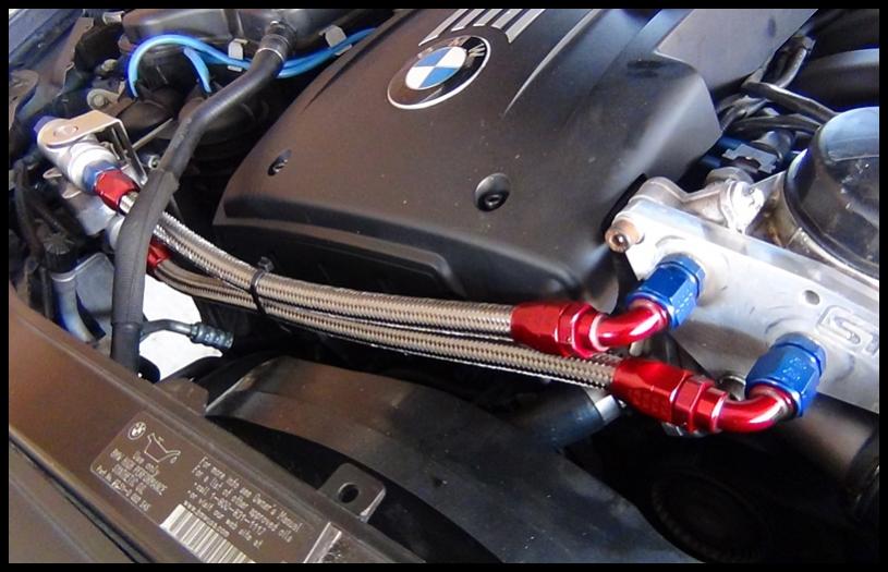

                    Put in my order for Arc Asylums S54 subframe Modification, Ill be sending out my subframe which already has the garagistic weld in reinforcements, she be a nice rig!
                    To give me more room up front I'll be going with an n54 oil thermostat delete plate, this will allow me to use a lower temperature oil thermostat, which is a good idea with the N5X Platform.

                                Regarding the fuel tank, if you meant pressurized, then no sir. Fortunately the 335i uses a Low pressure fuel pump (lpfp) that has similar flow rates to a walbro 255, which then feeds into the High pressure fuel pump (hpfp)
                                The lpfp is located in the fuel tank like e30s, the hpfp is on the engine.
                                The fuel tank from a 335i resembles that of a late model e30 fuel tank as well, with the fuel level sender being on one side, and the fuel pump on the other side.
                                What I am doing is incorporating a 1 liter surge tank from 034motorsports.
                                Since on the early models they use an in tank pump, that then goes to an external pump, then to the engine, I'll simply relocate the external one to a different location using the surge tank and a pump that is e85 friendly.
                                Essentially, the intank pump feeds into the surge tank, while the pump inside the surge tank feeds the hpfp.
