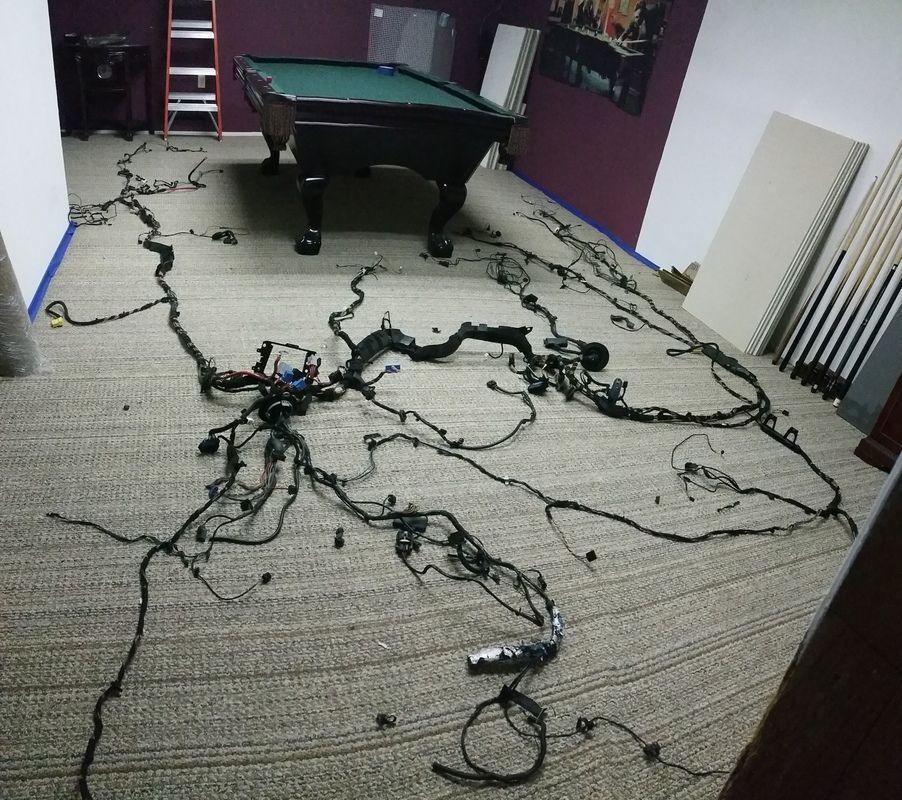

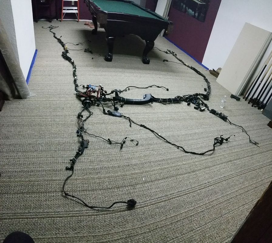

        Another small peek here...
        I'll make sense of this tomorrow with modules and most everything needed for start,
        but this is the body harness of a 2008 335i, this harness is what will be swapped into the E30.
        So far so good, next step is getting the gas tank mounted in the correct position,
        subframes should fly up quickly and we can start looking at engine bay fitment.
        Before:
        After:

          I did that same thing with the harness on my truck... What a nightmare! How many hours do you suppose that took?
            It was my second time going through a 335i body harness, this took me about an hour and change. Today ill add modules, and hopefully get a better description of whats going on.

              #81

                #82
                It only went that fast because I knew what I was looking for, my first attempt was around 8 hours, but I also chopped the complete harness down to the essentials for modules, and start up.
                This harness with have eventual goals to utilize some features, for an example, keeping the ABS modules, and sensor leads intact for a future project.
