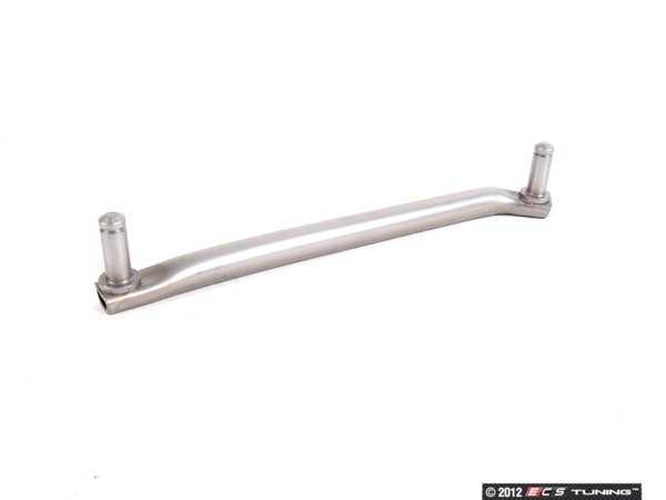

                      I looked everywhere and couldn't find a write up with the E30 M60 Swap 6 speed WITH the Z3 short shifter, after I ran into the problem of my selector rod hitting my guibo.
                      The shortened selector rod from the E30 is too much of an angle and hit the guibo.
                      Here you can see how much of an angle the selector rod is at.
                      I was thinking how i can modify the rod, maybe put a bend in it, to possibly get around it. Or go back to the stock shifter. Spent a whole night trying to find any info I could about using the Z3 short shifter with the M60 6-speed swap. But came up empty handed.
                      Started going through different 3 series vehicles that had the same Getrag type shifter assembly and came across this beauty.. Selector rod from an E36 318ti...
                      Looks like exactly what i need! but does it fit? ill take the chance.
                      sorry i dont have much pictures of it out of the car, but after shortening it and putting everything on the car.. Wala!
                      Clears perfectly! plenty of room! Made my day!
                      Here is a link to the selector rod: P/N 25111222203 :
                      https://www.ecstuning.com/b-genuine-...d/25111222203/
                      So is it possible to use the Z3 Short shifter with a M60 Getrag 420G 6-speed? YES with the Selector rod from a E36 318ti.
