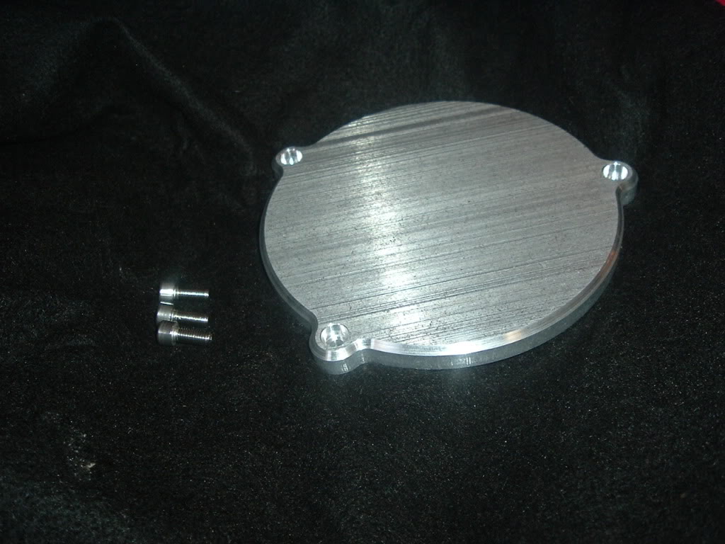

                          You should run a dizzy cap delete! They are super easy to make

                            I plan to, once it's running reliably I'll move on to the cosmetic stuff.
