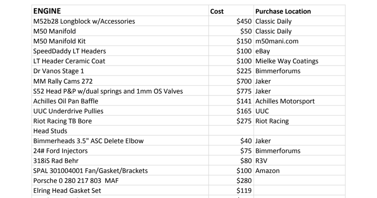

                                Also, just hit the wonderful $15K milestone with this build. Here's spreadsheet so you can all laugh at me:
                                2016 me should've stuck with an M20.
