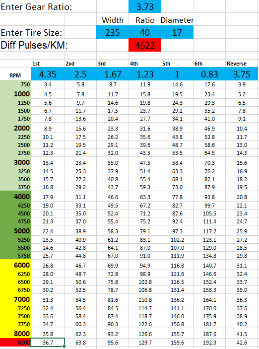

      You probably mentioned it somewhere but what diff ratio are you running?
        What is your gearing again? I lowered mine to 3.46 and I still think its useless lol!

                Running a 3.73 with ~40% lockup.
                I had my dailies on which are 215/40/17 Sumimoto HZ2s. My Track and Show tires are 235/40/17. I believe I am running 3* all around or a little more, I need another alignment to verify. It tracks straight, but the steering wheel is pointed left a touch, not enough that realigning the steering wheel will fix it.
                I chose this gearing as it should be great for autoX, its intended purpose, yet also pretty damn good on track, and the highway 6th gear cruising is perfect. At fontana with the S52 I was 140mph in the Roval and the back end was light. Yay boxy aero!
