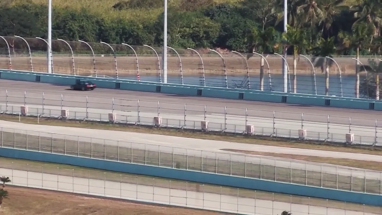

                              Not much new to report but I will post a full update soon. I did set the lap record for my class (NASA TT5) at Homestead earlier this year, and then at Sebring last month I set the TT5 record there too, and then the following lap I "ran out of talent" and backed the car into a tire wall. Thankfully it's just cosmetic damage. I ran the rest of the weekend and the car is fine, just a bit banged up and worse for wear. I'll be getting it fixed some time this year, in the mean time I just pounded it out and am going to do another event at Sebring this week before our upcoming move to Charlotte, NC some time in May.
                              My car aligned with -2.4* camber and 1/8" overall rear toe in on the regular height rear subframe bushings. I was very happy with those number. In a perfect world, I would still want a little bit more rear camber, though.
                              RISING EDGE
                              • Digitalwave
                                is a poseur
                                • 6299
                                #315
                                Check it out! NASA was covering the event in Homestead in January, and they caught my TT5 record setting lap of 1:43.5 on Saturday. I went even faster on Sunday, doing a 1.41.8, which was a record by almost 4 seconds over the previous.
