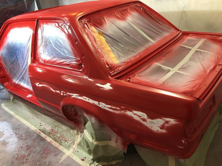

        So this weekend I made a fair bit of progress but per usual it was a tale of "good news, bad news."
        Some good news:
        Started the car and moved it out of the garage for the first time in a awhile:
        And put my newly purchased cover on it to protect the dash, almost looks like I have a finished car under there
        I then proceeded to give my makeshift paint booth a thorough scrubbing, it was covered in 2-3 months worth of sanding dust.
        Some more good news:
        I upgraded my ventilation system a bit to lessen the amount of dust nibs I was getting. Previously, I just had a "naked" fan pointed out of a hole in the plastic sheeting. Even with the fans on lowest speed, the turbulence they created kicked up a ton of dust and debris that I had no way of preventing from entering the "booth." I ended up fabbing up some fan shrouds to tape into the sheeting for a better seal:
        And then used some HVAC filters on the inside:
        This effectively "seals" the booth from outside debris as best as I can achieve, while allowing me to run the fans at their highest setting for better airflow out of the booth without the risk of kicking up a bunch of dust. It definitely cleared the overspray out WAY better and my finishes were definitely cleaner.
        I then got the car all masked off Saturday evening:
        MORE good news:
        I started spraying some sealer on Sunday morning with the intent of getting the whole unibody done:
        Ok time for some bad news. I ran out of sealer about 85% of the way there, and the paint shop I use is closed on Sundays. Good news, I had 16 hours to get more sealer and finish spraying before the sealer cured and I had to resand.
        So I picked up more sealer first thing Monday morning and knocked out the last of the car, only the driver rear quarter was still in primer but I ended up going over the rest of what I had already done anyway:

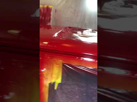

        Then I moved on to spraying some color, more bad news. I ended up getting a fairly long run in the rear quarter panel. I waited for the paint to harden enough to wetsand it down, but by then it was too late in the day to finish the job:
        So here's where it will sit until next weekend. I'll need to scuff the layer of base already on the car, blend in the areas I had to sand down, and reshoot another coat or two of base before clear.
        Last, I like to end on a good note so here's some "good" news:
        If you're spraying correctly, it's really hard to get runs in your base as you're not really supposed to be laying it on too thick. When I saw the run, I checked my gun settings out and realize that I was spraying at WAY too high a PSI. As a result I was getting a really dry spray and so had to bring the gun way closer to the panel to cover, and being so close is ultimately what I think caused the run.
        The gun calls for a max PSI of 23 at the gun regulator and I was spraying it bascically at 23 PSI. There's a YouTube channel I follow from Australia (The Gunman) that does painting tutorials and paint gun reviews, and he has a bunch of reviews of the exact gun I'm using, DeVilbiss FinishLine FLG670. In his videos, he's running his basecoat at 10-12 PSI in warm weather and 15-18PSI for clear. Obviously in colder weather you'll have to increase the PSI due to the relationship between gas temperature and pressure (Ideal Gas Law, general chemistry anyone??) but its been in the 80's here in NC. I ended up messing around and sprayed some test spots with the new, lower settings and WOW what a difference.
        I only ended up doing the one coat of base before I noticed the run and stopped. After a scuff and another coat or so it should cover pretty well so I don't think I'll have wasted much paint. And, I think I'll end up with a much better finish with the improved gun settings so maybe this was all a blessing in disguise. Stay tuned...

                  So I got home early from work on Friday and got the whole car wet sanded back down in 600 grit so I could blend the sealer back in, and re-masked the whole car to avoid any of the old dry paint from flaking into the new:
                  Saturday morning, I set out to blend in the sealer, recoat the base, and get this pile in clear:
                  Then I dropped a few fast, dry coats of base over the newly sealed areas to cover/blend, followed by another full base coat layer to finish up:
                  Can't even tell the run was there:
                  Then moved on to clear, with the lighting at that time of day it was hard to get great photos but you get the gist:
                  Here's a quick walkaound, does it a little more justice:
                  This was the most technically challenging part of the whole repaint, and it came out great! I was equally relieved and excited, I only found one small, shallow run in the clearcoat on the windshield cowl which won't be too hard to sand down and buff out:
                  There's a bit of orange peel and the expected dust nibs here and there for sure, but a cut/buff is in the plans anyway and will take care of all that. I am beyond ecstatic!
