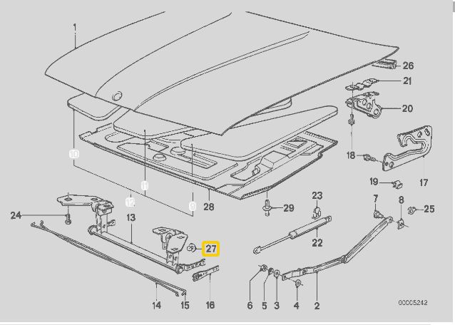

      Love these updates and I would hardly call this insignificant because these great little details are needed to make a comprehensive restoration.
      Since we are talking details, there are rubber stoppers that fit into the upper hole on the back of the lower hood hinge. They simply prevent "metal to metal" contact at the back of the hinge pivot when the hood is fully open....usually crumbled away on most cars at this age but I thought to share in case you were interested - pn 51 23 1 916 567
