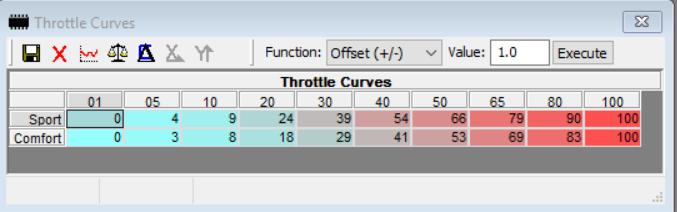

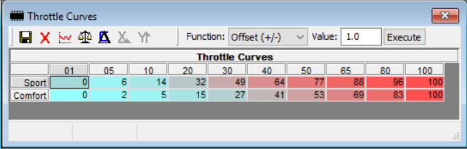

                  Even in the heavier E46 chassis, M3 owners report stock sport mode throttle maps to be much too aggressive.
                  I modified mine to be much softer but better tip in for non-sport as seen here, there is more to it than just throttle curves, there are also different driver demand maps and vanos tables I do believe.

                  • R3Z3N
                    • Jan 2011
                    • 3056
                    #114
                    And how they are stock:

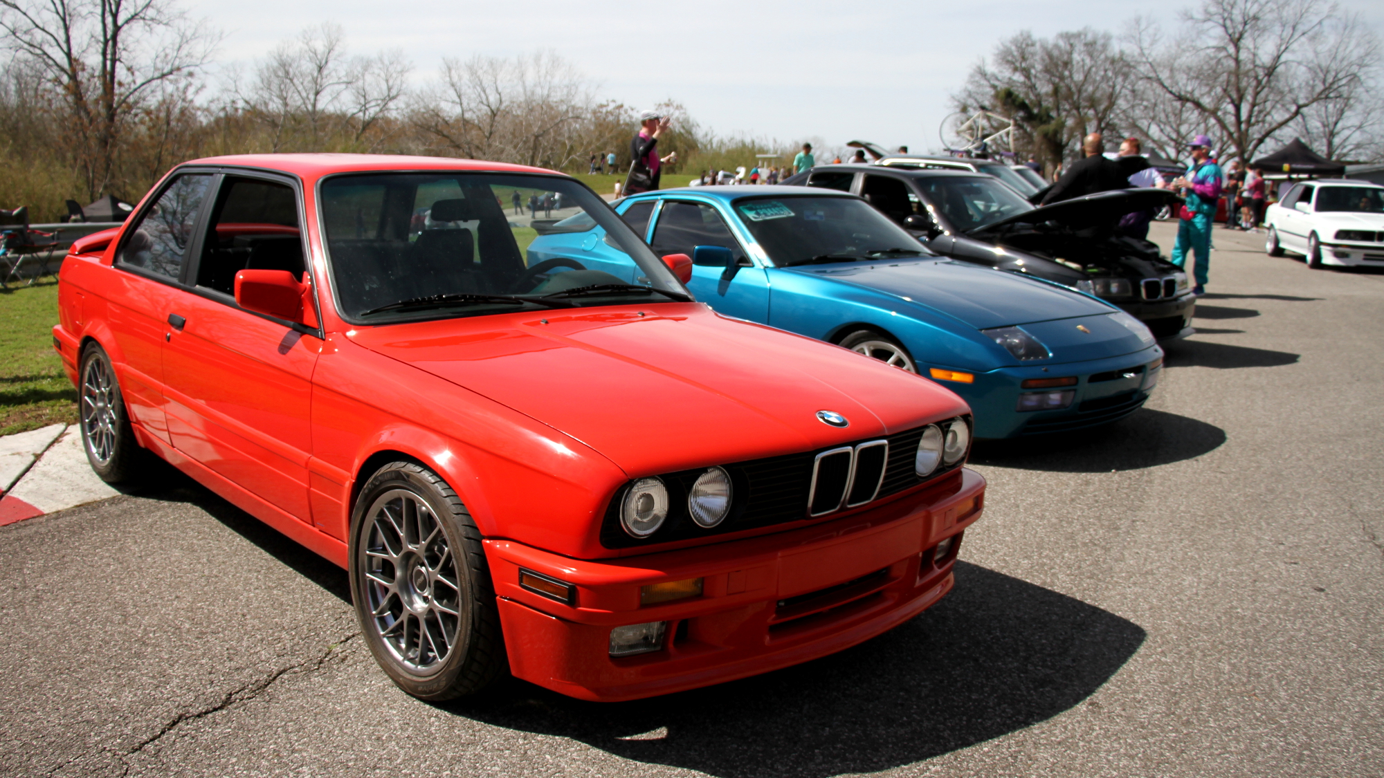

                                Working on some of the details.
                                Race German phone mount
                                BMW centercaps
                                Build Thread: Ryan's Hennarot 318is
