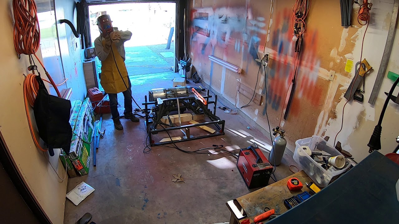

          I'm documenting it much more detail and I'll definitely post a build thread as soon as I get over the first major hump. I'm toying around with timelapse video on the gopro. Wish I would have done this for may paint job.... Also, you can see that I got my little helper a welding mask so he can be in there with me.
