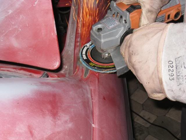

        I had a really busy day, but managed to get a little work done. I started to remove the rust in the trunk near the gasket
        Pic of rust
        Mark off areas to cut
        And cut away
        Removed
        Cleaning out more rust
        Instead of welding I chose to use fiber glass to repair this. It is more of a learning thing for me as I have never really used fiber glass
        Kind of how it will look
        Apply the resin
        Then apply the sheet with resin on it
        Now I am waiting for it to dry. I will fill the outside of the hole with fiberglass bondo stuff, then weld in a new steel lip for the trunk molding to go on. Tomorow I will buy some of the acid to put of rust from the paint shop. The next update should have a lot more work done and more info.

            #185
            Fiberglass for the trunk lip isnt really a good idea. because you will be slamming the runk all the time and it will break more then likely.
            Fiberglass doesnt stick well to metal either.
            When you go to weld a lip back on there the fiberglass will get hot and peel away from the metal.
            I have a few fiberglass threads if your interested in looking at them.
            keep hard at it though. good job so far.

                  #188
                  Thank you. I am gonna go back and remove the fiberglass and weld in a plate there. I prob wont look nice because it is a tight area and I suck at welding, lol. But you dont see that area so I guess it is better to do it the right way. I looked for your fiberglass threads but couldnt find them?
                  Before I start it, I have rust on the roof of the car on both edges by the sunroof, right where the drains are. That also seems like a very tight and oddly shaped spot. Would it be fine for me to remove the rust, then use fiberglass to reshape the spot, then put a tad bit of filler over it?

                        #191
                        I would clean the rust out the best you can and spray a sealer on it then fill it in with a fiberglass bondo instead of a matt or just bondo.
                        then use bondo over that.
                        I wouldnt weld there unless you going to take down the headliner.

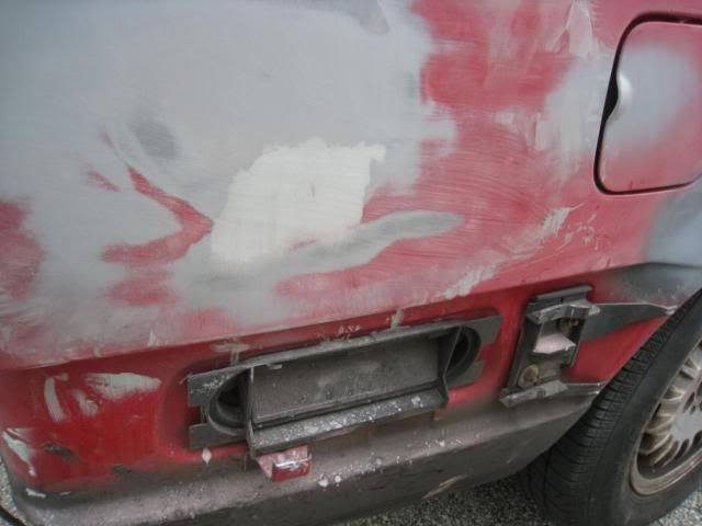

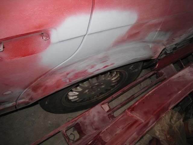

                          Today I made a little more progress. I started to mold in the antenna and i found a few low spots on my filler so I went over them.
                          After today all I should have left are to fix the rust on the roof, and the rear section, and fix the filler i laid today
                          Wetsanding
                          I found a low spot on the door
                          It was hard to capture
                          I banged it in to add filler
                          Did the hood
                          You can find the low spots from the dark colored areas
                          Here
                          and here
                          this seemed good
                          another low spot
                          I have to smooth out this area
                          I laid the filler
                          I smoothed out this area
                          And began this one

                            #193
                            Thank you so much. That makes it a lot easier than to weld in that area. I have some fiberglass bondo so ill be doing that tomorow.
