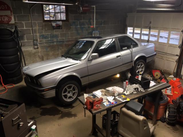

                              Finally got her to move under her own power.....
                              22 likes, 1 comments - Kareem (@fucatypr) on Instagram: "Time for suspension, lol #makecoolshiteveryday #e30_world #e30owners #s2000 #hondapower #haltech ..."
                              now it's time for suspension
