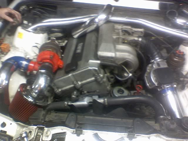

          So, a little update: everything is bolted in.
          Just need to run oil and coolant lines tomorrow as well as work out a down pipe and she'll be up and running.
          I have to say thanks a bunch to E30Nate, his brother Dan and Tim (wtfgerman)
          I couldn't have done anything without them.

              Looking good Danny! Are you going to be using a piggy-back for fueling or RRFPR?
              Let us know how the manifold holds up as i will be using the same one on my e36 m44.

                #187
                Just the RRFPR.
                Oh, I forgot, I need to put that in tomorrow too.

                    That looks pretty! Any intercooler shot?
                    • Danny
                      • 14217
                      #190
                      No, but I'll take some tomorrow!

                        Have you decided where to tap for the oil feed lines for the turbo?
                        I was going to tap the oil filter housing.
