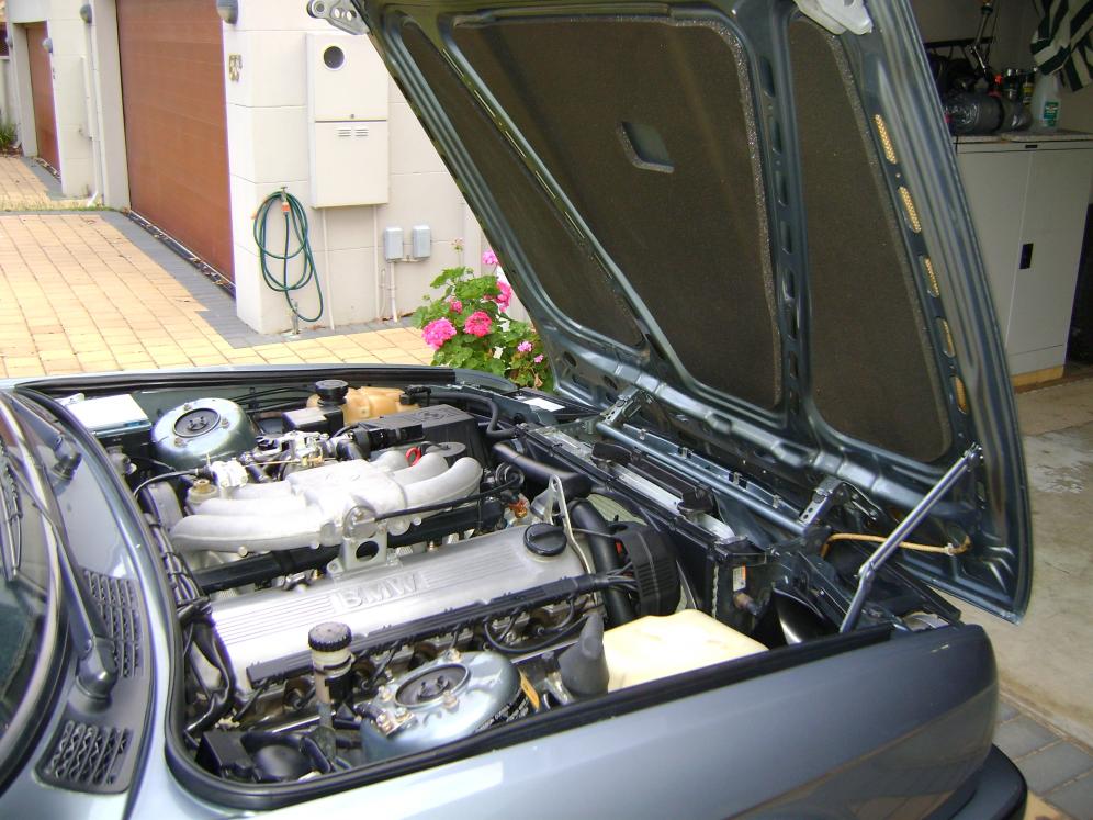

        Originally posted by Japandrew73
        Also got the underhood foam. This will remain un-opened until the very end of the swap. I found it strange that when I ordered it, it has this square cut out in the middle. Why is that? The one I had on my car didn't have the square? Is that where the intake manifold is on the M20 or something and it's making space?
        Some late models came with an optional underhood light that mounted there.

          #799
          similar foam to the one you ordered with the cut out.
          but no light :hitler:

            #800
            I guess you have to put some rare, euro spec light into that hole. (Make sure to find the red one) ;)

              #801
              Are you sure about this? I've never seen one mounted there, and it isn't shown in the ETK.

                #802
                And the search for the reason why a gap is there begins!

                  #803
                  additional clearance for the vacuum line onto the intake mani?

                    #804
                    Got the reason on e30tech
                    Originally posted by e30tech
                    The hole in the hood foam is for where the throttle linkages are on the m20.
                    This sounds the most logical to me.

                          #807
                          close enough. what do i win?!!!??
