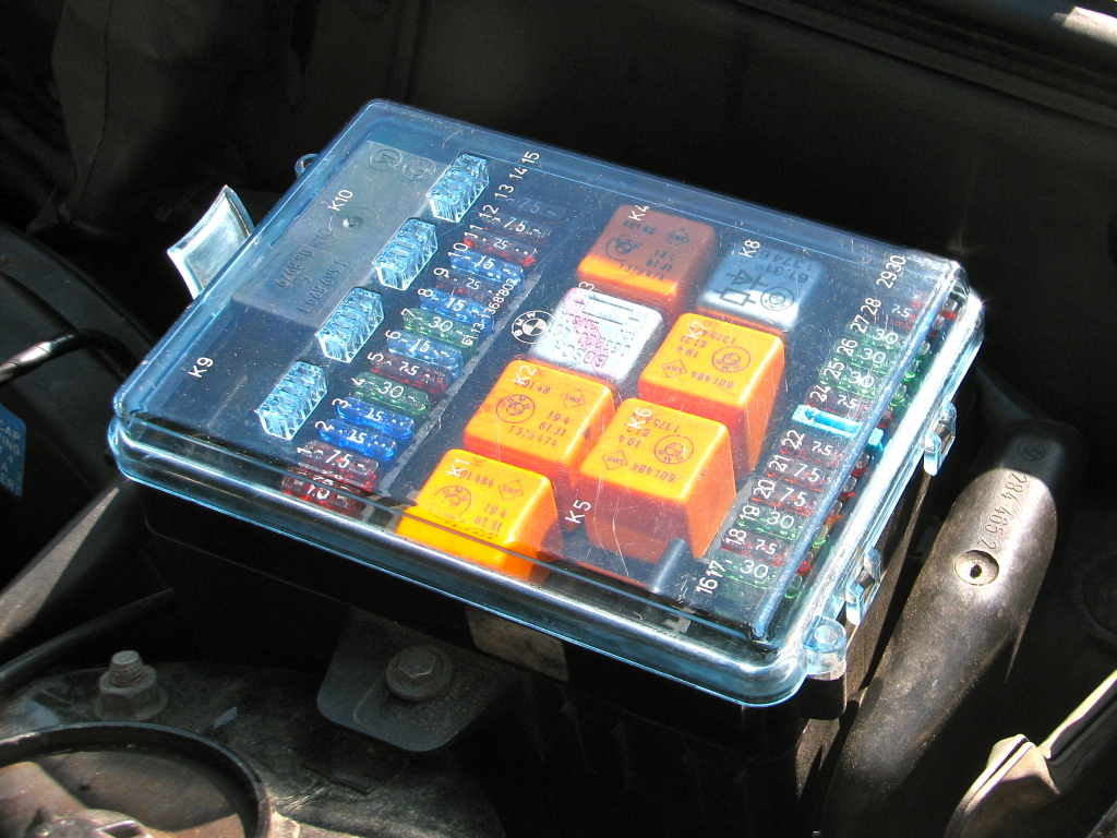

    i saw there was a difference in the relays, which ones are correct, or do they both function the same
    • Japandrew73
      • 2164
      #902
      Also have noticed this about the relays. Not going to worry about it for a while but in a week or so i'll do the research. The reason relays get tricky, is in the ETK it just comes up as "Relay". Not describing it very well with part numbers. I'll no doubt have the answers and either clean the existing ones up or get new ones. I know for a fact mine are OEM. You can see the BMW Roundels on the case of them. Some relays (like the fuel injection relay) aren't supposed to have a roundel on them because they are made by Bosch.

        The blue and yellow ones are the newer relays, most e32/e34/e36 cars have those. The silver ones are the old/original ones. I replaced all but 1 or 2 (5 pin) with the newer relays to not have any issues with the old ones.

          Yea In my opinion "authenticity" doesn't matter if It's going to look like shit and can't be replaced by a nicer silver one. I know what I'll end up going with, thanks for the info jean.
          A 4-prong relay is a 4-prong relay right? Only difference in relays is the number of prongs. Plus a good hint is all orange relays in my fusebox have the same part numbers on them.

            I was asking cuz I have the orange ones in my car and the blueish ones in my glovebox

              Not always. Sometimes the pin orientation is different for coil and load sides, mix them up and it won't work and may cause damage to other systems.
              Also, the original relays had resistors and some had diodes on the coil side for for noise suppresion(resistors) and to block back feeding of power from other circuits.(diode)
