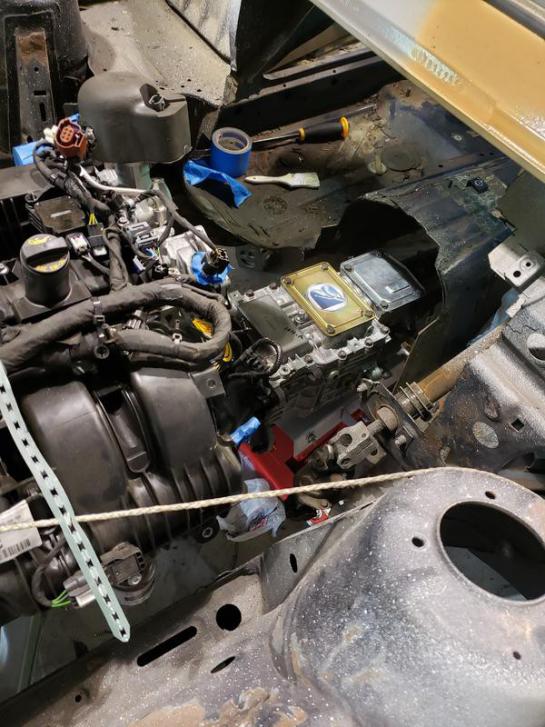

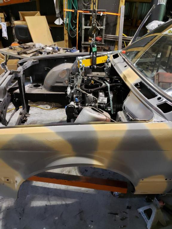

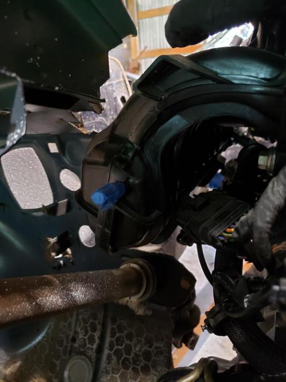

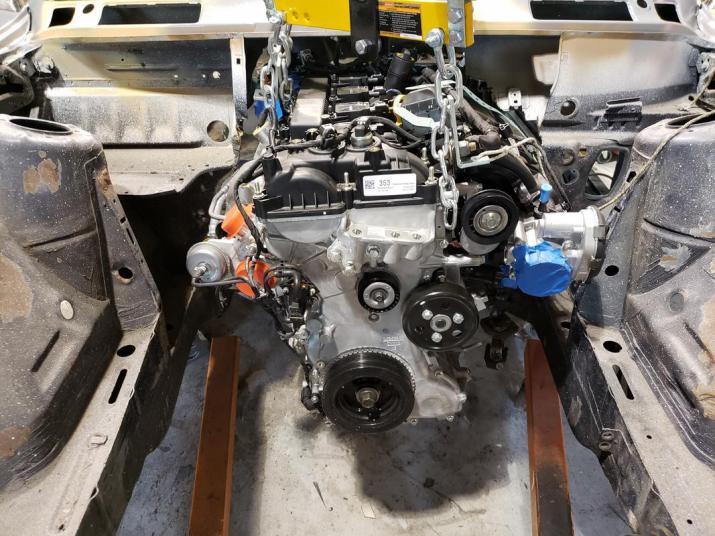

    im 95% about this position of the powertrain, the oil fil cap has barely an inch of space between it and the end of the engine bay. the intake manifold is almost touching the steering column ffs. everything looks fantastic. the subframe almost bolts up but I think a subframe spacer is in order. the stock oil pan has good clearance I think things are really starting to come together good
    Click image for larger version  Name:	20190829_231255.jpg Views:	0 Size:	82.3 KB ID:	9865719
    more pics and updates to come, everything's going really well so far. soon I will be welding custom motor mounts and driveshaft and then moving onto fueling and electrical.

      I would also like to point out that one thing that im expecting to be great about this build is to resolve the front heavy weight distribution of the e30. by not only having a lighter and much more powerful motor than the m20 but also having that weight moved back to center very far im hoping to get 45/55 weight distribution. the ecoboost is going to be so far back that you could almost call it a mid engine car. 90% of the motor will be behind the centerline of the front wheels. only the pully's and the very front of the motor will be in front of/ in line with the front wheels.

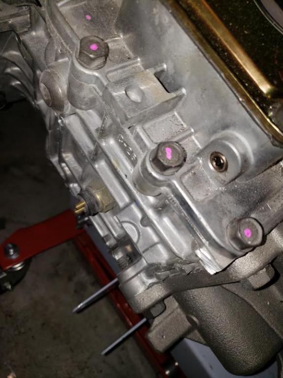

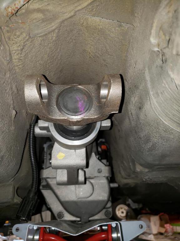

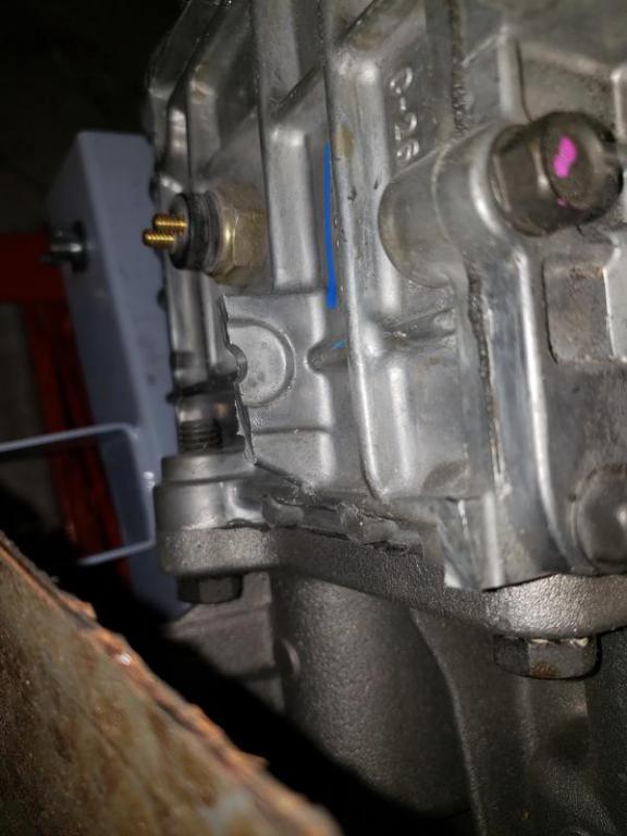

                I decide to cut some tabs/brackets off the tranny to get more clearance in the tunnel
                after test fitting I decide to cut even more of the tranny

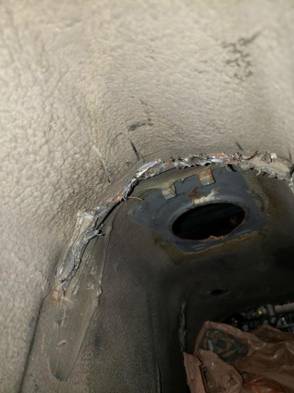

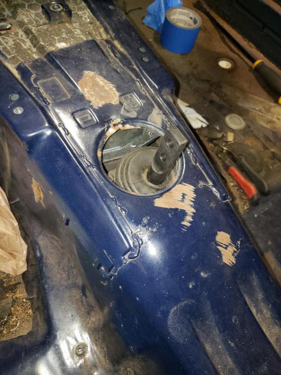

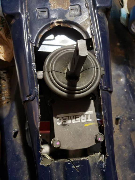

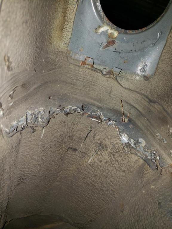

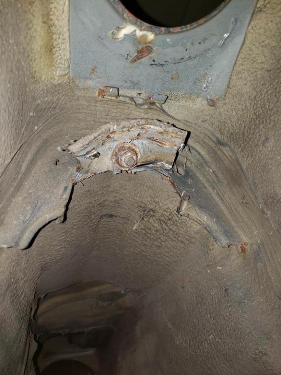

                  I need to cut the tunnel where the shifter goes because the shifter will be a few inches back from the stock location
                  I decide to cut even farther back so as to remove that bracket entirely
                  coming together good

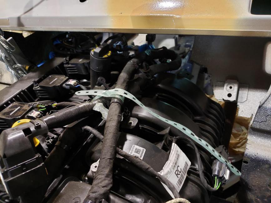

                    the location of the powertrain is dialed in even more and is almost final however I have a few more adjustments I want to make.
                    the starter motor and the oil filter clear the remaining firewall nice but tight

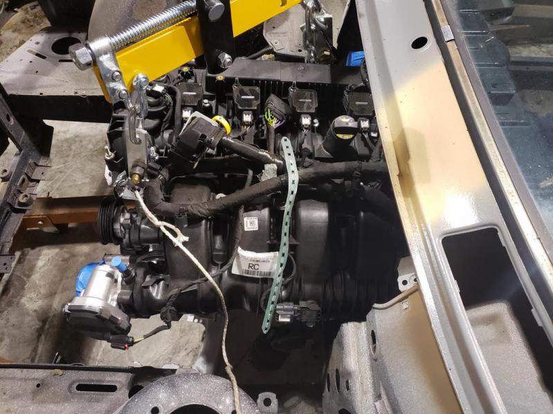

                    the intake manifold tucks into the cabin very nicely

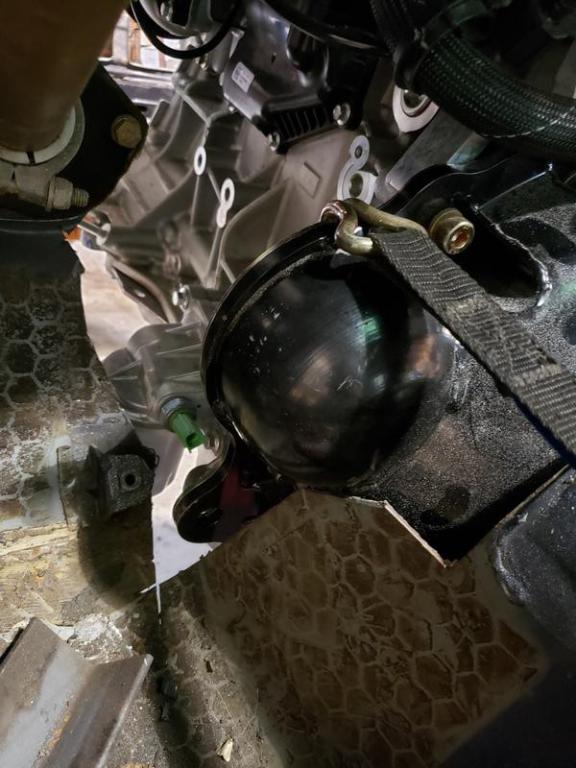

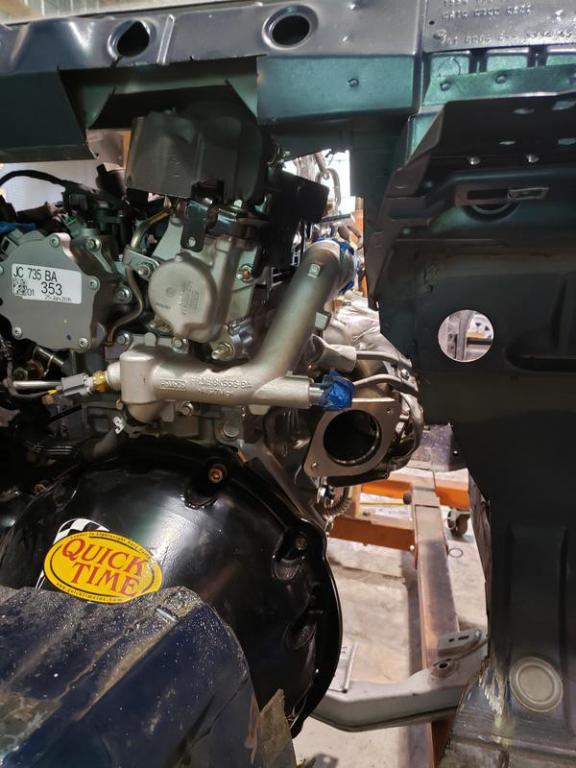

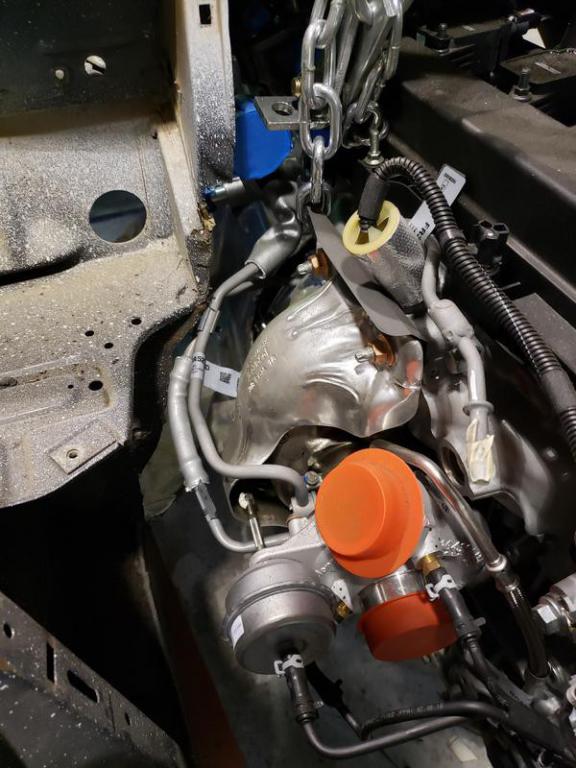

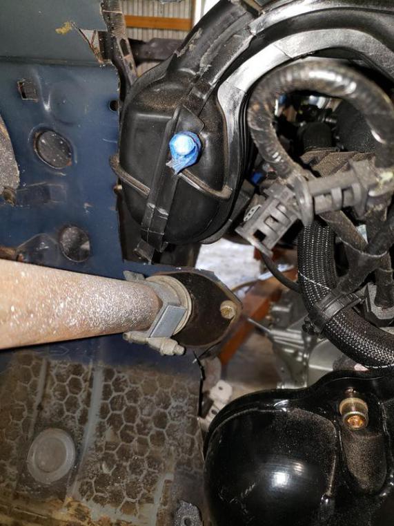

                    as planned the high pressure fuel pump tucks under the windshield real good and I have cut room for the downpipe

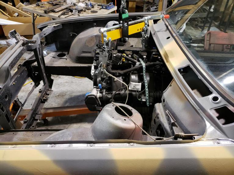

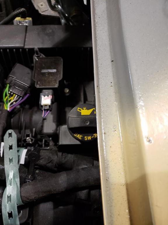

                      ive managed to move the motor even farther back than before and now the oil filler cap barely pokes out from the end of the engine bay. this is right where I want the motor to be
                      another pic
                      like I said earlier one of the things about this build is that the motor will be so far back that you could almost call it it a mid engine car now. here is a pic that shows how far back behind the front wheels the engine is gonna sit

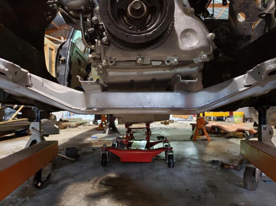

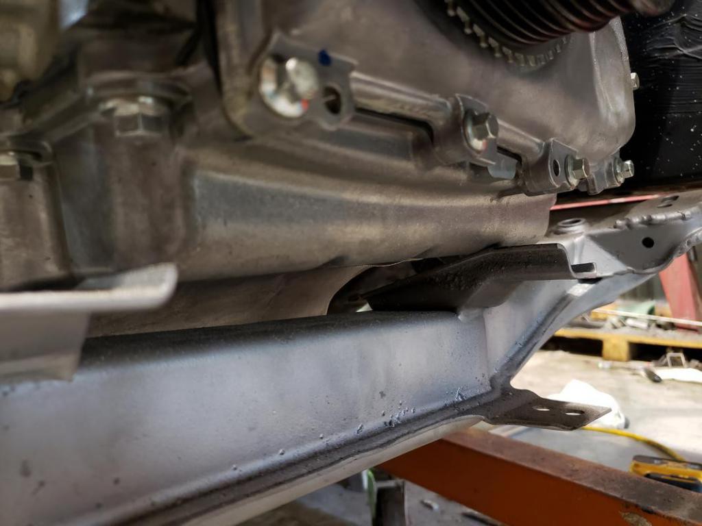

                          here are some pics of the subframe fitment right now and oil pan clearance. like I was thinking I believe that a subframe spacer is a good idea
                          if I grinded the top of these steering rack brackets off I think the subframe would clear but I think I will do a spacer over that anyways to avoid that since the subframe would be a bit higher than the oil pan if I didn't

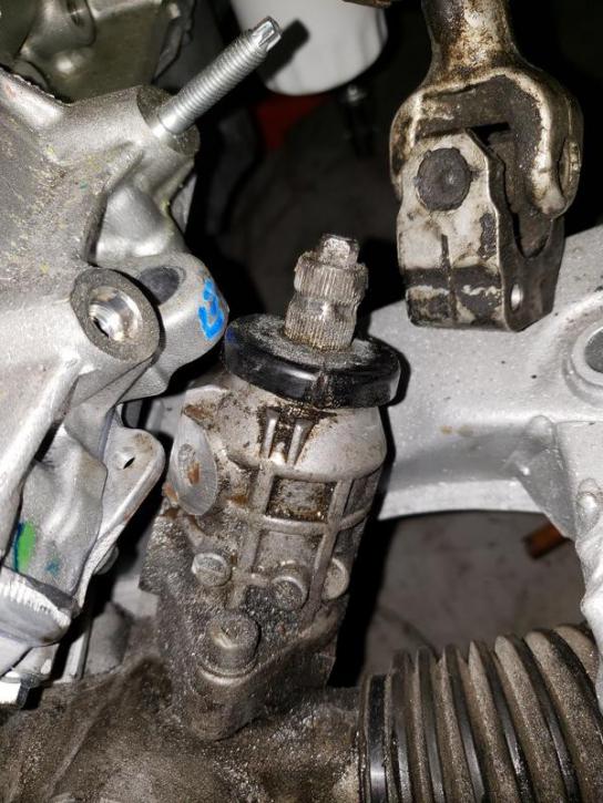

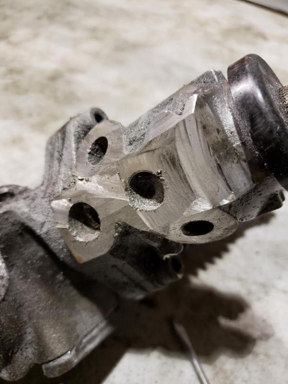

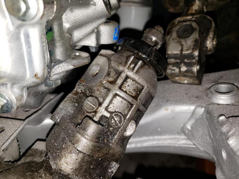

                            test fit the steering rack tonight and at this point Im starting to think I should consider changing the cars name from "the ecobeamer" to "the angle grinder victim"

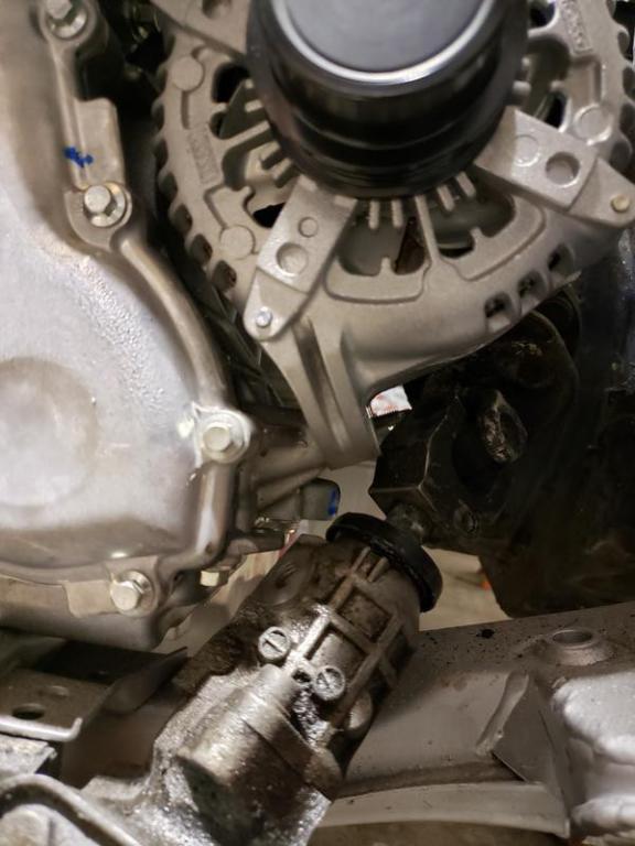

                            • hkv
                              • Jul 2019
                              • 274
                              fits up pretty good even with the alternator in place. I don't think im going to need a subframe spacer anymore if I cut the the top ridges off the steering rack mounting tabs.

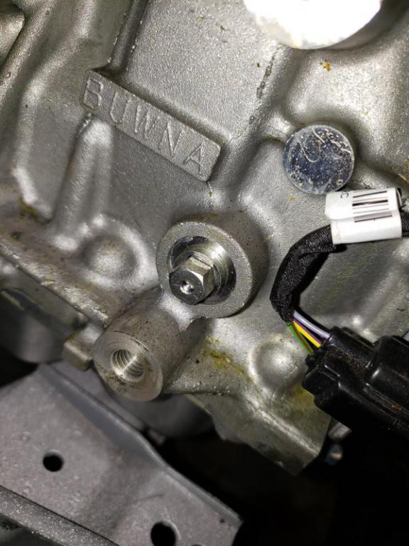

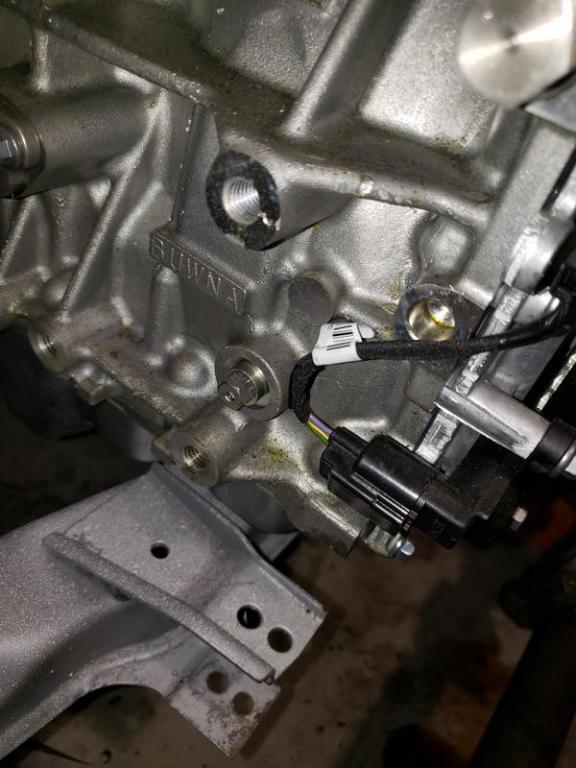

                              anybody else willing to bet this would be the place to mount an oil pressure sender? with the oil pan likely going to be the low point of the car(about two inches below the subframe) I think I may need it lol
                              Click image for larger version  Name:	20190831-032015.jpg Views:	0 Size:	68.8 KB ID:	9866037
                              Click image for larger version  Name:	20190831_032024.jpg Views:	0 Size:	60.4 KB ID:	9866038
