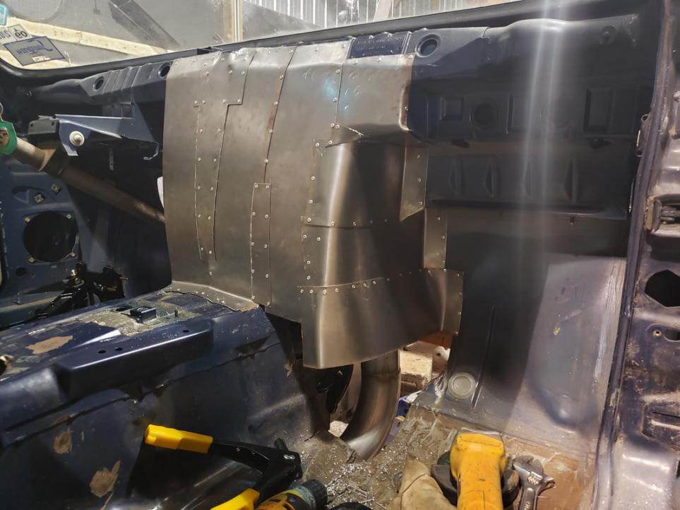

      did some work on the firewall. I said the downpipe was fun and easy, this is less so. more challenging but still fun. using tin snips to cut decently thick steel and then trying to get it to fit good. this section was easiest part and the passenger side wont be too bad but the drivers side will definitely be a challenge. but im really digging this look and I think it will turn out cool. pretty damn sturdy too. I got the idea to paint the cabin side with clearcoat and then sticker bomb it which will be cool af, I got tons of motorsports stickers saved up. the other side I will paint the same color I paint the engine bay which wont be camo.

          coming along good on the passenger side. as ive added more panels its become super sturdy.
          Click image for larger version  Name:	20190905-230052.jpg Views:	0 Size:	81.6 KB ID:	9867626
          Click image for larger version  Name:	20190905-232717.jpg Views:	0 Size:	80.9 KB ID:	9867625

                        passenger side is pretty much finished up, I really dig the look of this riveted firewall. drivers side is really gonna be a pain though.

                          Nice project! But I would not do the all bodywork with aluminium sheet and rivets. The original wirewall and transmission tunnel is essential part of the body strength.
                          • hkv
                            • Jul 2019
                            • 274
                            #58
                            thanks for the comment. what would you do?
                            the original firewall is 18 gauge(1mm) thick steel. I am using 20 gauge(.80mm) thick steel(not aluminum) that when overlapped from sheet to sheet like im doing is 1.6mm thick(over 50% thicker than stock). there are even some spots where I have riveted 3 sheets together(2.4mm). Rivets are a tried and true fastener that is very suited to handling shear forces. before welding was developed riveting was the way to join metals in most applications. they are still used in allot of applications where high strength and low weight is desired, notably the aircraft industry. The point being I am confident in this firewall, I can tell you from knocking on it and pushing it that it is very strong.

                              what made u use rivets?
                              • hkv
                                • Jul 2019
                                • 274
                                #60
                                well nuts and bolts would have been ridiculous. lol but seriously welding really isnt the best idea when working with thin sheetmetal. rivets are just as strong as welding and to have welded thin sheetmetal like this would have been a major pain, preventing burn through would have been very difficult and the end result would have looked worse.
                                now I understand why people weld in sheetmetal when repairing rusted out sections because that retains a stock look but especially on something as big as a firewall; riveting these panels as opposed to welding is quicker, cheaper, easier, much better looking result and just as effective/strong as welding.
