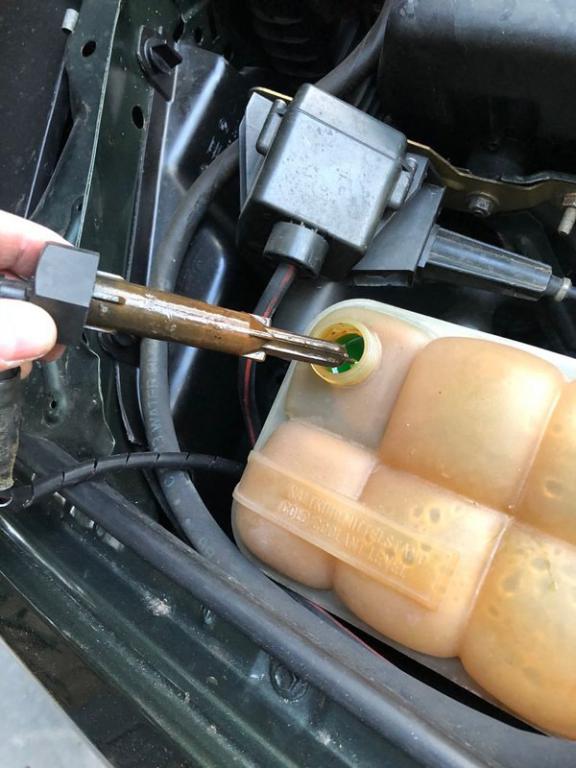

      Well, decided to take the car to work on Friday last week to give it a bit of run.
      It was cold winter's day (7 deg C) so I cranked the heater.
      Hmm, what's that sweet coolant smell.
      As it turn out the heater core is weeping and I have a coolant leak in the heater feed line.
      90% of the hoses are original - so they are due.
      But checked the expansion tank when cold and it was VERY low - almost empty!
      Lucky, but what the?
      Why didn't the coolant level sensor light-up in the check panel?
      Er... I see. No float.

      Apart from the water pump & expansion tank cap everything is original.
      Cooling system refresh is overdue.
      I already have a new expansion tank & have parts coming in from Denmark, USA & Australia:
      - Behr heater core & new heater valve
      - Radiator, heater, throttle body hoses & throttle body gasket
      - Coolant tank level sensor
      - BMW blue coolant
      Going to be a fun few evenings.
