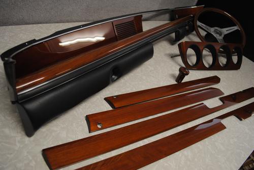

                            Over here in Adelaide there's "Dash Original" who are pretty well respected for their work too. Here's a photo of a 3.0CS dash they did, but they do plenty of old Porsches, Alfas etc:
